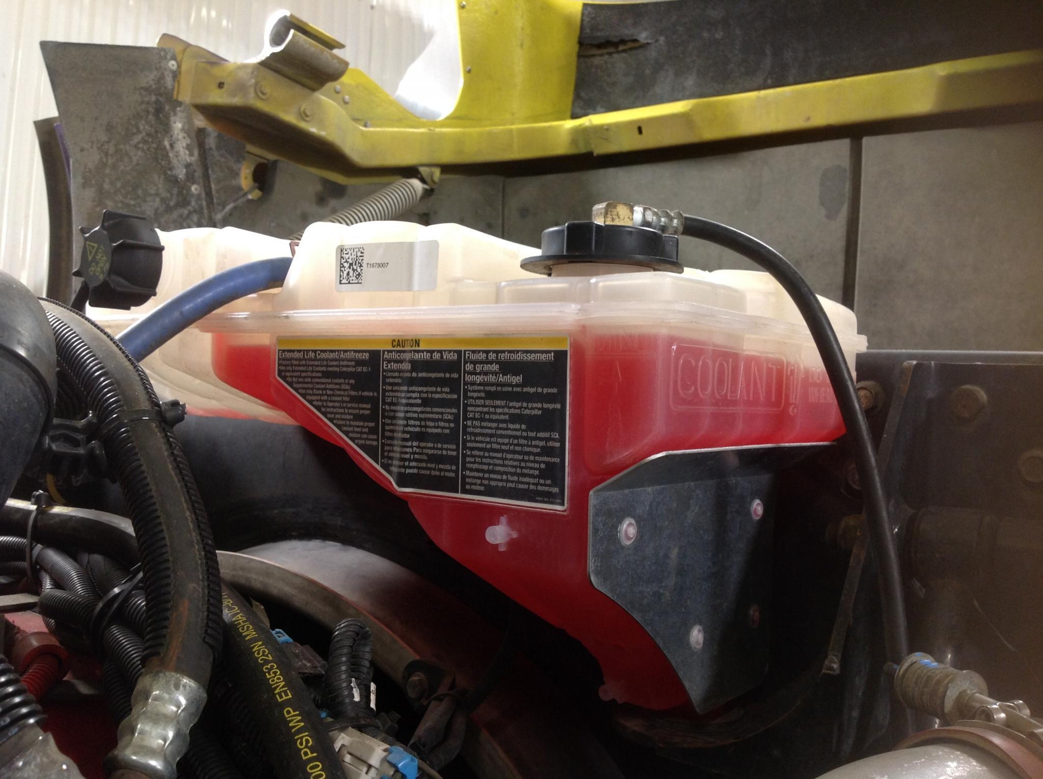

(04-17-2017 )JMBT Wrote:  Does anyone out there know the part number for the Astro adapter or any similar brand adapter that works for pressure testing the Volvo coolant system? I am also looking for the number of the adapter that would work on my brother's 99 W900 KW, with CAT 2WS motor. I like the set that Rawze has but don't need all the adapters it comes with. It looks like you can buy single adapters and the pump separately, but nothing lists what class 8 trucks they work on. Thanks
If that year uses the same surge tank as my '09 (pictured), the Mac Tools adapter part number is RA10032 for cross reference. Snap-On website lists TA84 as "Cooling system adaptor Kenworth", but no photo to verify yet TA32A is what it should be?
My '97 Pete was the atypical standard "B" neck, which is listed below.
Snap-On has a "Truck Cooling System Adapter Set" SVTA6100 that includes below:
Snap-On #'s are (the above kit) Mac Tools after in {}
TA27 {Mac # RA10027} for Volvo w/ 63mm X 3mm threaded filler neck
TA50 {Mac # RA10022}for Volvo w/ 48mm X 3mm male thread on neck
TA54 {Mac # RA10054} Freightliner trucks w/ 60mm X 3mm male thread on filler neck
TA32A {Mac # RA10032} International, 2007 & up KW, Pete
TA4505 {Mac # RA14505} for trucks with "B" size (2-11/16 OD) filler neck Adaptors
TA58 {Mac # RA10058} Sprinter w/ 42mm X 2.5mm thread on filler neck
Mac Truck Kit CSA600 has the above first 5, but instead of the Sprinter one, they have RA10036 for International that has the O-ring that RA10032 doesn't have.
Hope this helps.

Thanks Hammerhead, I will determine which of those two Volvo numbers is mine. My brother's KW has the old style metal top tank, may be closer to your 97 pete. I'll have to do a bit of research on that too. I remembered earlier, he had this current Radiator custom built 6 core for heavy haul, so it may not even be the regular 99 W9 setup.

I was just going to say look for a used Snap On adapter on eBay. Sometimes they have old new stock too for roughly $50 or less. It is just the adapter, but there are plenty of vacuum pumps out there that will work. That is the route I would take. I got the number for the adapter by asking a mechanic up at my local International dealer, he was more than happy to oblige. It was the TA32A just as Hammerhead posted.

(04-17-2017 )JMBT Wrote:  Thanks Hammerhead, I will determine which of those two Volvo numbers is mine. My brother's KW has the old style metal top tank, may be closer to your 97 pete. I'll have to do a bit of research on that too. I remembered earlier, he had this current Radiator custom built 6 core for heavy haul, so it may not even be the regular 99 W9 setup.
Yeah, I figured it would be that one. I was pretty sure it was when the DPF was introduced that Paccar went to the plastic surge tank.
Any truck without a plastic surge tank from that time frame used the "B" neck. Pretty standard.
