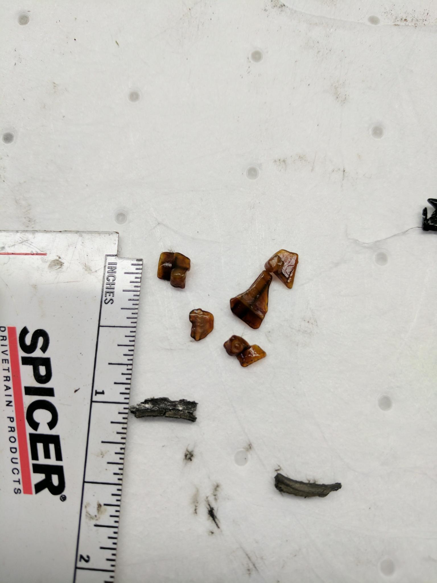

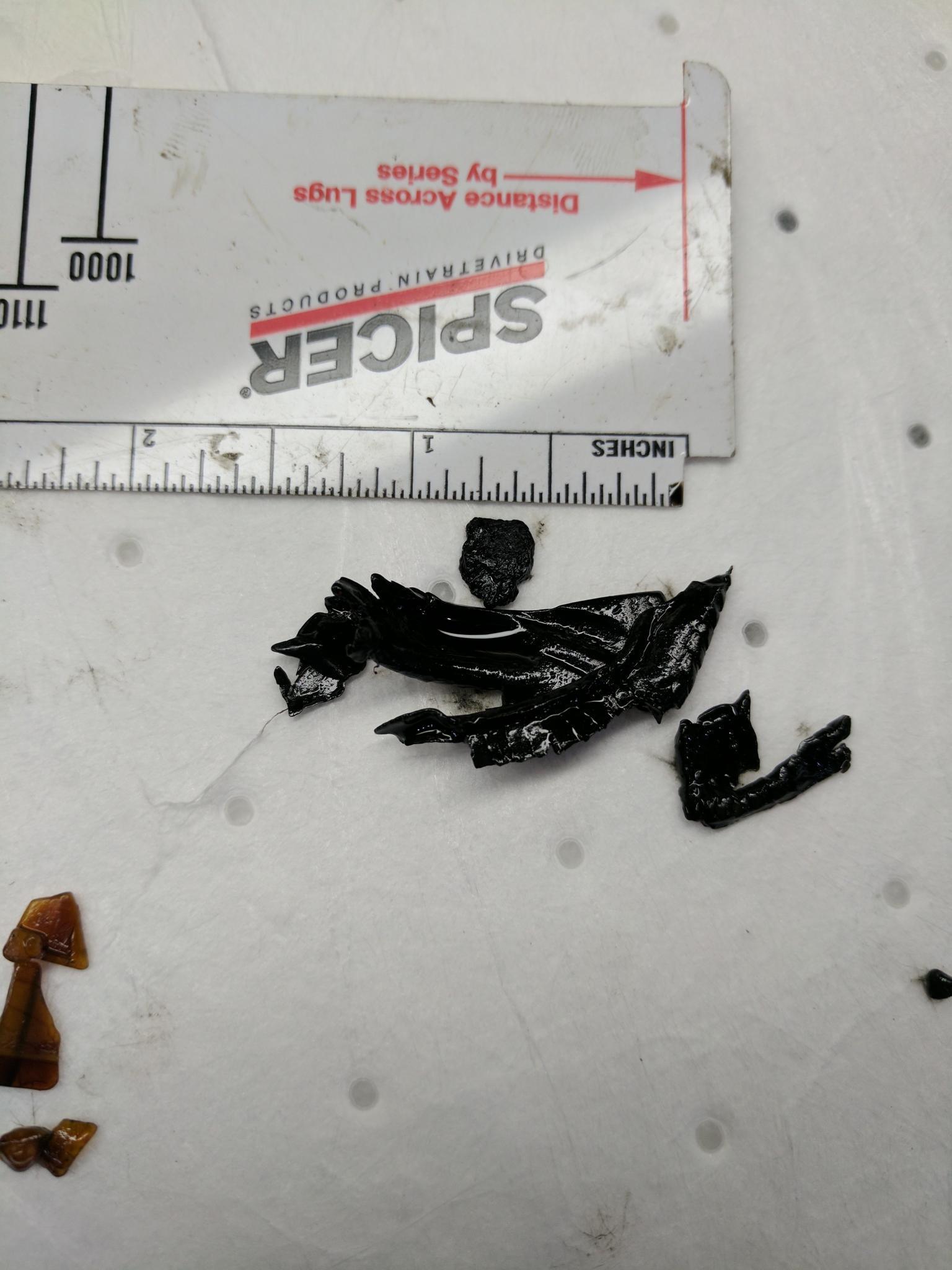

I pulled the oil pan today to shim the pump and this is what I found in the bottom of it. The Brown plastic is somewhat translucent, I'm not sure what it came from. The small metal slivers can be picked up with a magnet and I'm wondering if that came from my cams when they went bad. The large black plastic pieces are part of a big zip tie.

Looks like oil spray nozzle. Check them all from the bottom with good light.

The brown pieces are definitely part of the piston cooling jet. I'd replace them all if one has started to fall apart. If you lose a jet you will lose the piston in short order. The metal almost looks like a gear tooth. Hard to tell. Almost looks like a piece of the rings also.

If that is a 2250 or 2350 might be plastic from the injector harness. They are bad about braking..As far as the metal not sure looks like bearing from camshaft if it spun one......

It's a 871. I did replace one of the cams because the lobes on it were literally flaking off

Where on the cooling nozzle does the plastic come from? As far as I can see they are a bent metal tube that are connected to the oil passages on the block with a banjo bolt. CM871
