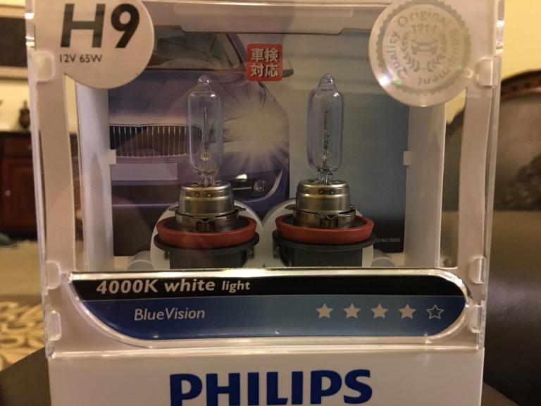

New 670 volvo owner and I find the lights weak to,
Just got theese hope they will make difference

sbtrucking - those will be an improvement over the stock type bulbs. Having said that they cost about 2 1/2 times as much and will last about 1/2 the time as a stock bulb. I put a pair of these in late last March or early April and even leaving the lights off and running as much as possible on daytime running lights both of these were burned out by December.

I hope they last me to december for $50 and then I can upgrade to led or hid,
I heard even the cheap h9 are brighter then best h11s out there, they just have a shorter life and not sure if the extra heat from 65w
will couse problems.
