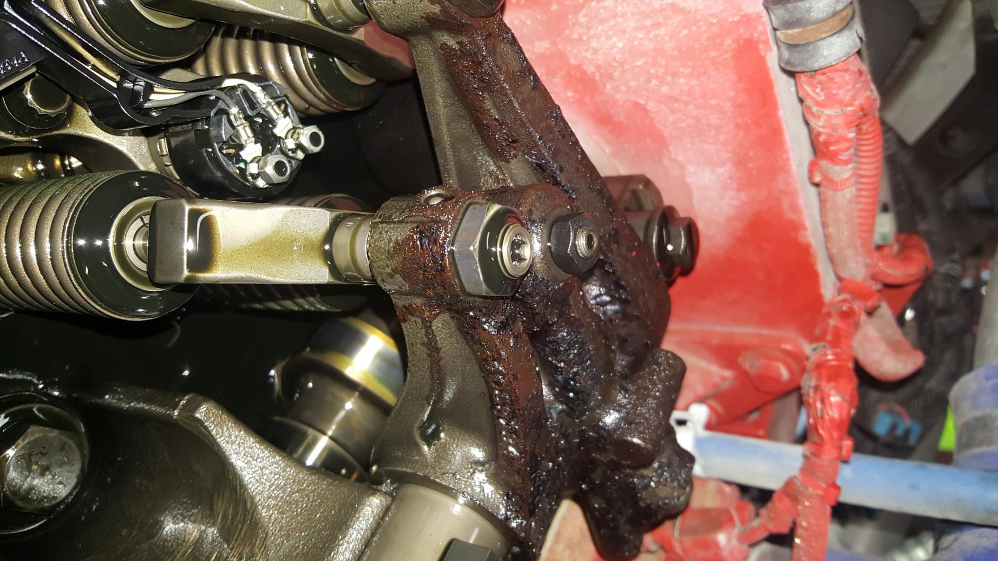

Doing my first overhead on this truck, CM2350 and when I opened it up I found this stuff. Anybody else seeing this? 186xxx miles oil changed every 15k and I don't idle.

Do you do oil samples when you change your oil?

(07-04-2017 )dhirocz Wrote:  Do you do oil samples when you change your oil?
Nope, probably should start there. Not losing any coolant but somehow moisture caused that corrosion. The truck runs 6 days a week and oil temp. is around 215-220 all the time. I've never seen this unless an engine has sat for a long time.

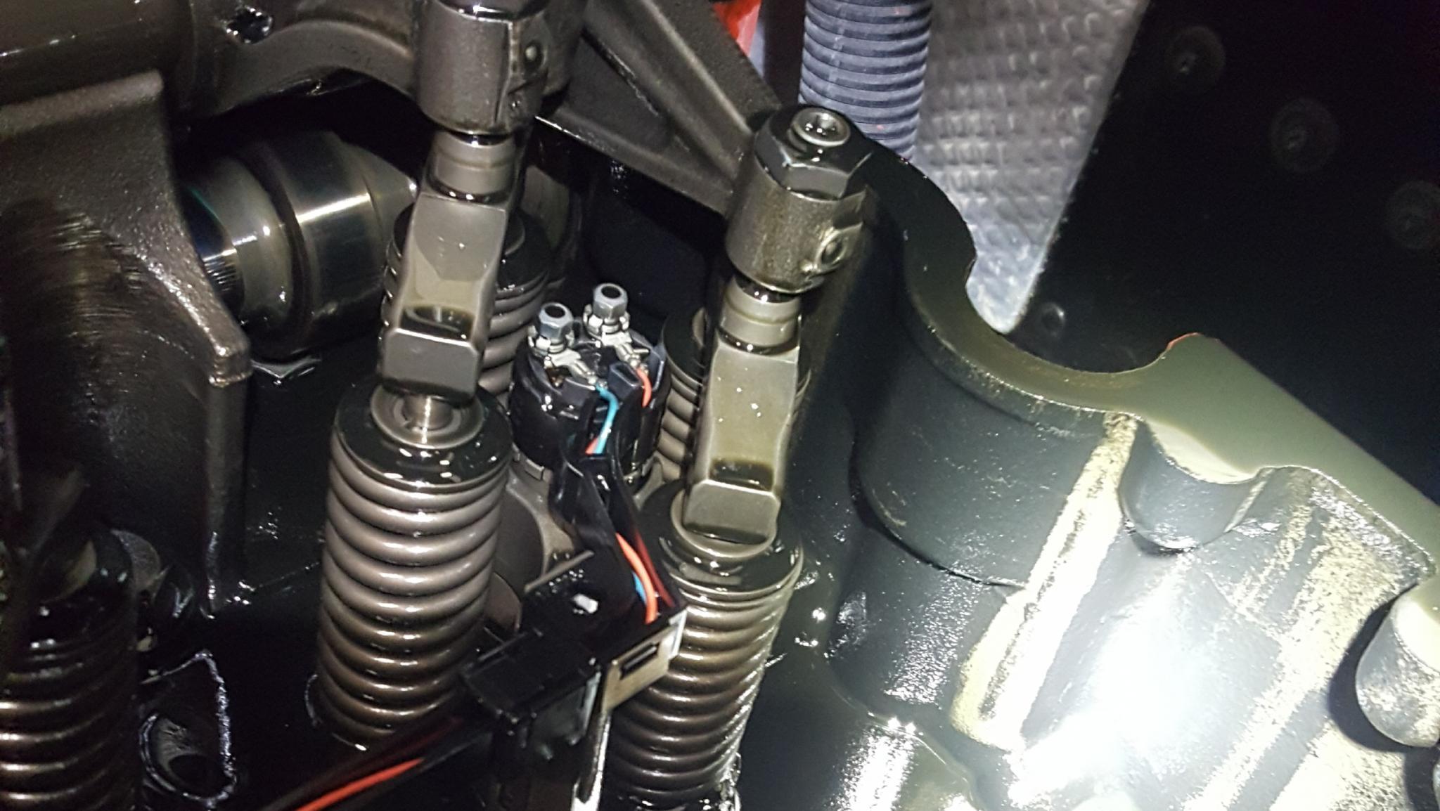

1st pic is #1, the second is #6. It almost looks like it isn't getting proper oil volume up front

SchlSM, Did it sit for an extended period at some point?

(07-04-2017 )smorgan87 Wrote:  SchlSM, Did it sit for an extended period at some point?
WATERLOO, if you're smoking at startup id recommend checking out them injectors if you havent already. Ur idle smooth? I found one of mine was jacked up and leaking like a faucet after doing mm and pulling the boost out at idle. Went from 6.5-7mpg empty to 10. De-mandates really expose what condition the engine is really in.
I don't recall him saying anything about doing injectors, but Waterloo has done a recent (since he mm'd his ECM) executive class inframe on his truck. I'm pretty sure it's in above average condition judging by his knowledge base and the work he has talked about doing on this site.
It sat at the dealership for close to a year before I bought it
