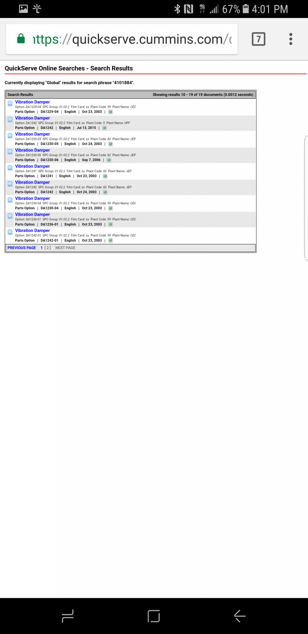

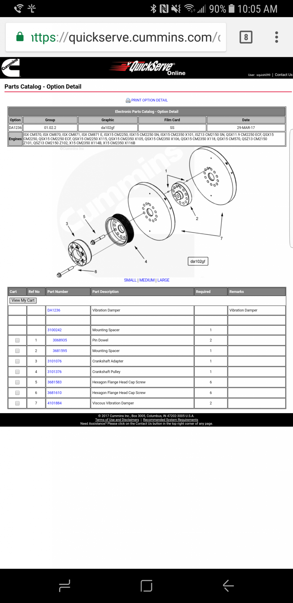

Am I seeing this right? I started pulling a parts list to get prices to do a bearing roll, vibration damper, and update/shim the oil pump soon.. Are they now using dual dampers?

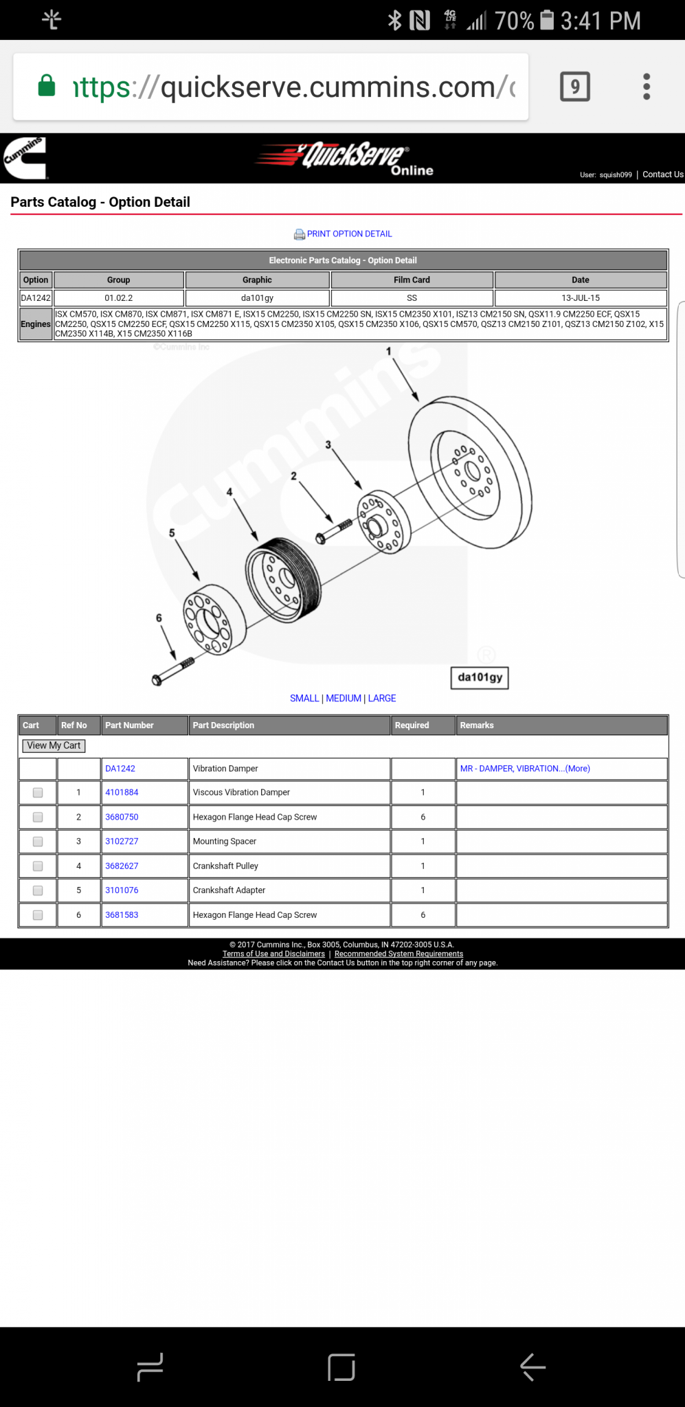

(05-21-2017 )Waterloo Wrote:  That's a new one on me. Mine was a single damper, reused the pulley... CM-871... Bought OEM damper direct from Cummins.
Revision date of Mar 29, 2017.. The revision in July of 2015 looks just like everything else..

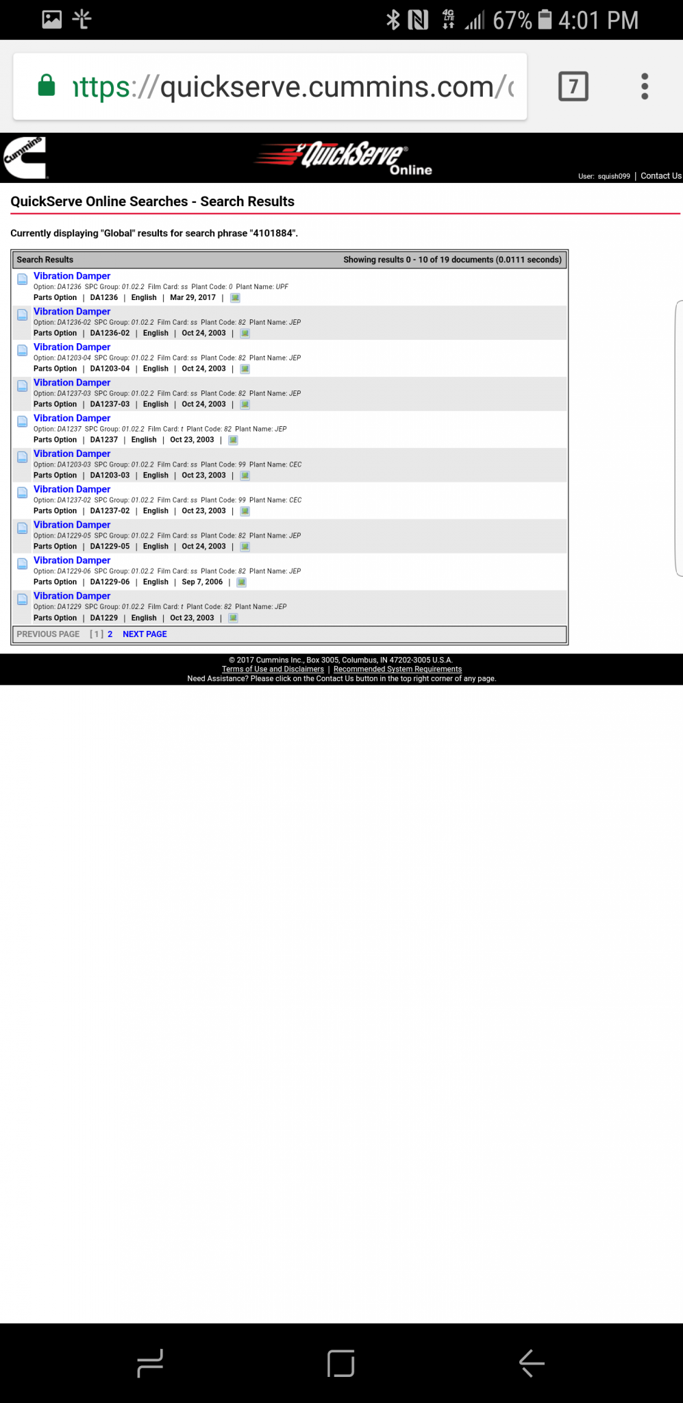

Which ISX LRT? Mines a 2250. Here's the part # on quickserve.    After clicking part # I come to this page,
actually 2 pages.        The most recent revision is the pic in my first post..

Very odd, I just looked mine up on quickserve too, 2250, P/N 4101884 shows one like normal, click the number and the latest revision is just like the first pic Squish099 posted. Two?
Squish099: Please let us know what they give you when you go to get the parts. I am going to be replacing mine in the next couple months as well and it would be good to have the heads up.

I have seen some marine and generator engines have 2 dampers on them. I doubt it is an update for a highway truck.

When you click on the manual in the service section note that it states both ISX & QSX. The dual damper option is for QSX industrial engines.
