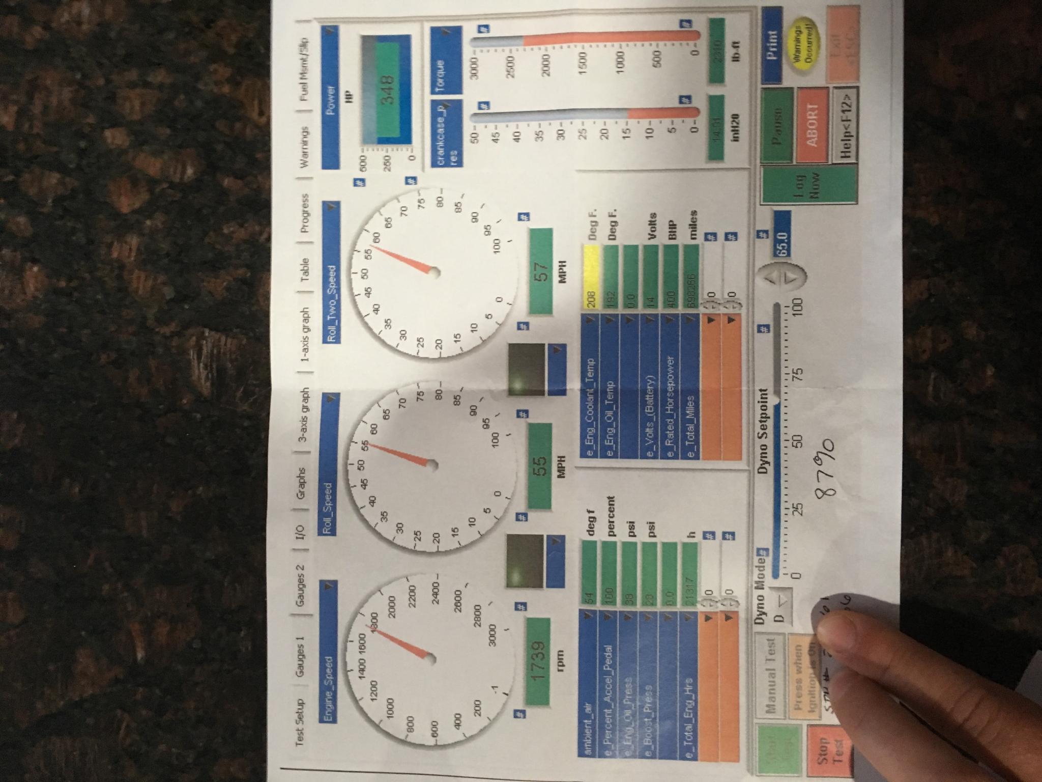

Hello All,
I'm looking to purchase a used 2010 truck with Cummins Isx 400 hp with 13 speed and 3.58 axle ratio.Truck has 700000 miles.I believe it used to be Knight's Trans truck and tranny has been converted from 9 speed.It runs fine, but if you remove oil filler cap,some smoke is to be seen at idle.Is this dyno sheet legit? 348 at wheels looks good, but 15" blowby concerns me, not to mention torque number (2310 lb-ft) which I think is total bs.This sheet was provided to me by seller. Also, you can see high coolant temperature of 208, and dyno setpoint is at 65.00 - no clue on that. Any input will be greatly appreciated! Thanks!

15" sounds excessive. Check out Rawze's video on blow by. https://www.youtube.com/watch?v=-Og4jCM6Rfg
I wonder what the service interval was on this truck, 30,000 miles?

(06-01-2017 )Vjex Wrote:  Hello All,
A dyno report will only tell you one thing... Will it pull a trailer up onto the highway,.. and NOTHING MORE!!!
I can determine that by driving it and riding the brakes.
Check the overhead cams. check the engine and suspension and truck out,.. ignore the paint job or the clean interior as it is only done for the idiots to gawk at.
Plan on doing some serious work to it before putting it onto the roads like de-mandating it or having the entire EGR system and all the sensors and egr valve replaced. That you can count on for sure.
Plan on doing 3 oil changes at 5,000 mile intervals to break loose and get rid of the 700,000 miles worth of soot buildup in it.
The list only gets longer form here. -- Anything less and you are only lying to yourself.

(06-01-2017 )Waterloo Wrote:  15" sounds excessive. Check out Rawze's video on blow by. https://www.youtube.com/watch?v=-Og4jCM6Rfg
Of course there is no service records available , but 30k + is a good bet :oh:
Thanks for your input!
I know that this truck is a long way from being put on service.I'm trying to understand if blowby of 15" means that there is not much of life left in engine.According to cummins, blowby is acceptable from 12" to 18". Anything over- calls for overhaul.I noticed on a truck a small oil leak where engine brake harness enters valvetrain,which only confirms blowby with some smoke trough filler tube.Will it reduce press having updated crankcase filter installed?
I cannot afford a decent truck right now, so my plan is to find one with some life left in it, do a complete egr tune-up and after 2 years or so (if lucky) to have it overhauled and de-mandated. With that much of blowby starting with, can it be reduced and somewhat controlled without having to tear up the engine?
Thanks in advance!

(06-02-2017 )Vjex Wrote:  ...
Thanks in advance!
I hear that story over and over and over and over --- IT NEVER WORKS OUT!!!!!
You can't expect to buy something that is at the end of its service life and "wish it" a new one!. Expect to inframe it soon,.. very soon after buying it and if you can't afford that -0-- GO FINANCE SOMETHING NEWER!!!
You Don't buy a "FIXER-UPPER" truck (or house or boat or even a lawn-mower) if you can't afford to "FIX IT UP!". =-- Bad business decision!!!
Get your personal finances in order FIRST -- Tell the old lady to stop spending all you damn money -- GO GET A COMPANY DRIVER JOB IF NEED BE AND SAVE SOME DOE!!!! --- Your going to need it.
I can't tell you how many people I have met who want to/or have just become truck owners that have their head in the clouds,.. when they should be focusing on putting their feet on solid ground instead. -- THEY ALWAYS LOOSE THAT GAME of buying something worn to the bone in the "hopes" of not having any problems for a couple years,.. -- IT NEVER WORKS OUT -- and to top it off --- THEIR FINANCIAL SITUATION DOES NOT IMPROVE ONE DAMN BIT -- because they are chasing problems and downtime the whole time they own the truck,.. then one day -- BOOM-- inframe time and they ain't got 2 cents to put towards it...;-- FIX YOUR FINANCIAL SITUATION!!!!! -- PRIORITY ABOVE ALL -- and if you can't do that --DON'T BOTHER OWNING A TRUCK!!!

I've been told by a couple places with dynos that thiers wasn't set up to calculate actual torque and to ignore it, they say the dyno cost 2x as much or more to buy if you want it to do so. Maybe that's the case here.
Personal experience, every single time I buy a miles out motor..... it blows soon! Whoever sold that hunk of crap did it for a reason.
There is a million trucks out there, youll thank yourself later if you take the time to find one with a strong engine.
