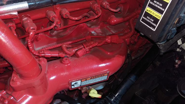

There are no sensors on the drivers side intake manifold on my engine that I can find. I have found many pictures of the pressure and temp sensors for the Cm871 on top of the intake manifold, and my 2250 looks nothing like that . The only thing I can find on the intake manifold is a flat sensor on top of the manifold that slides in horizontally towards the rear of truck. Is there supposed to be a separate pressure and temp sensor? Do they thread in? I am going crazy trying to find these sensors.

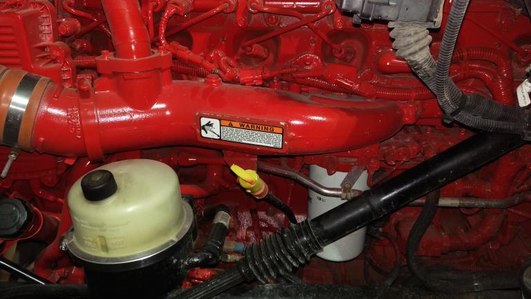

./uploads/201603/post_1817_1457923871_6ad8d03062db2f66cef12a9d3abdab4b.jpgHere are a couple pictures of my intake manifold./uploads/201603/post_1817_1457923839_c709781bf61a0853526f5a539d2aeb32.jpg

Climb up and look

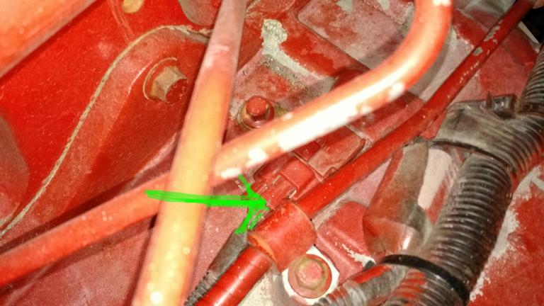

./uploads/201603/post_1794_1457926014_d3c66befa49efece3f0bdfe4d34174e8.jpg

(03-13-2016 )jrdan191 Wrote:  Thanks, that's the one I'm looking for. Any suggestions on where to get a replacement? All the ones I found were thread in sensors . Is it the same sensor as the 871?
I'm not sure is it the same. The best way to go open an account www. cummins quikserve it's free
type in box you engine serial number and enjoy with parts#, how to and other very useful information.

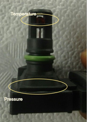

./uploads/201603/post_2_1457960320_7f55f24e2595529550d2133347bfe145.jpg
Elaborating for those who have never seen this.. Thanks Snailexpress for the photo.

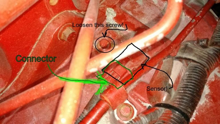

./uploads/201603/post_1744_1457958543_d93446f08872a41b17576c9024222b0e.jpg
The sensor itself slides down into a hole underneeth. It likes to break, it is plastic. Try to lift it up out of the hole straight.
./uploads/201603/post_1744_1457958680_d2c3d3c48d73d92961dd77d559ca9d28.jpg
As seen in the pic above, it is not really possible to clean them once they start to read incorrectly as the pressure part of the sensor is up in the head of it, and it gets packed with soot and dust. It is a capacitive type of sensor.. so liquids of any kind will screw up its readings.. therefore, if someone uses spray cleaners on it, it tends to still read incorrectly after. It simply needs replacing when it gets really dirty.. or every couple years at most.

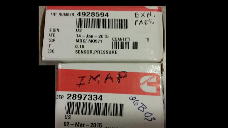

and the part numbers. It is the same part numbers for the IMAP and exhaust gas pressure sensors for the CM871, the CM2250, and the CM2350.
./uploads/201603/post_1744_1457958919_5059fa4e0f703d0c65685af816ec33dc.jpg
The one on the bottom is the IMAP (Intake Manifold Air Pressure Temperature Sensor). The one on the top is the Exhaust gas pressure sensor. You should change that one too if it is just as old.

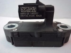

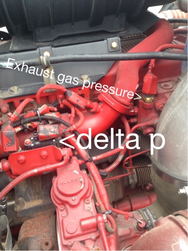

Here is some more pictures of this...
Thanks to forum member 'Parttime' for providing this picture. Here is the other side...
./uploads/201603/post_2_1458559996_2c2ce7db6f4cacee6dfa8c612574af9f.jpg
The delta-P sensor. it is part # 4307166
./uploads/201603/post_2_1458559981_6281bf61947913a2b5fd39f8d106af2a.jpg
