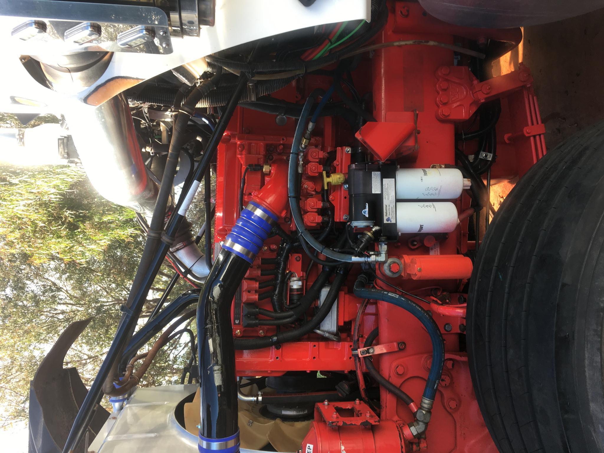

(07-26-2017 )AussieISX Wrote:  Bit of progress the last couple of days. Should be making noise by the weekend. Fitted up a new 2050 easy pedal clutch and did a heap of re-ferb work on the harness. Re bushed the spring mounts on the chassis and painted and fitted new springs while the engine was out . Still need to strip and clean the radiator and fit new gaskets on the tanks

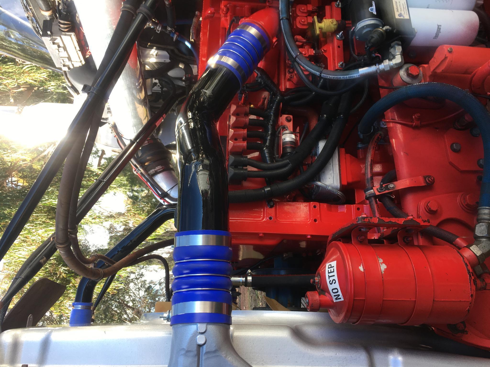

Is that one of those anti-air fuel systems on the chassis? Do you notice a difference with it or has it only gone on recently?
07-27-2017, (Subject: Cm570 build )
Post: #30
RE: Cm570 build
Yeah it's an airdog. Had a lot of trouble with the fuel pro primary filter allowing air into the system. Ruined a few injectors until I realised what the problem was . Threw away the fuel pro and fitted that up . No change in fuel use but I never expected any . With the injector design in the hpi system any air in the system can mess with timing badly among other issues. I have no air anymore

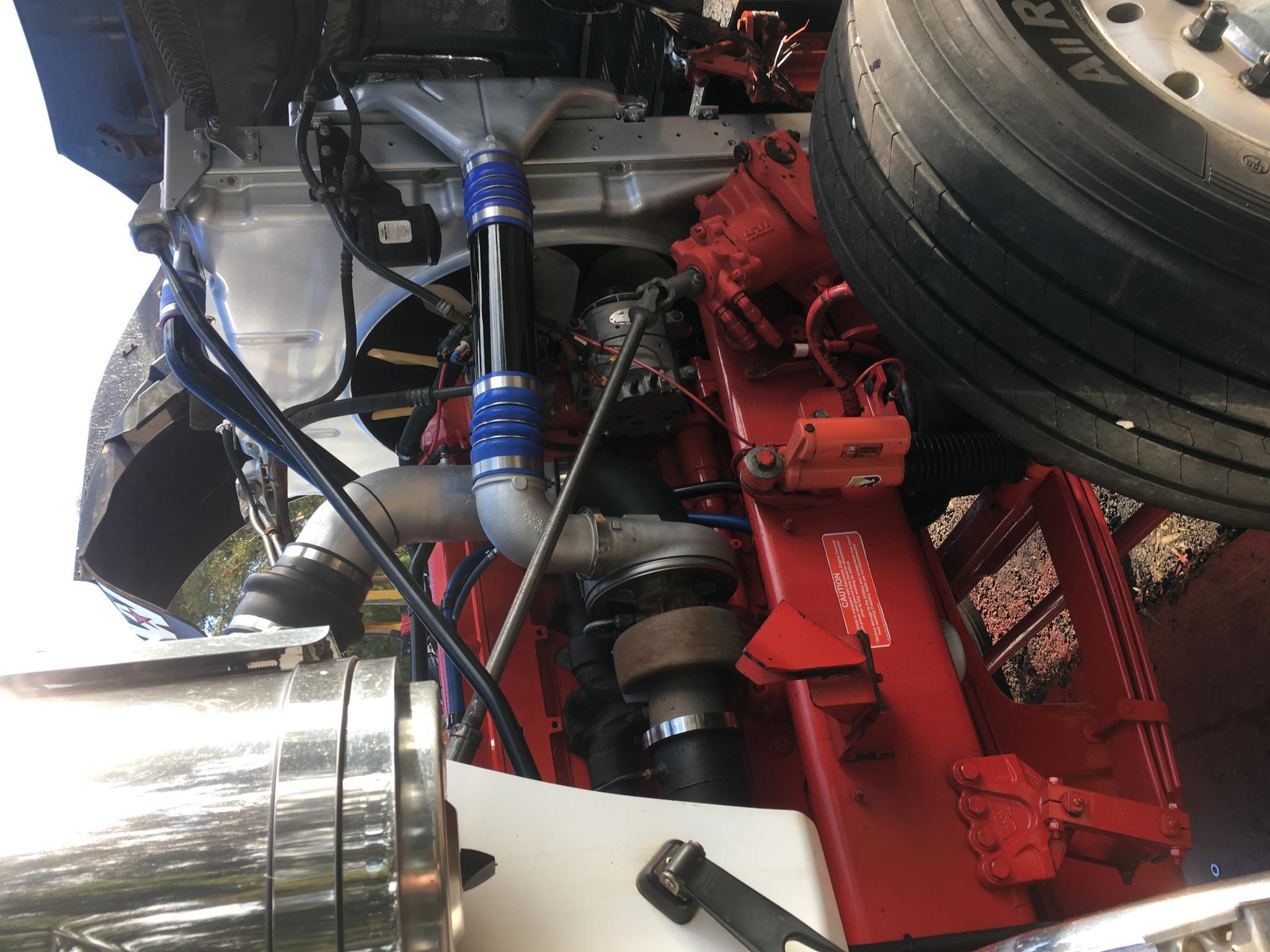

Got a bit more done last couple of days. Intake manifold is different as is the thermostat housing so I fabricated the boost pipe and top radiator pipe . Pretty much all plumbed now and ready to fire
