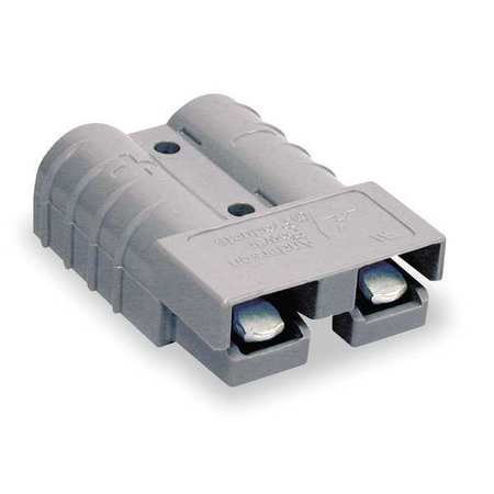

I have the same generator. I absolutely love it. I cut off the terminal ends to the generator and used a 50 amp ./uploads/201707/post_2290_1499208264_4f247406f177718d3ed79167221033d1.jpg connector to use the truck batteries instead of using the small 20 amp hour one that came with the generator.

I have the same generator. I absolutely love it. I cut off the terminal ends to the generator and used a 50 amp connector to use the truck batteries instead of using the small 20 amp hour one that came with the generator.
