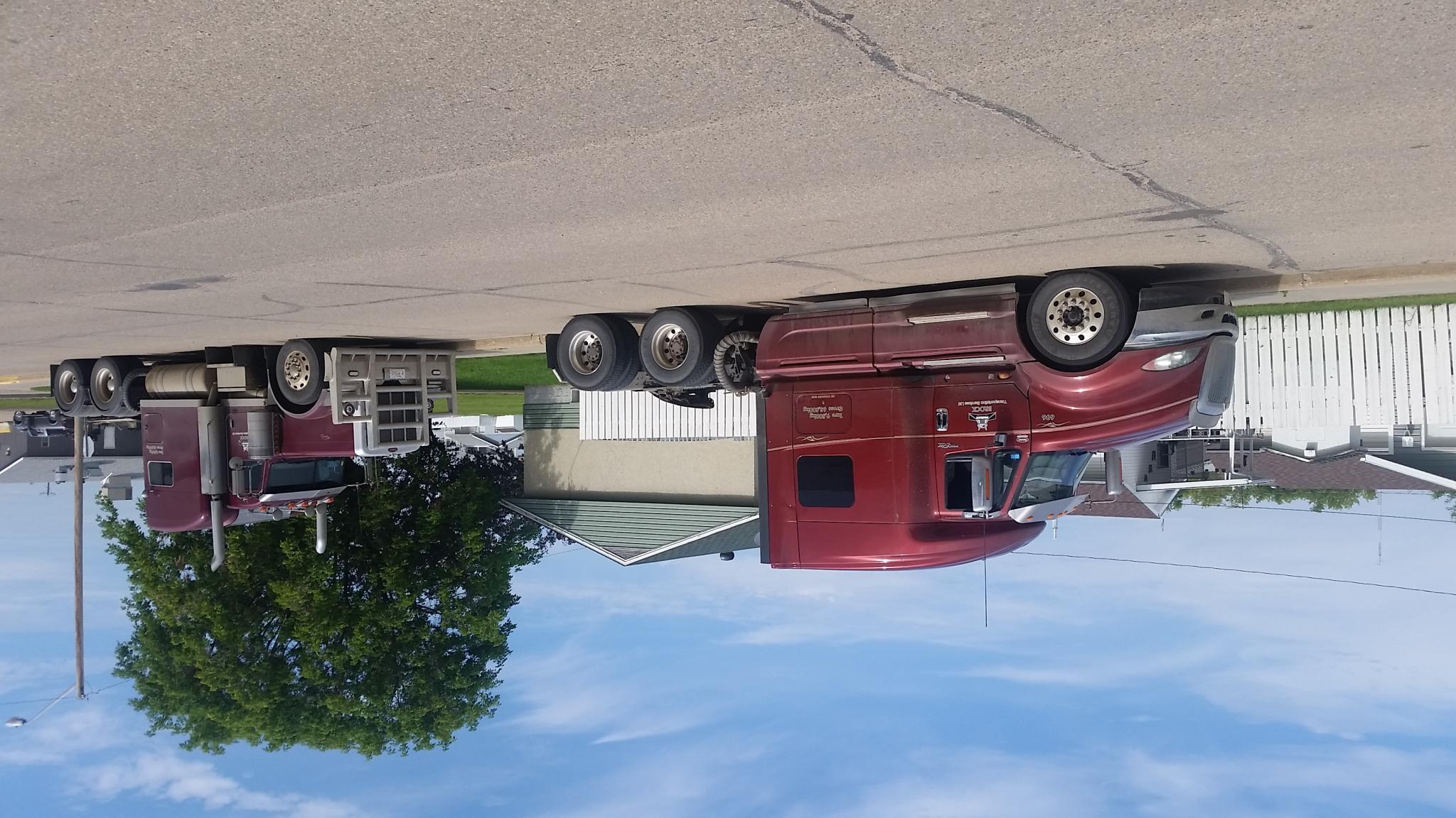

I bought this truck to pull propane bottles. Bottles that were all over the map in regards to pin placement, which it sounds like you may be experiencing. The reason I sought out a tractor with a steerable lift axle. It is rated at 8,000 lbs and works to relieve the weight off the front end. And yes, I have the same front axle that you have. This truck is always steer heavy, even when empty.
If you are looking for a beefier front axle, I would skip that and have one of these steerable lift/drop units installed IF you have the room. They are not to bad price wise, I want to say around ten grand installed. If you don't have the cash, I believe it is something that could easily be financed if need be. If I were pulling bottles, I would have one of these on my truck and the reason it stays on my truck, I still use it quite a bit with my dry van. Here is a link to the lift in the photo. It has been virtually trouble free, knock on wood. http://www.watsonsuspensions.com/Truck/S.../SL8K-0893
I pull a dry van now, and when I get those loads over 30,000 lbs, I drop that axle. It really smooths out the ride and I believe it has prevented further damage to my truck. Added benefit, my 16 ply Michelin steers still look like new after 200,000+ miles.
It is also a conversation starter...

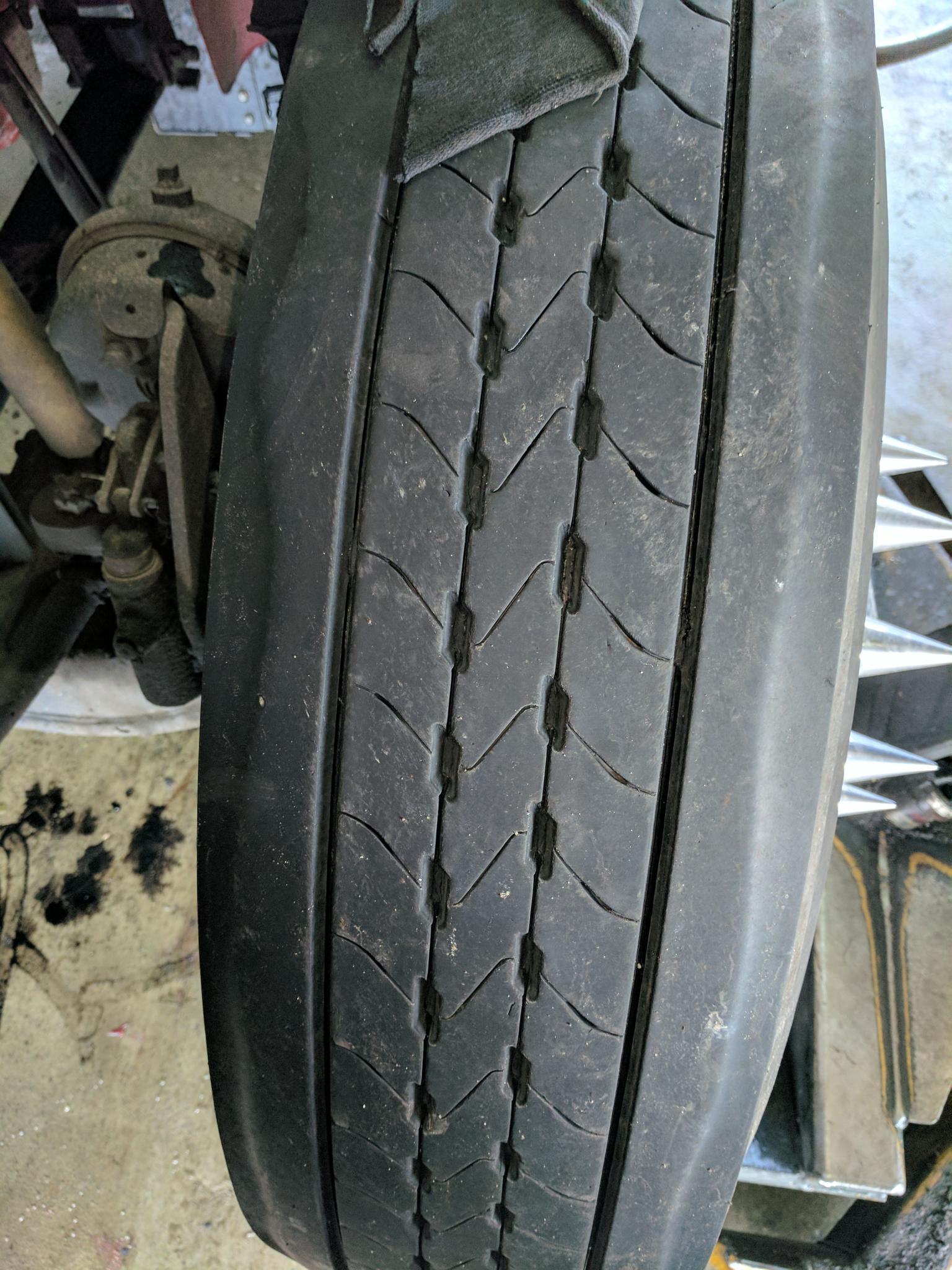

Thanks for the inputs. I believe it may just end up being the nature of the beast by what everyone is saying. I don't have room to run a lift axle so that one is out. I run 120 psi in my steers and I do have alignments done quite often. I also pull the same tanker 95% of the time. Here are pictures how my tires wear, both sides wear the same.
