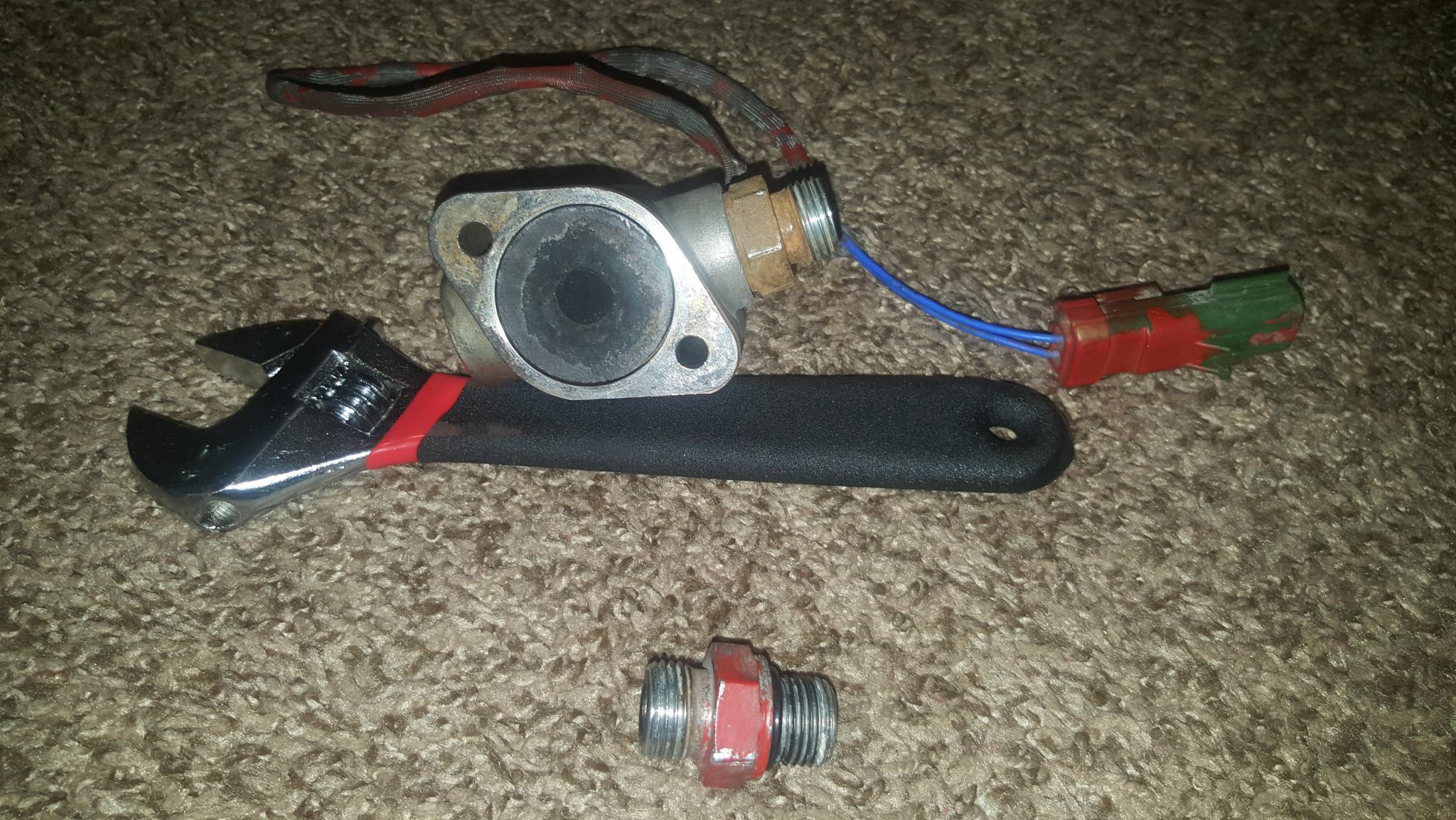

I have removed the doser fuel injector and I have replace the egr differential pressure sensor. Is it ok to clean the hole for the imap sensor with a bore brush?
