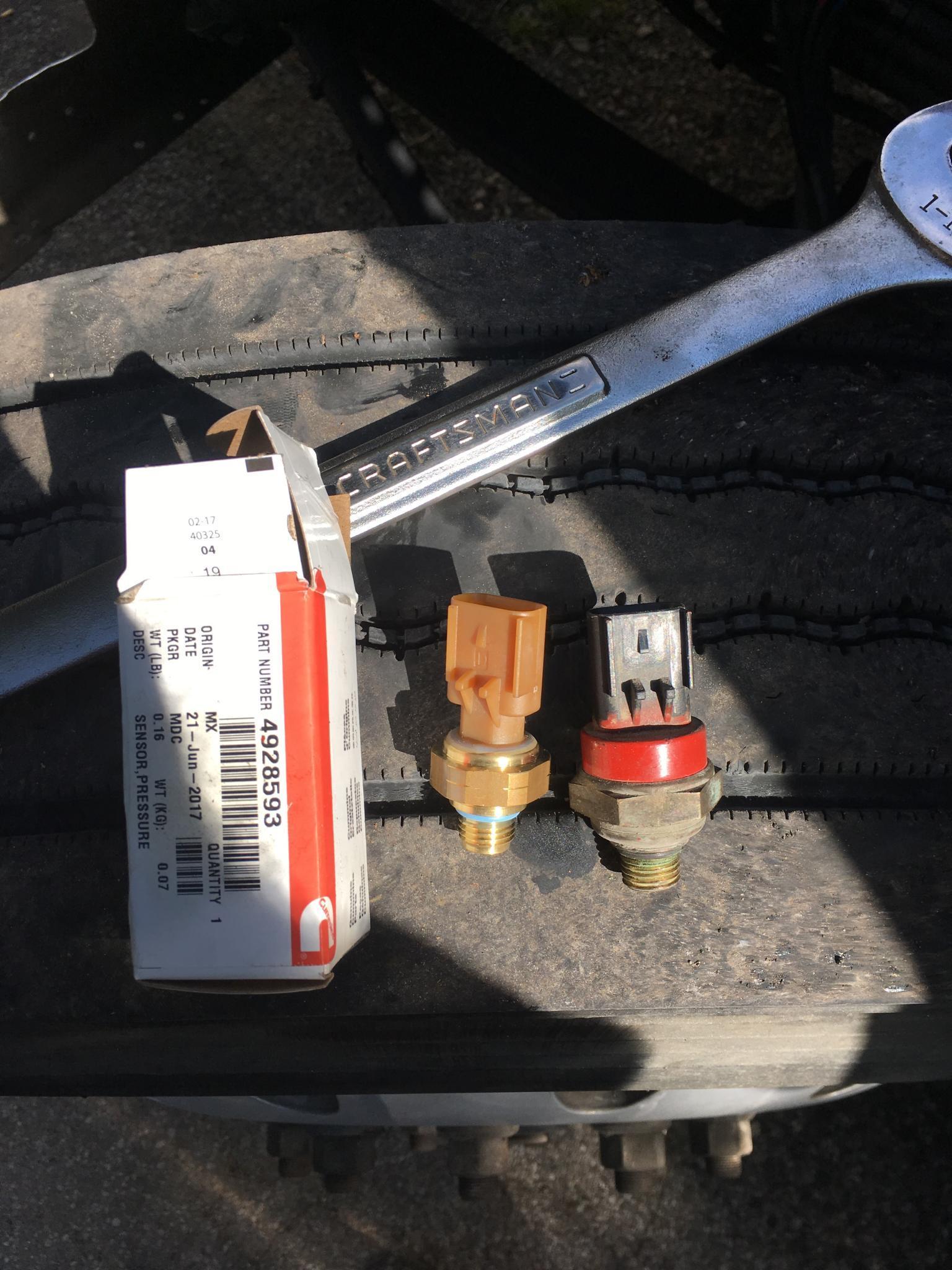

(07-28-2017 )Billdozer2 Wrote:  Although my engine is different, I have a 2250, I was having issues with turbo cough. Randomly while climbing a hill, the boost would hover right around 30 psi or so, turbo would cough, boost would drop to around 15 psi, and then climb back up to the low 20's. Sometimes the boost would go no higher than 20 psi all day. No check engine lights. Nothing. Using information from this forum, I decided to replace the sensors that directly deal with boost information to the ECU (Thinking that incorrect information was being sent to the ECU) I replaced the IMAP and the Exhaust Gas Pressure Sensor. Turbo cough is gone. Fuel mileage is up. Boost pressure is back up and truck is running great, for now.
I know it may sound silly to replace sensors even though the truck is not telling you that anything is wrong, aka Check Engine Light. Cummins Quickserve even says that you should not replace the IMAP just because it has soot in it. But, the sensors on these engines get covered in soot and start sending false information to the ECU. They should be replaced as preventative maintenance.

(07-28-2017 )DDlighttruck Wrote:  I'm going on blind faith that what you and everyone else has said. Arguably $1200 isn't a lot of money but it's hard to swallow when there are no codes or justification to do so. Some of that is a low coolant sensor and a rear axle temp sensor but still. That is a chunk of change.
So tomorrow we pull a lot of stuff apart and put it back together. Hopefully the money is recouped in fuel savings. I appreciate the advice I don't have an issue spending the money if I see the return.
Thanks
If the other sensors look like the one you posted, I'd be shocked if you don't see an improvement. I'd also go ahead and do the overhead. Doesn't hurt to know that it is done and done correctly. You could do this yourself with Rawze's overhead video. (That is if the 870 and 871 overheads are the same. I'm not familiar with either engine.)

Sensors at home on your schedule are a lot better than problems on the road 1000 miles from home and at the mercy of some idiot mechanic. I would just call it good business practice and move on. Just imagine the bill you might have beat will that 1200. It will help the sting in the pocket book. Your doing well, seeking good advise.

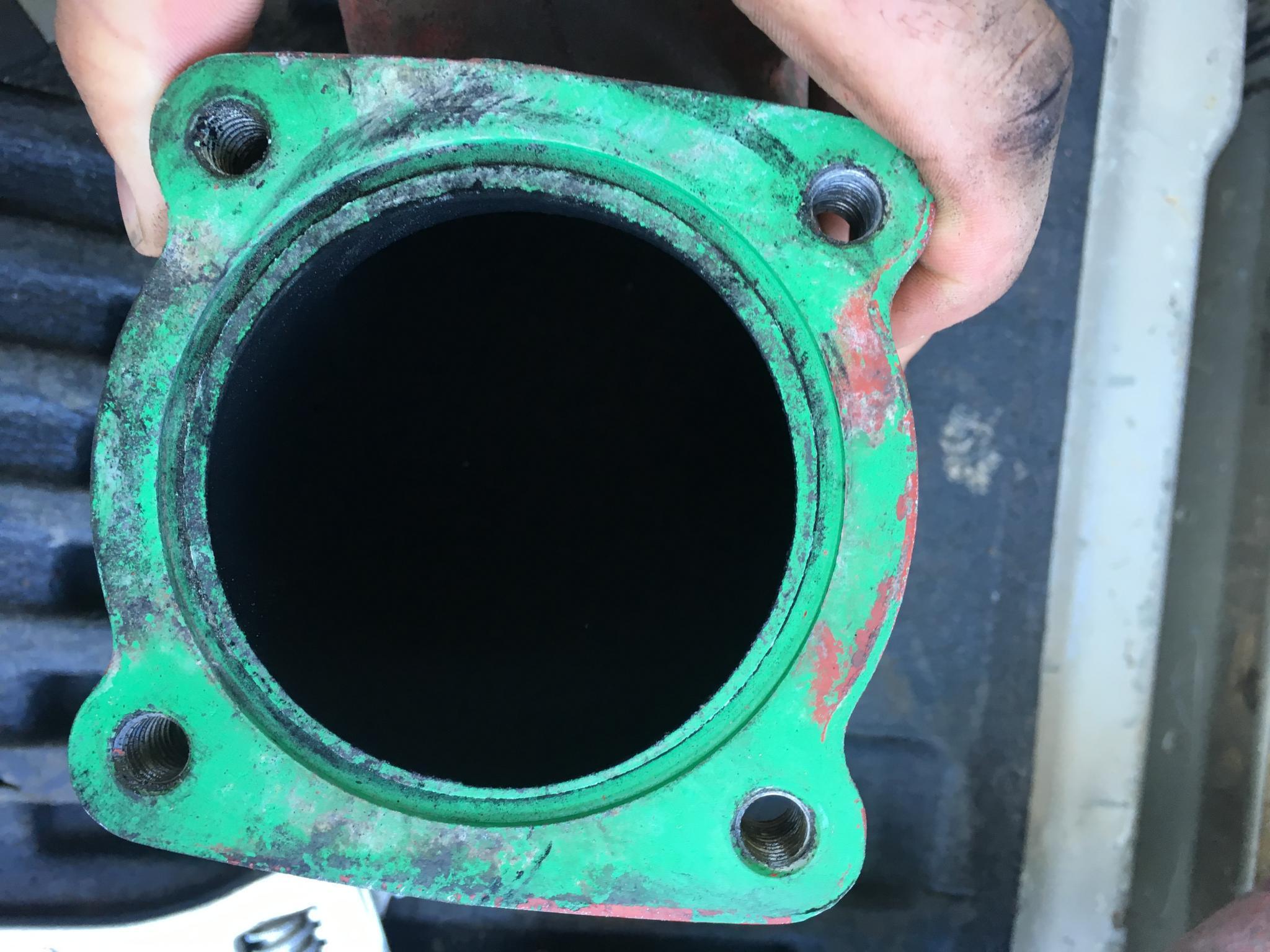

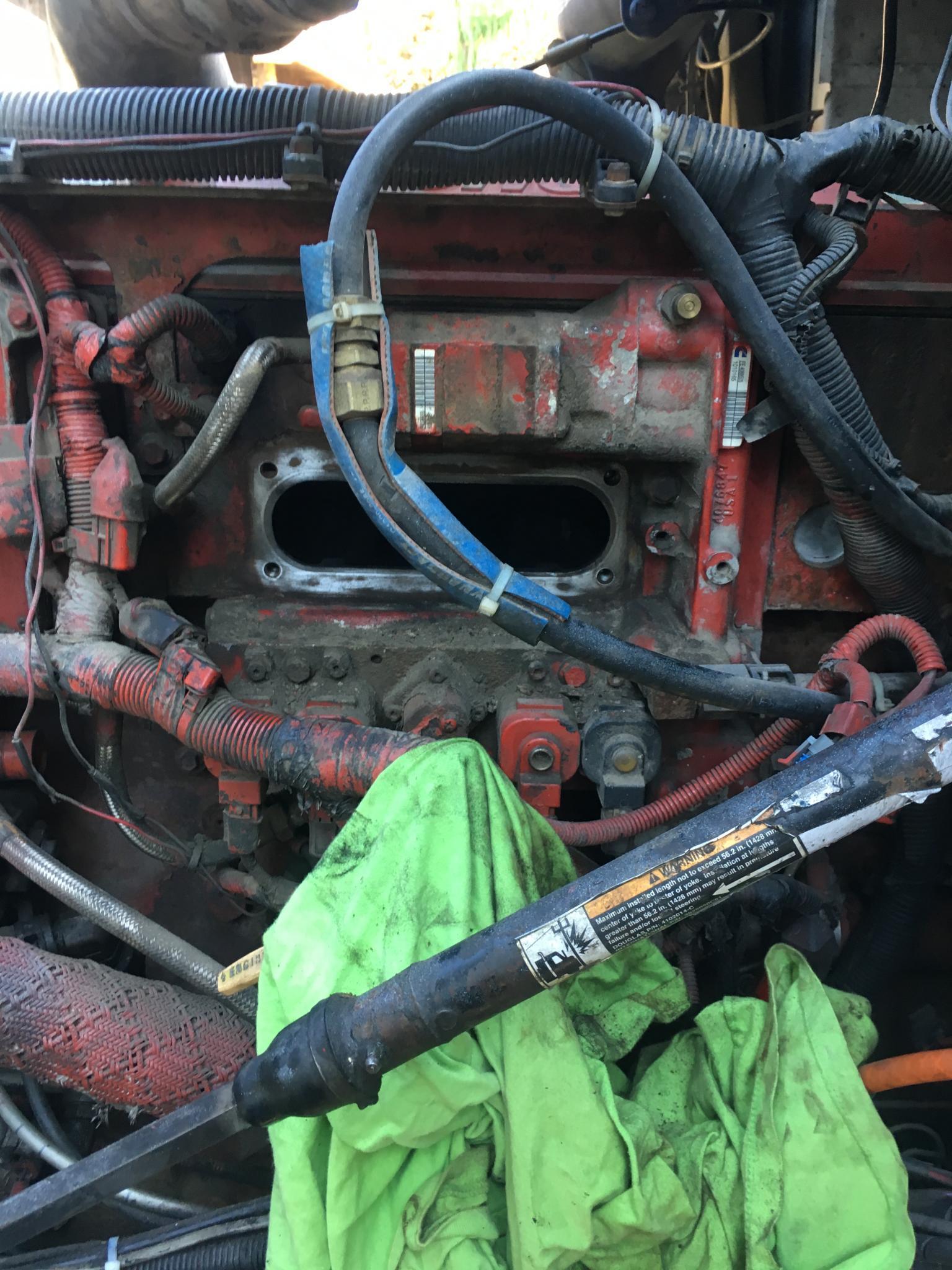

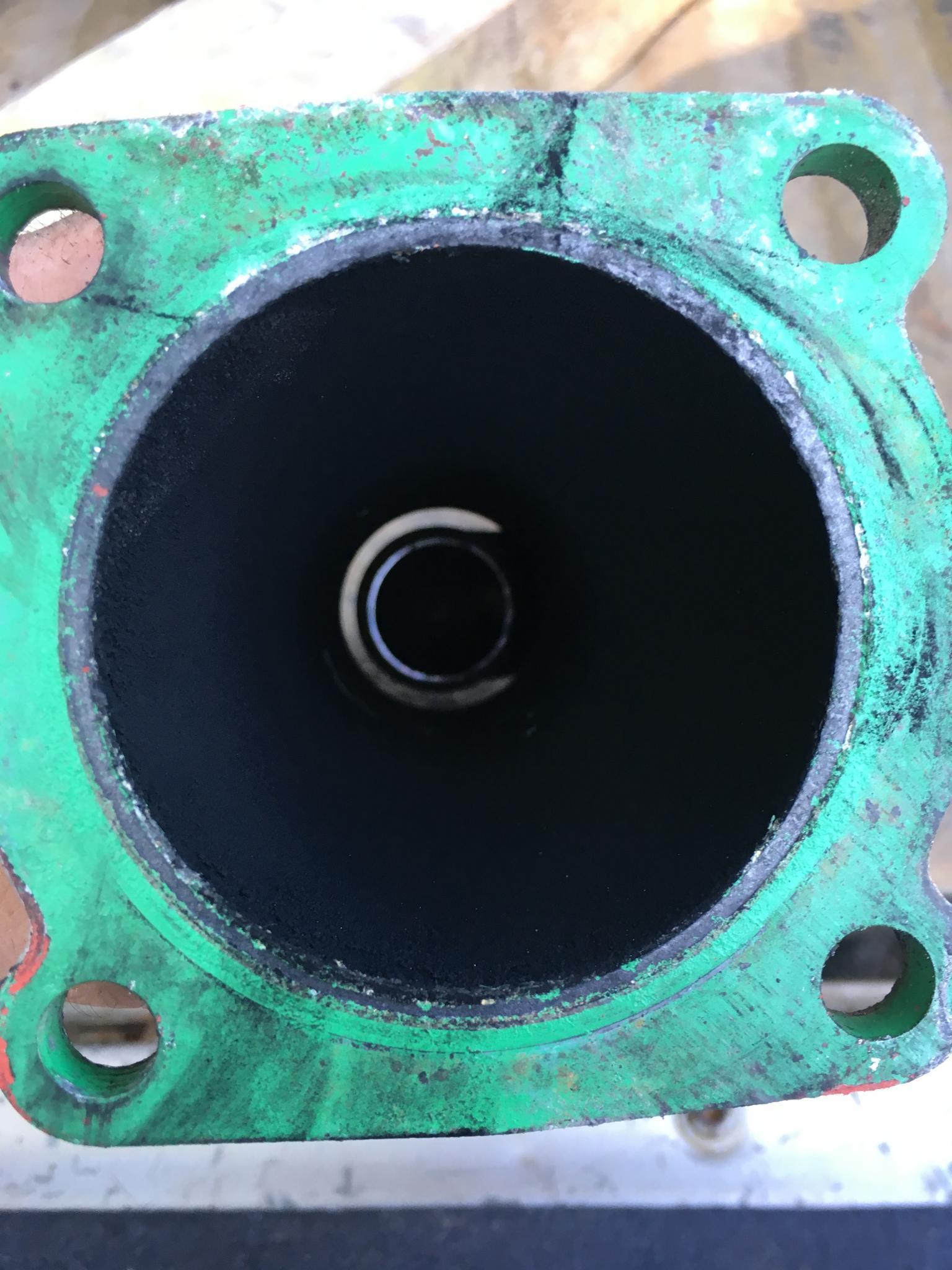

Progress. I think it looked pretty clean.

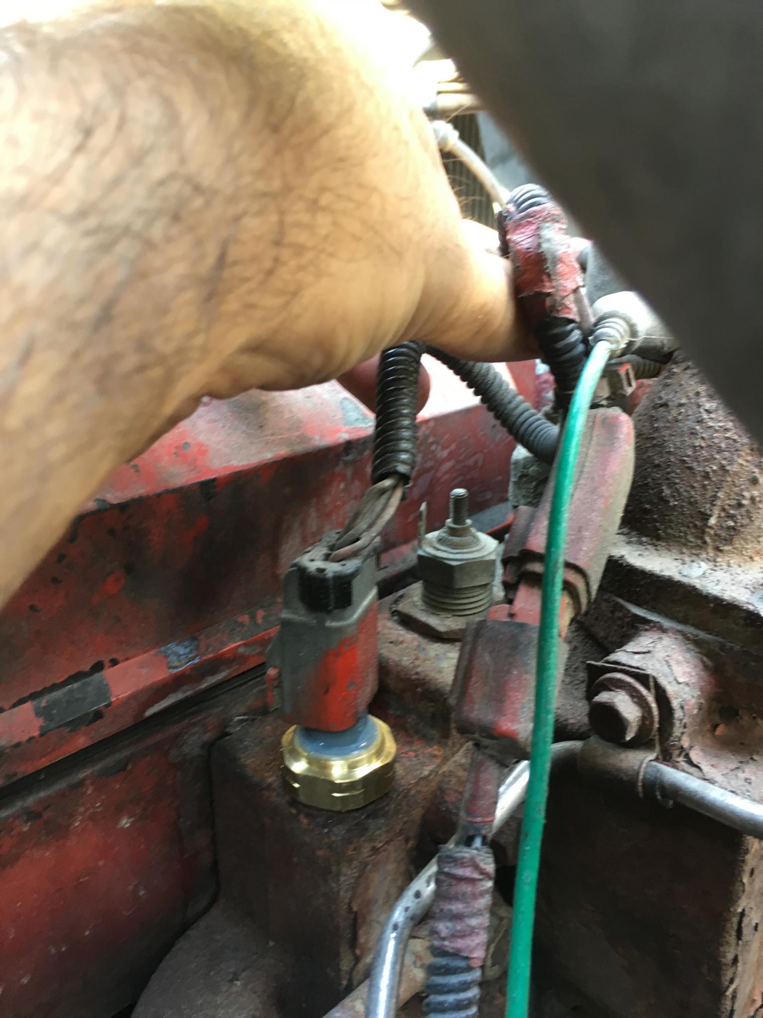

Last picture the sensor to the right of the new one has nothing connected to it. Is that normal?

Not bad! Looks good! Get that Carb Cleaner out and start scrubbing! LOL! You will have a new truck when you are finished. You should feel it the minute you fire her up. One thing too, the air compressor. If it is really knocking, there is a rebuild kit for it, it runs around $500 and you can do it yourself if you are up to it. The compressors on these ISXs rarely fail, it is usually just a bad head/gasket that needs to be replaced.
Also, your Damper, 500,000 miles on those, they do go bad. I replaced mine back when I was having issues and it cured a few problems, really smoothed out the motor. Just something to think about. oh, and the damper needs to be painted, no paint, no warranty. Hope this helps.

No clue on that sensor to the right... Almost looks like a temp probe? Someone will chime in.

Its already cleaned and back together. I chickened out on the metal tube leading to the exhaust pressure sensor, I know how to do it, cut the tube off, heat it up, use a ratchet and a socket to spin it out. BUT if that doesn't work, then on a Saturday I'm stuck. I'll leave it and let a shop do it when there is time. Then if it doesn't work it's their problem. I need to go to work on Monday.
The EGR differential tomorrow, and look for the delta P.
