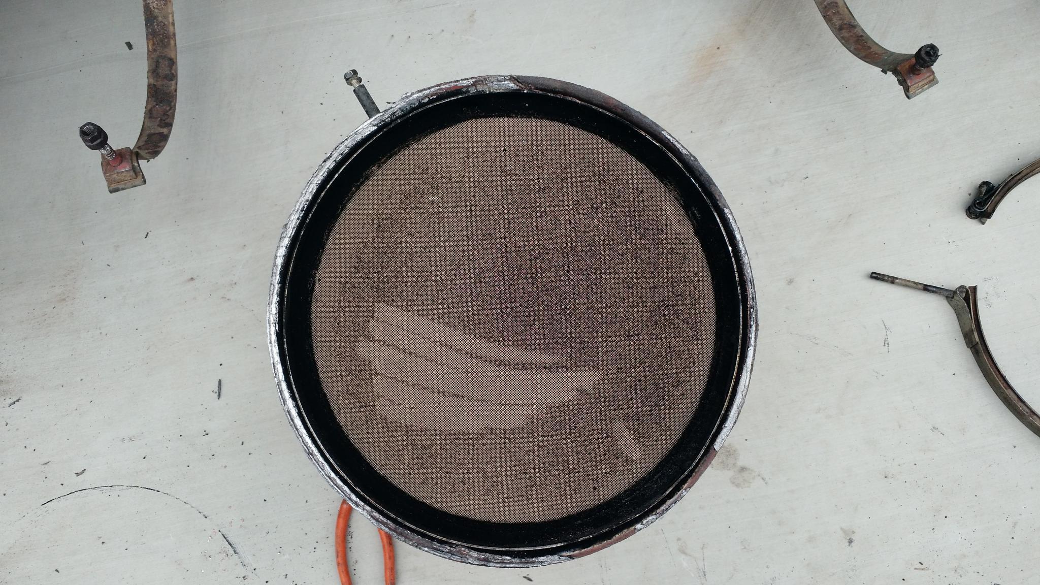

| DPF replacement  Replace the DPF and keeping the DOC. Any other suggestions? I have been babying it for a few months now, I got 1200 - 1500 miles between static regens driving at 62 and below, about 200 - 300 miles between when driving at anything above 64. I believe the white residue was from the bad doser leaking coolant (replaced a long time ago). It doesn't use any coolant and between 2 and 3 quarts on 15k oil changes(rotella). Is there any tuning that can help an engine that maintains the mandate? Thanks. | |||

| RE: DPF replacement  Off topic.. The pink color to both filters would scare me, desn't take much coolant and the metals on the filter are gone..  | |||

| RE: DPF replacement  I replaced all those sensors with new parts and the doser in early Feb. Again the truck uses 0 coolant. and has, what I would consider low oil usage(<3qts/15K) for 600K. Static regens resulted in 0.55 in. hg readings for the DPF delta. So I am looking forward to getting a lower soot tune, hopefully.  | |||
