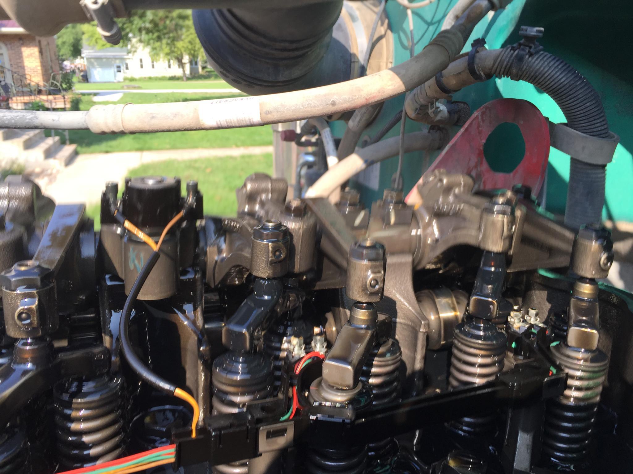

So I just did the first overhead that I know for sure was done, appx 100k on reman cm2350. The clearance is listed below. After doing all the valves I fired up the engine sans valve cover, and that's when I saw number 5 intake rocker not flowing oil like the others (#6 seemed light). Exhaust rockers just fine. I shut down and barred the engine into position to triple check the clearance, all just fine and set at 0.35 & 0.68 mm int/exh. Thoughts? I'll attach a picture.

To add more information, upon another inspection the cam is getting more lube on the #5 position, kinda makes me think the rocker arm is toast?

Pull the rockers and shaft, clean all passages with brake cleaner and compressed air. The shafts and rocker arm passages will get sludged up and reduce oil flow. That's a lot of the reason for cam failures

(08-26-2017 )Emeryville64 Wrote:  Pull the rockers and shaft, clean all passages with brake cleaner and compressed air. The shafts and rocker arm passages will get sludged up and reduce oil flow. That's a lot of the reason for cam failures
And get a bypass filter on that engine asap!

Some guys will adjust the intake rockers to 0.015" instead of 0.014" for better oil flow.
It could be clogged passageways like the others mentioned.

My engine was the same low oil flow so I remove al the rockers and clean everything with compressed air and gasoline. It was like grease in there took five gallons of gasoline to clean the hole head rockers and shafts after that oil flow real good

(08-27-2017 )gatow900 Wrote:  My engine was the same low oil flow so I remove al the rockers and clean everything with compressed air and gasoline. It was like grease in there took five gallons of gasoline to clean the hole head rockers and shafts after that oil flow real good
Those guys who run synthetic + bypass filter + extended oil changes always have this kind of issue with them. All those guys who run their ISX's like that complain over and over "Why does my overhead cam keep getting chewed up?"
I know of 2 people personally who keep running their engines like that, one of which is running the amsoil syn + extended, who has gone through 3 cams in less than 700k miles!. The guy lives down the street from, and has been completely brainwashed by that crack-pot salesman who hangs out and sells the s$it at Jubits truck-stop. The other guy had just eaten through his second cam in 600k miles (not the first one,.. but the second one) now, and has to put a 3rd in too. - I tell him the same damn thing! and I get the same damn response --- "That can't be it" -- Yet all the evidence points clearly towards it!.
-- First,.. I tell them that if what they are doing is superior,.. The engine would never wear out because mine, and about 1,000 other trucks I have seen running REGULAR OIL do not have that issue, yet 80% of EVERY TRUCK I HAVE SEEN where someone is using syn+extending oil changes --- HAS THIS PROBLEM!.
You tell them to stop running that synthetic + extending their oil changes, and that it costs them more in replacement cams that the few bucks they save on oil changes,.. and they will only still ---> argue back and tell you that you are full of it.
--- All I can say is ---
"WOW THE POWER OF BRAINWASHED MARKETING THESE DAYS!."
