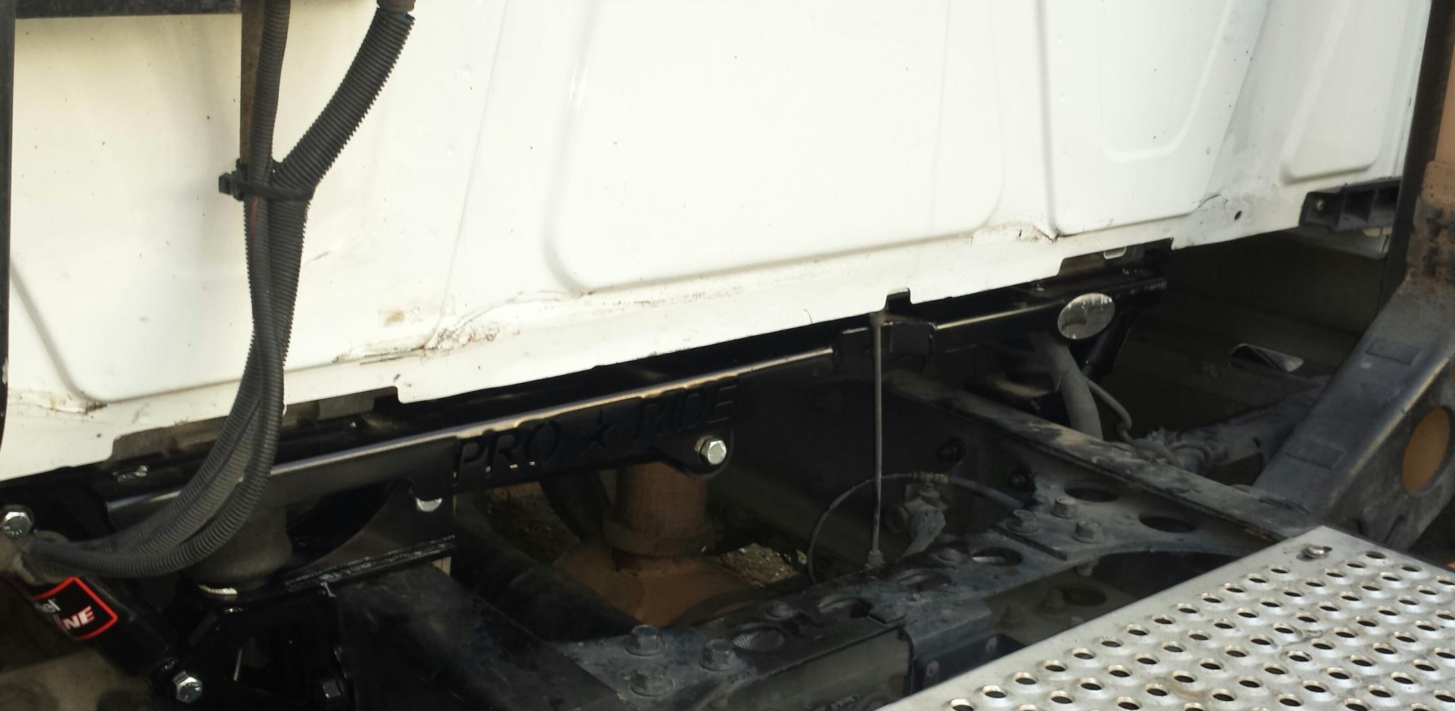

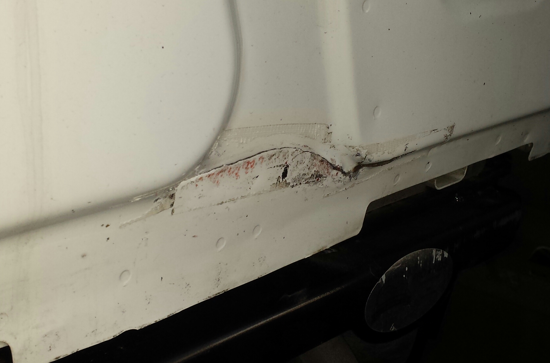

Installed a Pro Ride this afternoon. Easy to do after watching everyone else. Used two floor jacks with 4x4s to support the rear corners of the cab. Installed the top plate first, then loose bolted everything else together (to avoid alignment issue on the strut). Took about 4.5hrs. The shocks were totally shot. The cab had slammed down hard enough to buckle the back wall of the cab and crack the outer skin. Used a porta power to shove everything back as much as possible. Will finish with a little welding. Also replaced the front cab bushings.    ./uploads/201712/post_3119_1514601984_b15c0c33bfe128c0d526c276bbca0ce7.jpg./uploads/201712/post_3119_1514602431_9109d09a4e9b3ea895d310b1d0e58242.jpg

WoW!. those bushings were shot!

(12-29-2017 )DosGatos Wrote:  Installed a Pro Ride this afternoon. Easy to do after watching everyone else. Used two floor jacks with 4x4s to support the rear corners of the cab. Installed the top plate first, then loose bolted everything else together (to avoid alignment issue on the strut). Took about 4.5hrs. The shocks were totally shot. The cab had slammed down hard enough to buckle the back wall of the cab and crack the outer skin. Used a porta power to shove everything back as much as possible. Will finish with a little welding. Also replaced the front cab bushings.
I shi#t bricks just thinking about hooking up a welder around my truck. Any tips that could help me face that fear :)
