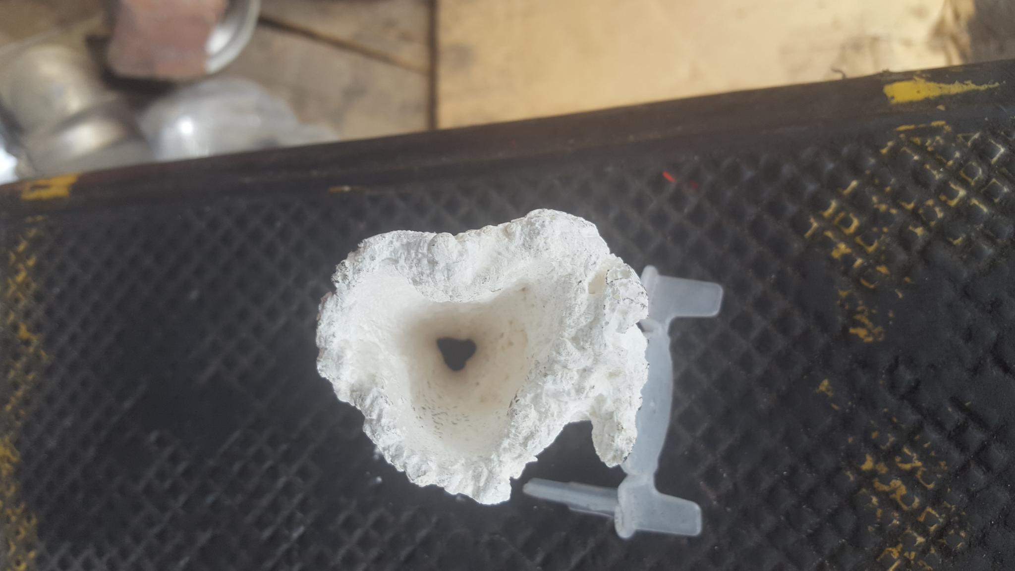

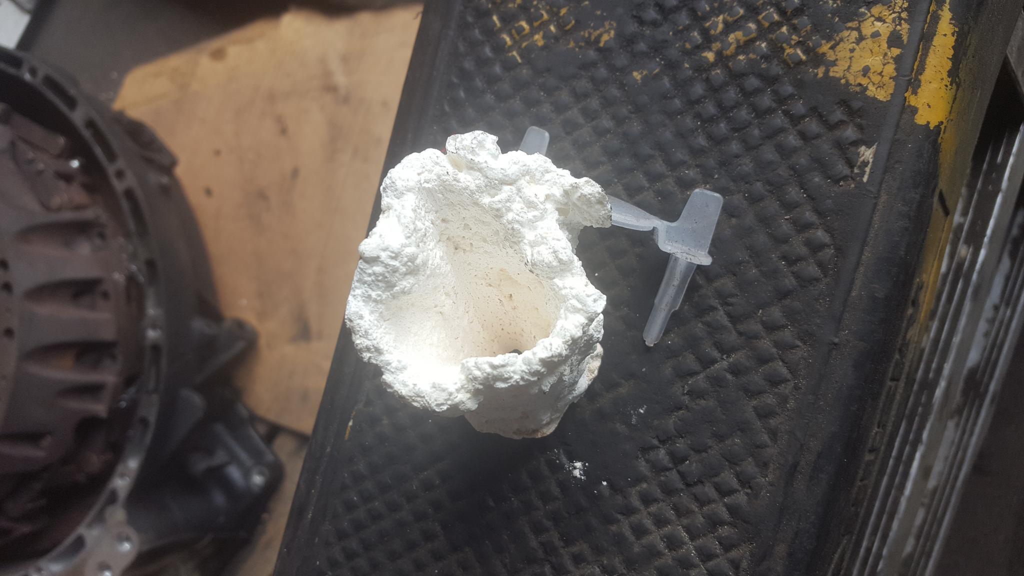

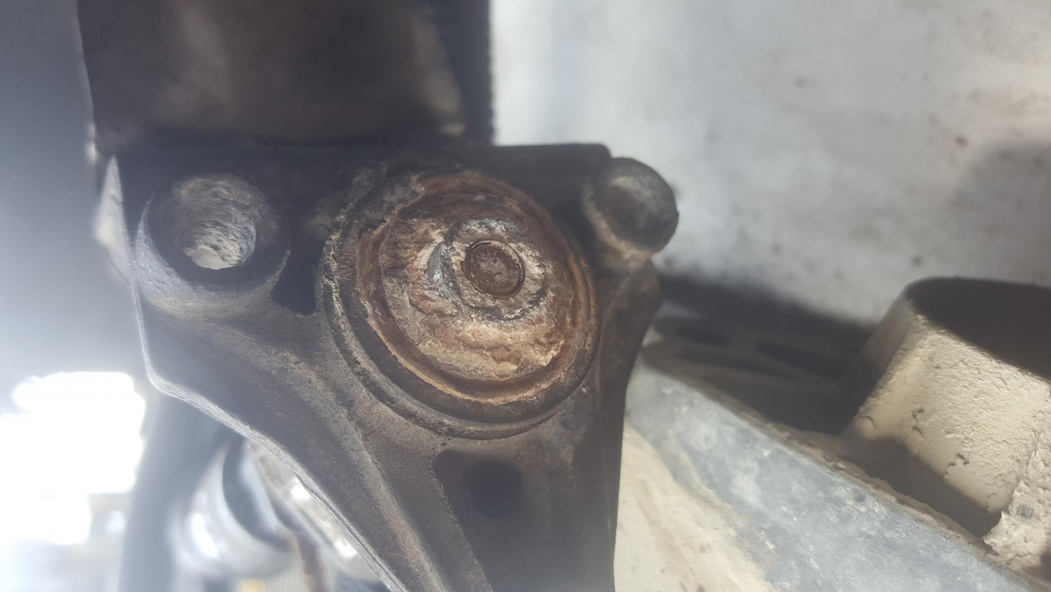

|  Look at what I found inside scr can....    Inspected doser injector and scr can because def hose was leaking and found this inside scr can..... always inspect and take extra step to inspect inside..... probably going to be checking inside scr every yr as maintenance schedule.    |  |||

|  RE: Look at what I found inside scr can....    Yes DEF fluid can and will build up in the decomp tube and cause problems   Im not sure on cummins But on Detroit you can unplug the def doser and do a regen and it will clear it volvo (im new to) you have to have vcads and do a B regen (basically it regens without turning on the def doser) to clear the system of build up  |  |||
