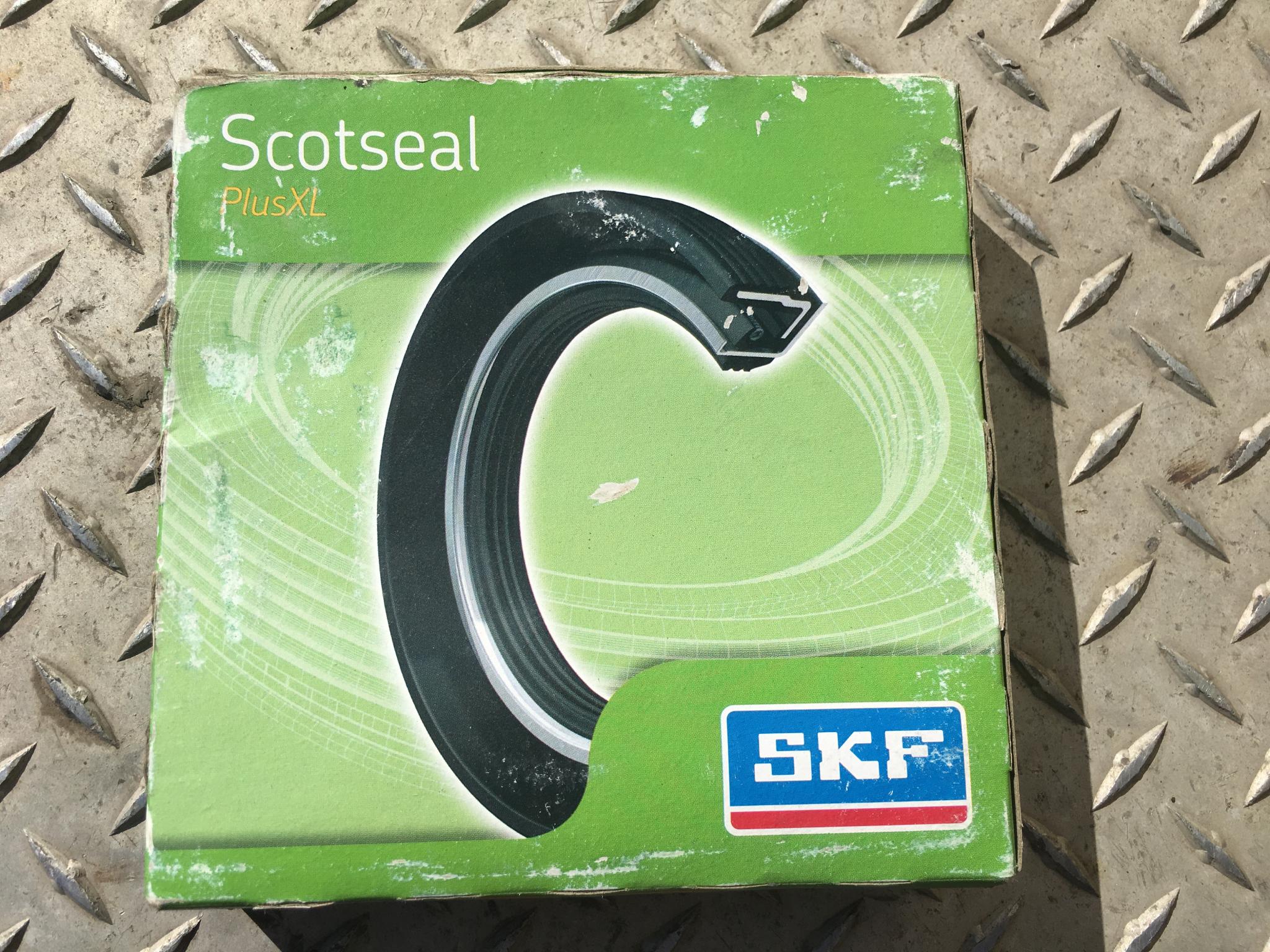

The SKF Scotseal Plus XL are what I use.
The thing I like about these is that no special driver is required to remove or install them, so I pack a couple of spares and think nothing of changing my own wheel seals while away from home because of that. That and I'm usually off the beaten path, so even if I don't wanna do it myself parts and install tools are always "in stock" cause I can supply them, very handy feature.
They'll last 400k pretty easily in long haul application.
I tend to do my steer and trailers between 2-250k as I like to change the oil due to no filtration and no real way to change the oil without breaking the seal anyway.
