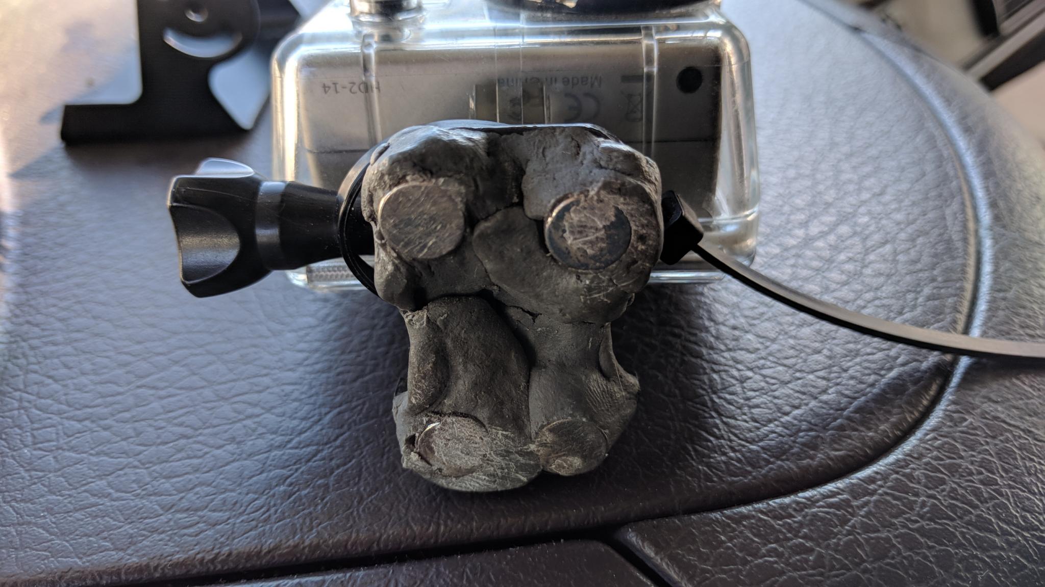

As Rawze mentioned about GO PRO. It's the best and cheapest way to find such vibrations and wobbling. keep in in mind the wobbling on the front could be from bad trailer tire or brake drum.
Here is what I did when was dealing with similar problem. Cheapest GO PRO camera with casing. Attach 4 small rare earth magnets to the casing base with QUICK STEEL epoxy putty. You can place it anywhere now and record video of wheels, drive line, engine, differentials, brakes slack adjusters. The very good option is you can hear the noise of say differential or carrier bearing.
