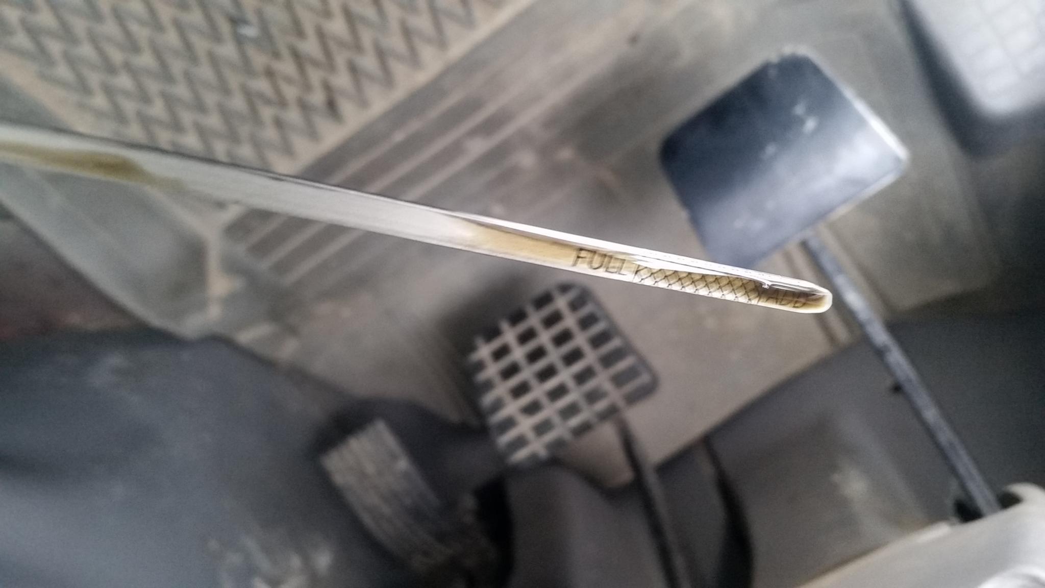

At that point, a bypass filter isn't really needed. I haul 140,000lbs and idle 4 hours a day
And still, this is what my oil looks like after 9000 miles

And I remember Rawze stating that's dirtier than he'd like to see!

(10-12-2017 )Brock Wrote:  And I remember Rawze stating that's dirtier than he'd like to see!
ahhh, actually that is about right for what you are doing.
