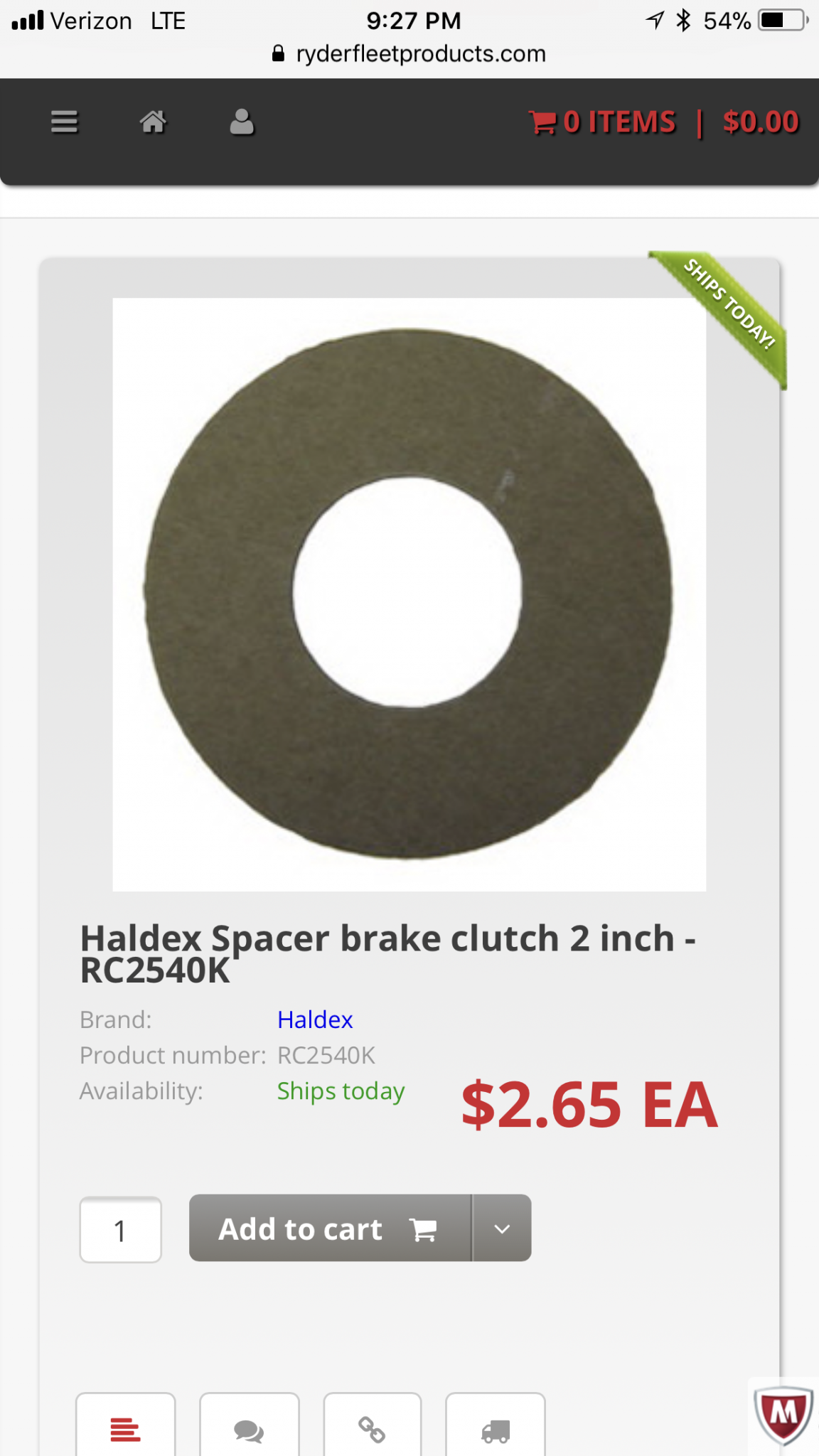

Try one of this first clutch brake spacer between the clutch brake and the transmission
10-24-2017, (Subject: Volvo clutch )
RE: Volvo clutch
(10-24-2017 )gatow900 Wrote:  Try one of this first clutch brake spacer between the clutch brake and the transmission
Cut just enough to push it on to the shaft
