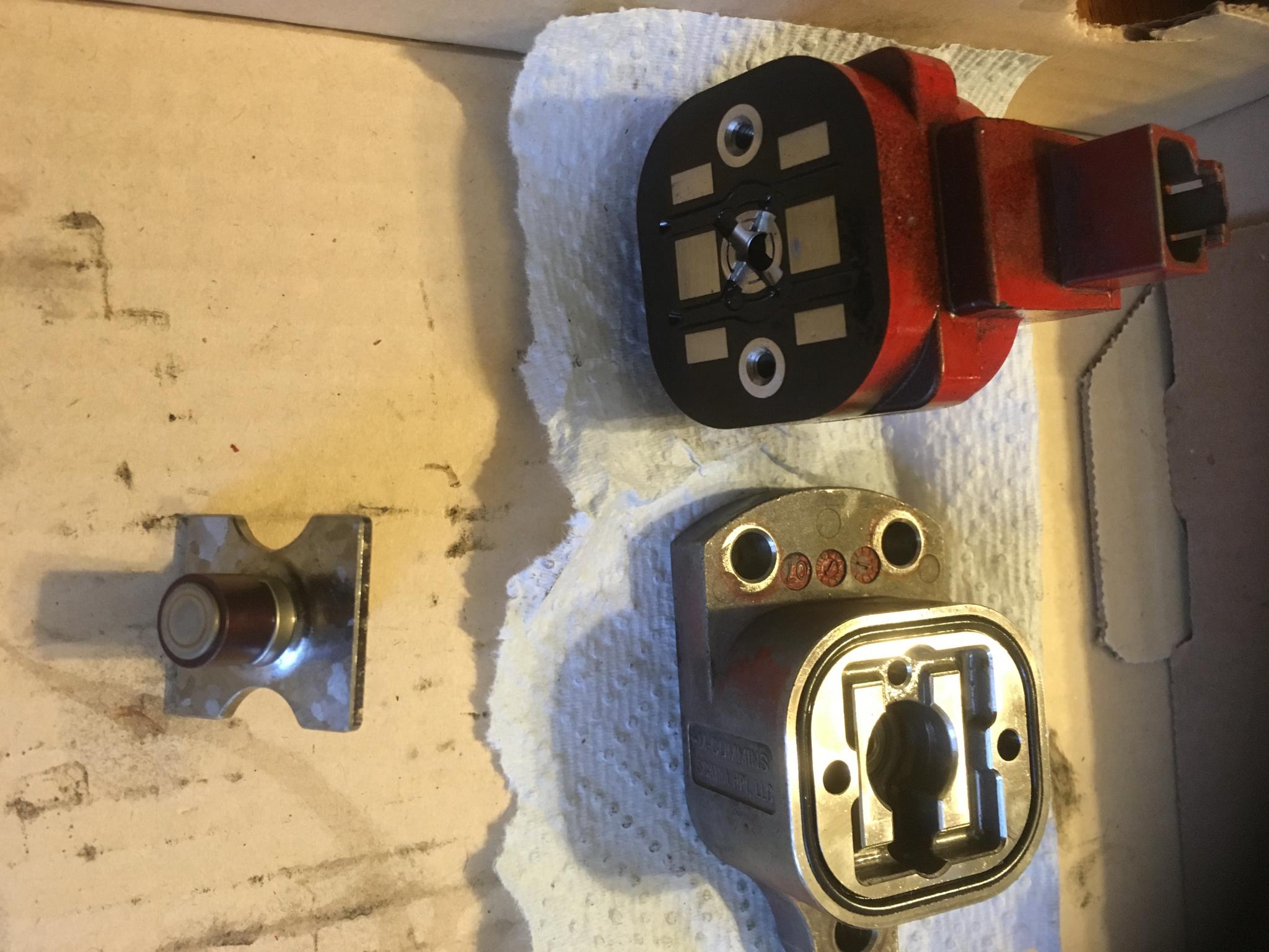

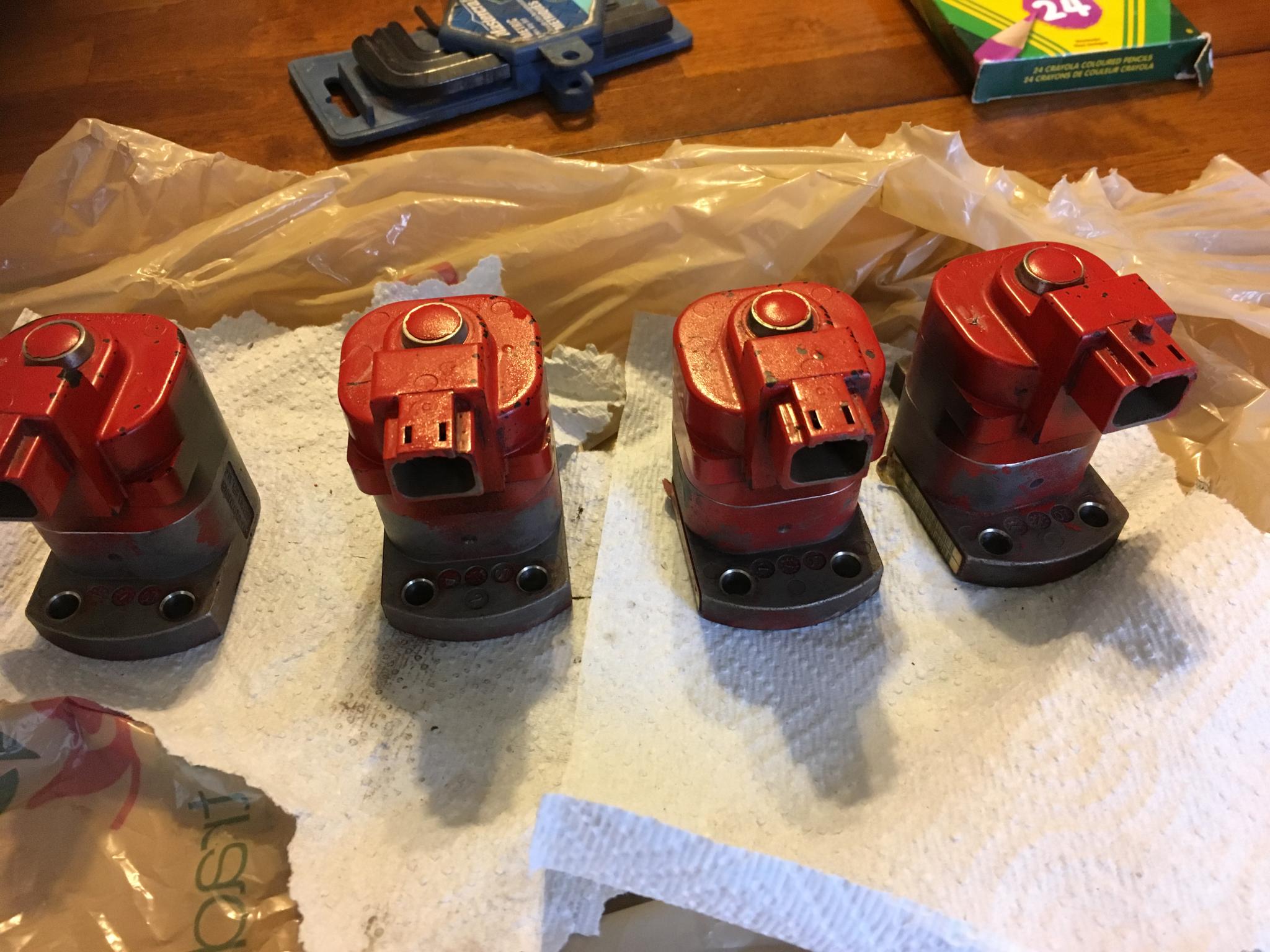

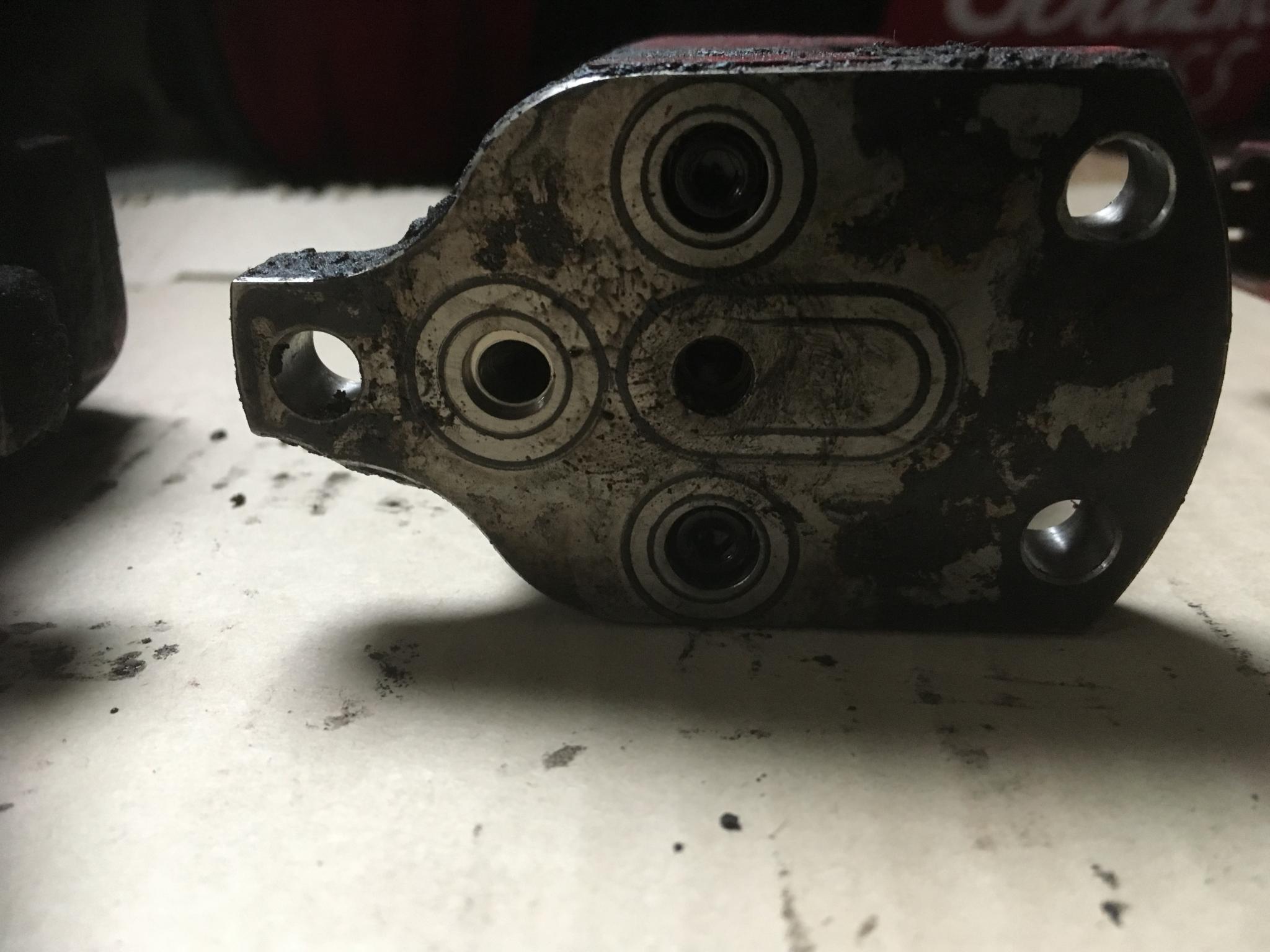

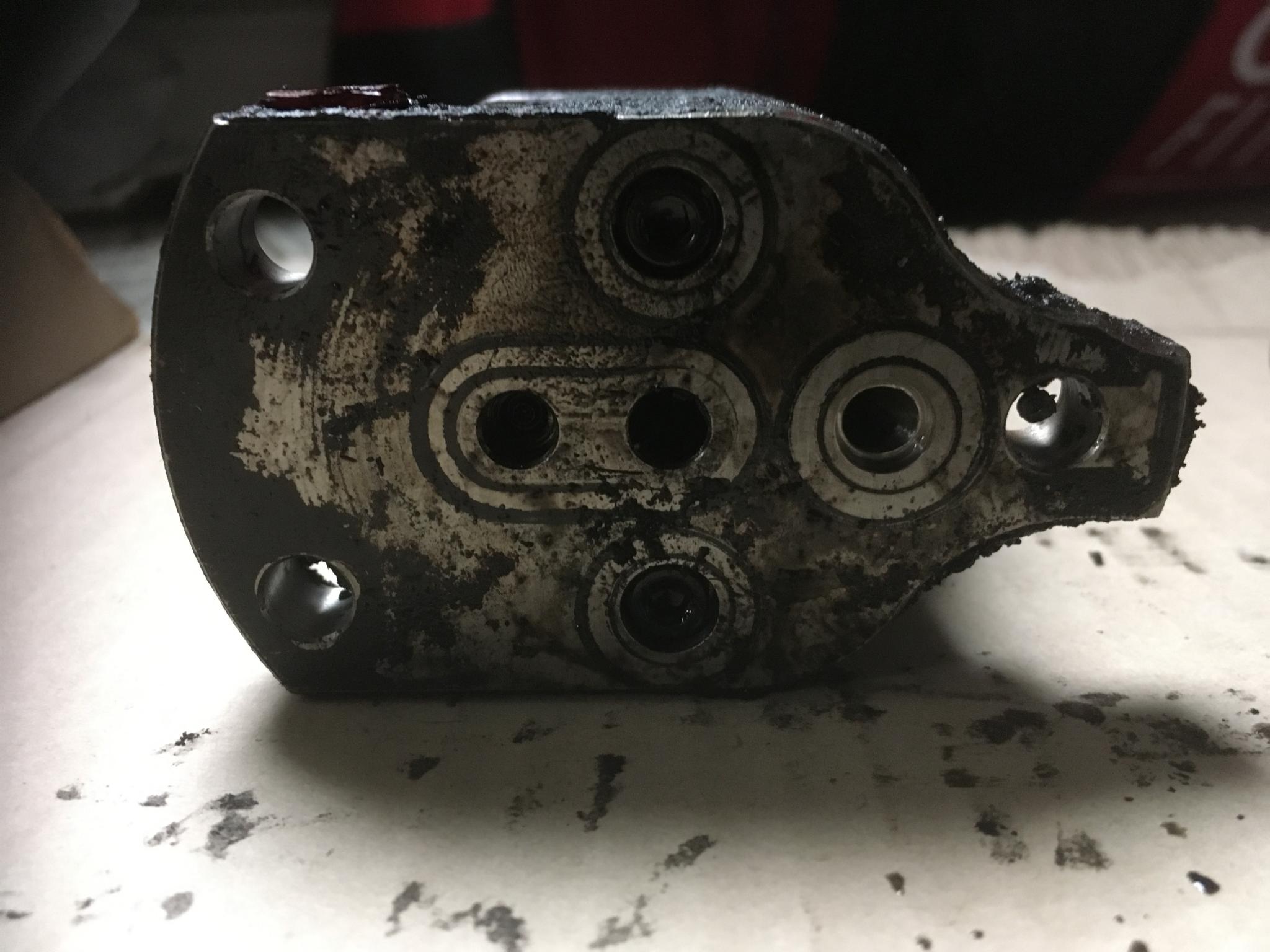

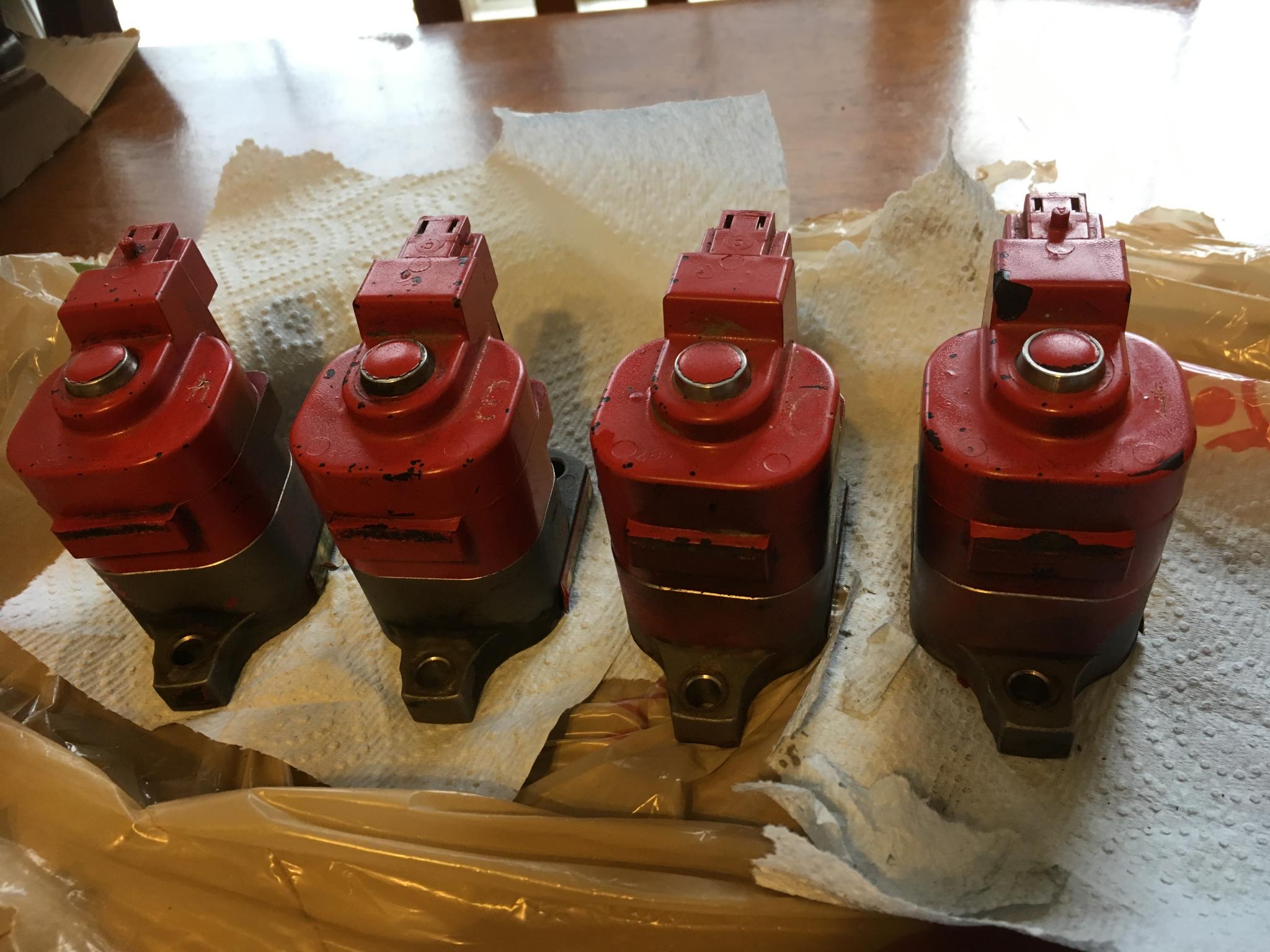

Heres what the actuators look like after removing them from the ifsm first photo is the metering actuator(3 holes) in the center and the second is the timing actuator (2 holes) in the center
 Thanks given by: Hammerhead

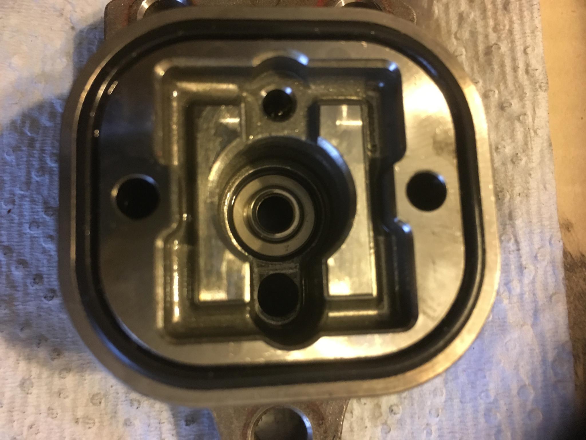

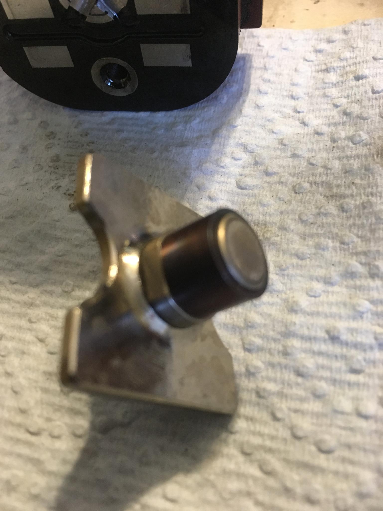

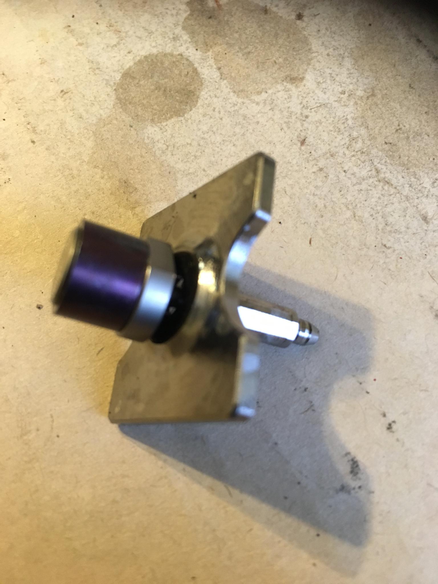

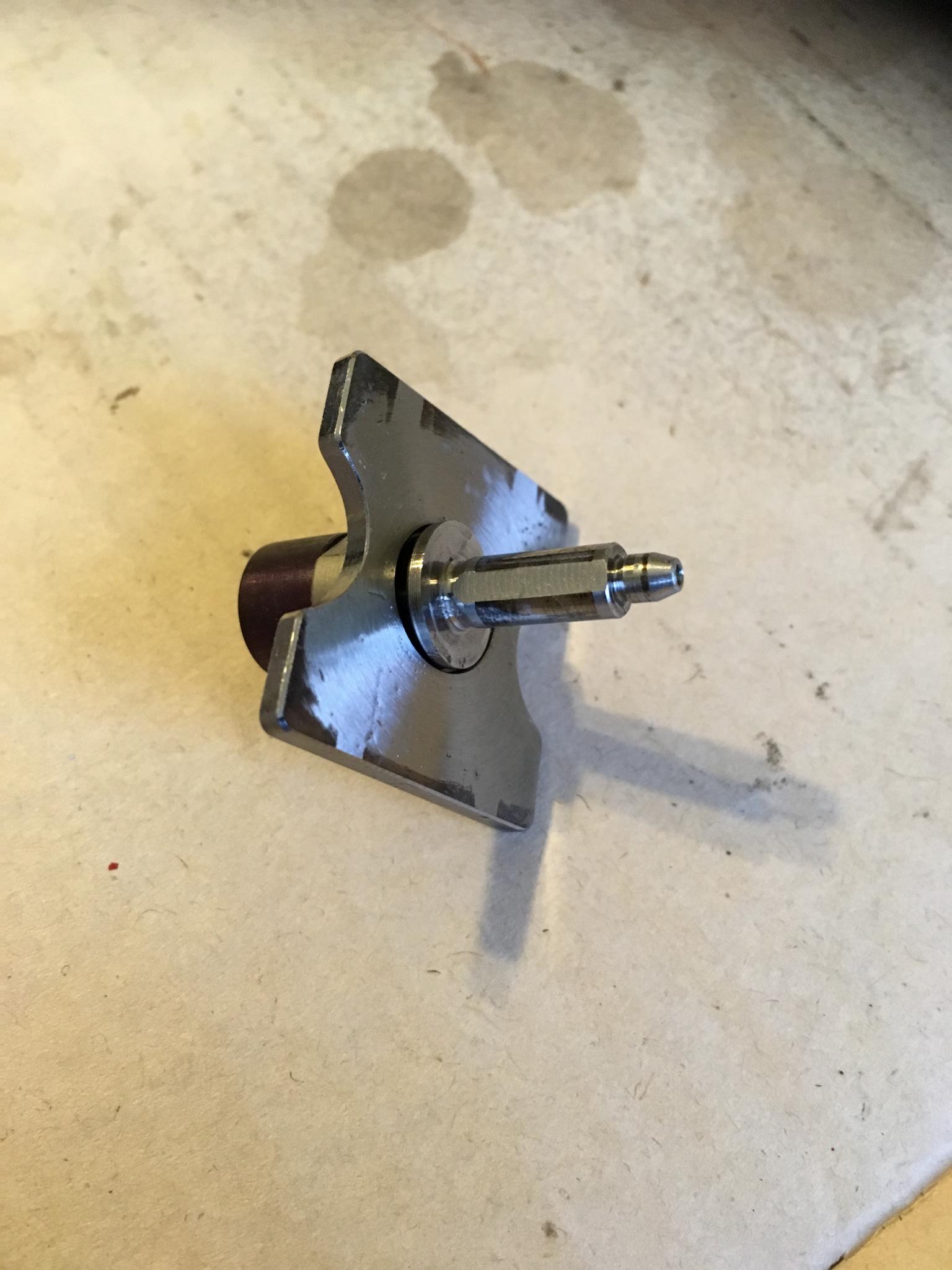

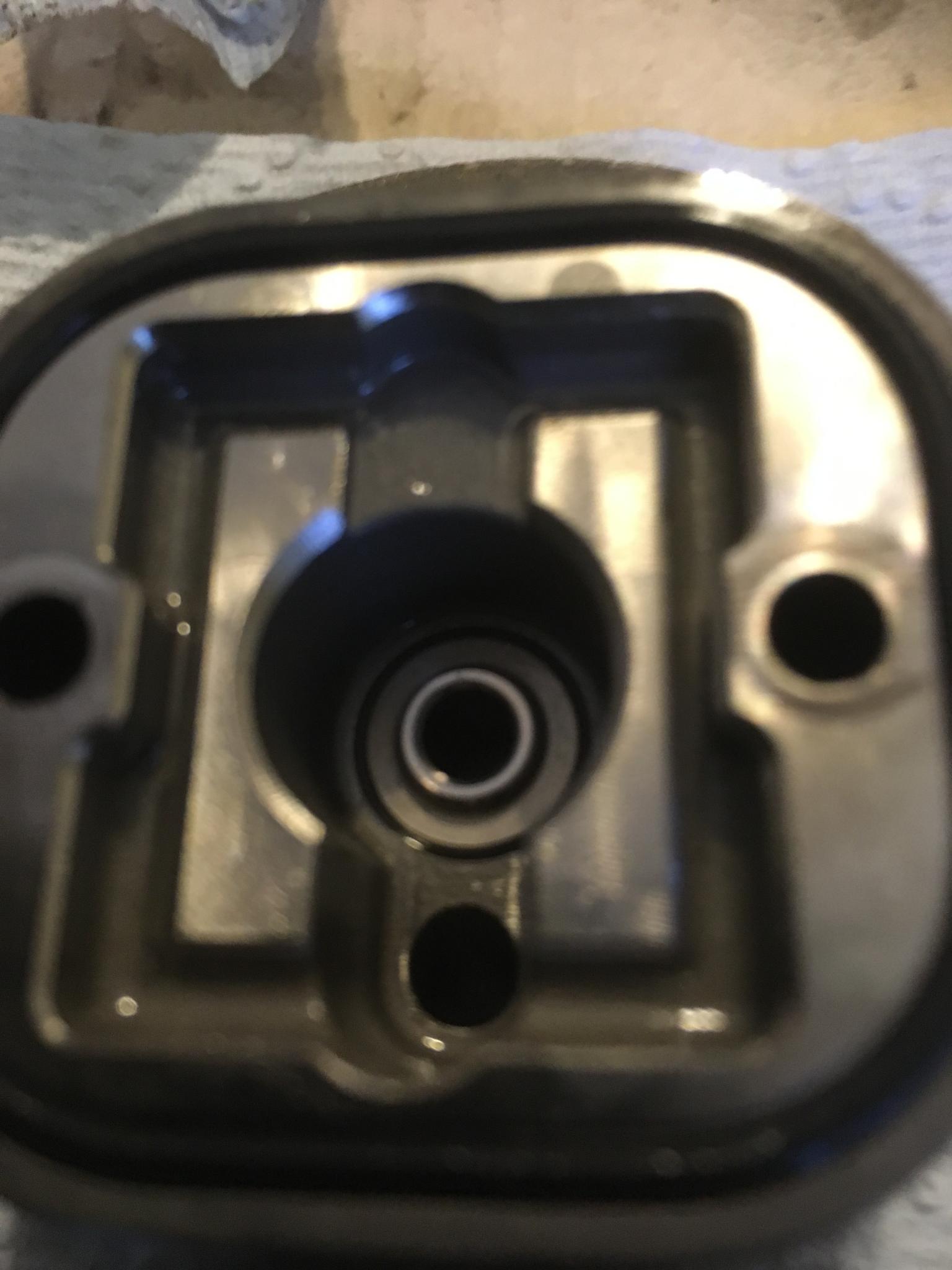

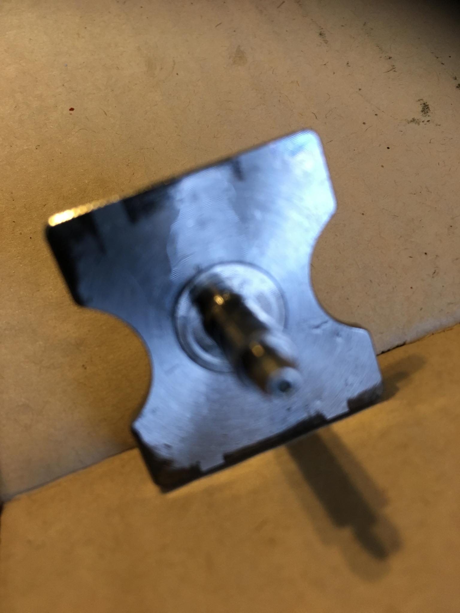

Heres a few photos of the actuator assembly disassembled and the internals both metering and timing...........so and as you can see as mentioned before great filtering = clean internals there is also a photo of the metering plate and from what i gather this is the only part that would wear out ......but as for the rest of the unit ....these solenoids are built on a military level somewhat

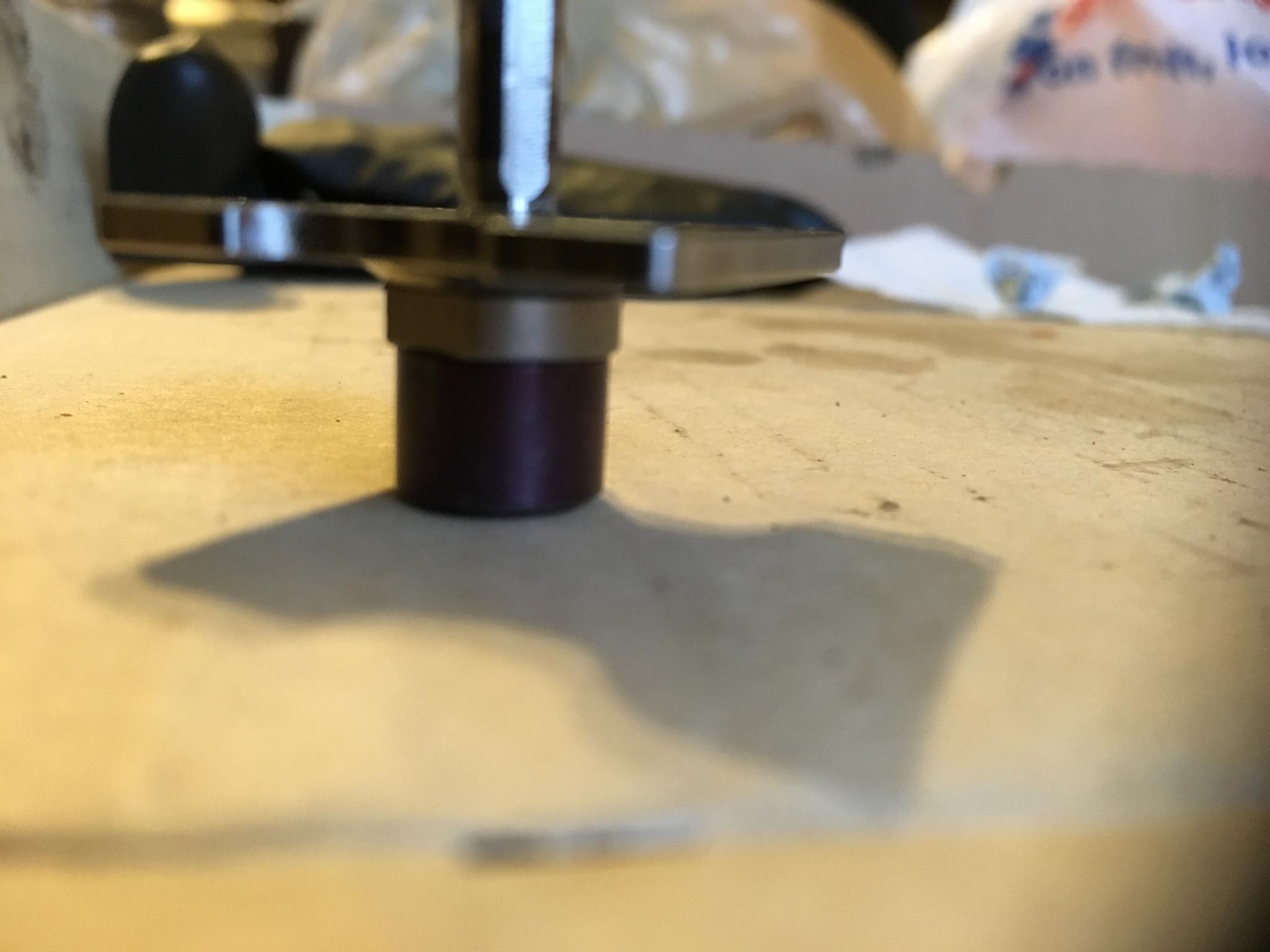

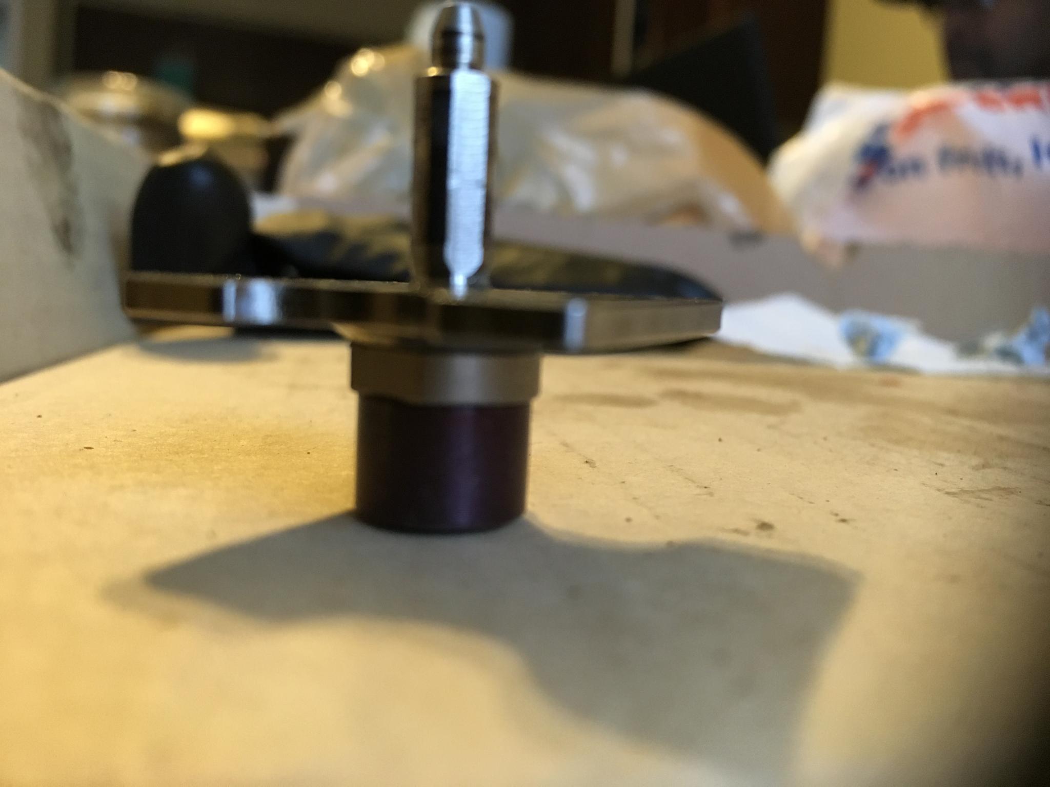

So these photos of the metering plate and what basically happens inside is this plate flutters at a very high frequency or rate allowing it to time and meter the fuel through ECM commands..... in my observation after separating these actuators the second actuator from the left side going to the right (front to back) .......this particular actuator was loose meaning the metering plate was out of adjustment causing my motor to have a intermittent lope during idle and robbing me fuel mileage if say perhaps this valve starts to separate it will actually allow the fuel to dump into the injectors and could probably lead to higher pressures in those cylinders related to the leaking actuator so what ive done is separate the metering plate to show what it looks like and what happens when they unscrew and what they should look like tightened its almost like cummins created it as a fail safe mechanism so that the cylinder doesn't lean out but rather instead it would run more rich.

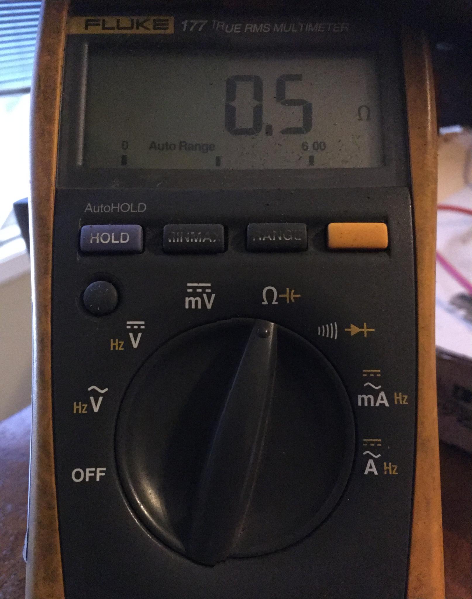

So after checking the internals in all the actuators i only found 1 loose metering plate so i tightened it ....and as for the inside of all these actuators they were immaculate i was impressed..... moving forward i put the actuators back together and did a ohm test to make sure that the metering plates were completely flush while looking in the fuel journals....... i got 0.5ohms across all the actuators. So if (1) was a bit out of adjustment the digital meter would show more resistance which would tell me that something is wrong so make note..... a fast way to check these is to do a ohm test and make sure that the numbers are the same ....if you have high resistance in any of these actuators there is definitely sludge, small debris, or maybe the metering screw as backed off a bit inside creating a situation....also i did use brake cleaner to clean the outside of these actuators and boy what a difference so cheers for now and lets keep those cummins running.....!!!!!!!
