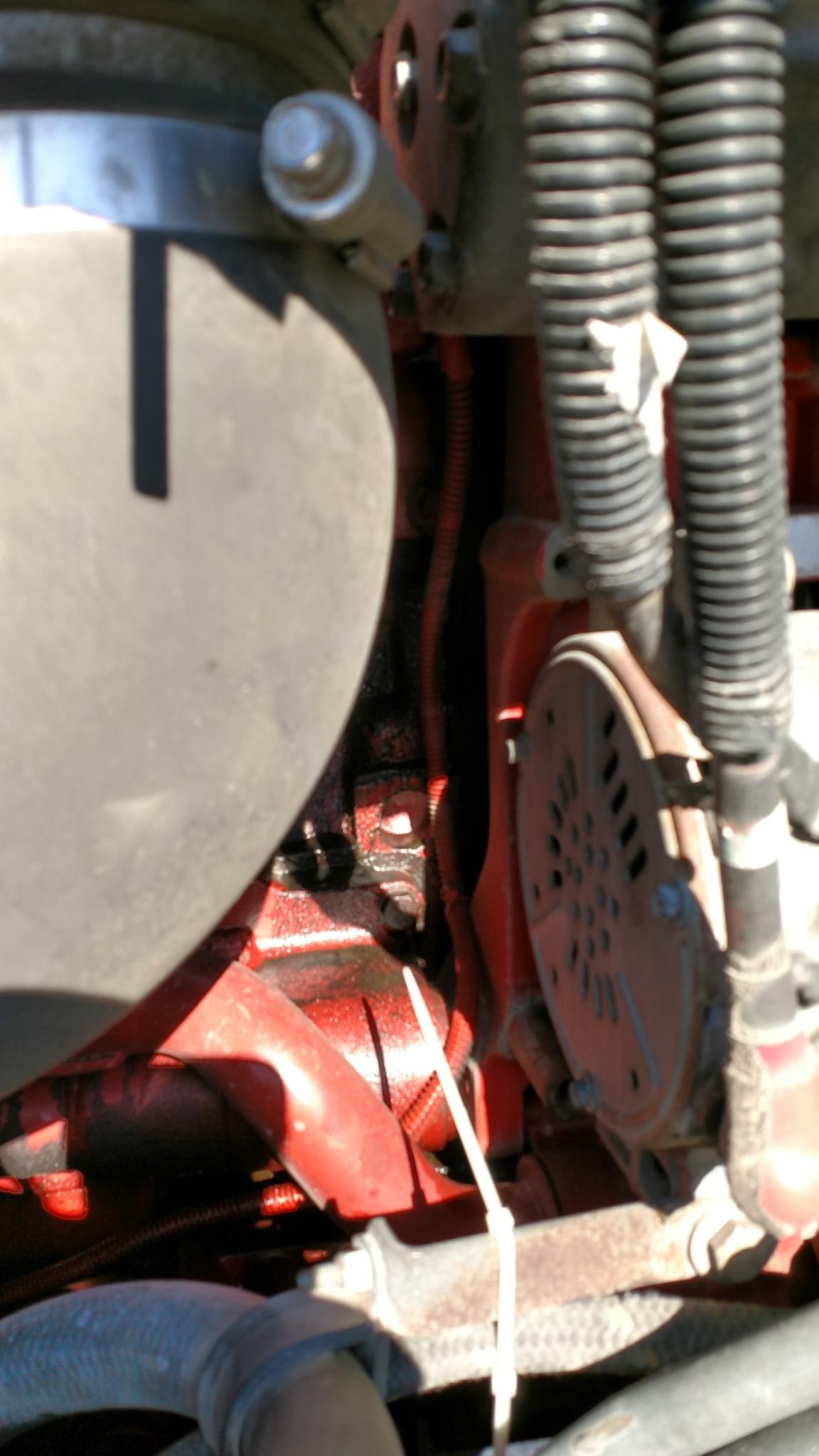

I'll upload pics shortly.

Driver front

Passenger front

Passenger rear

MY take on it is when the bearings in the head are shot,... so it the head.
Leakage down the side of the engine cover is something else. make sure the gasket is good and it is torqued properly.
