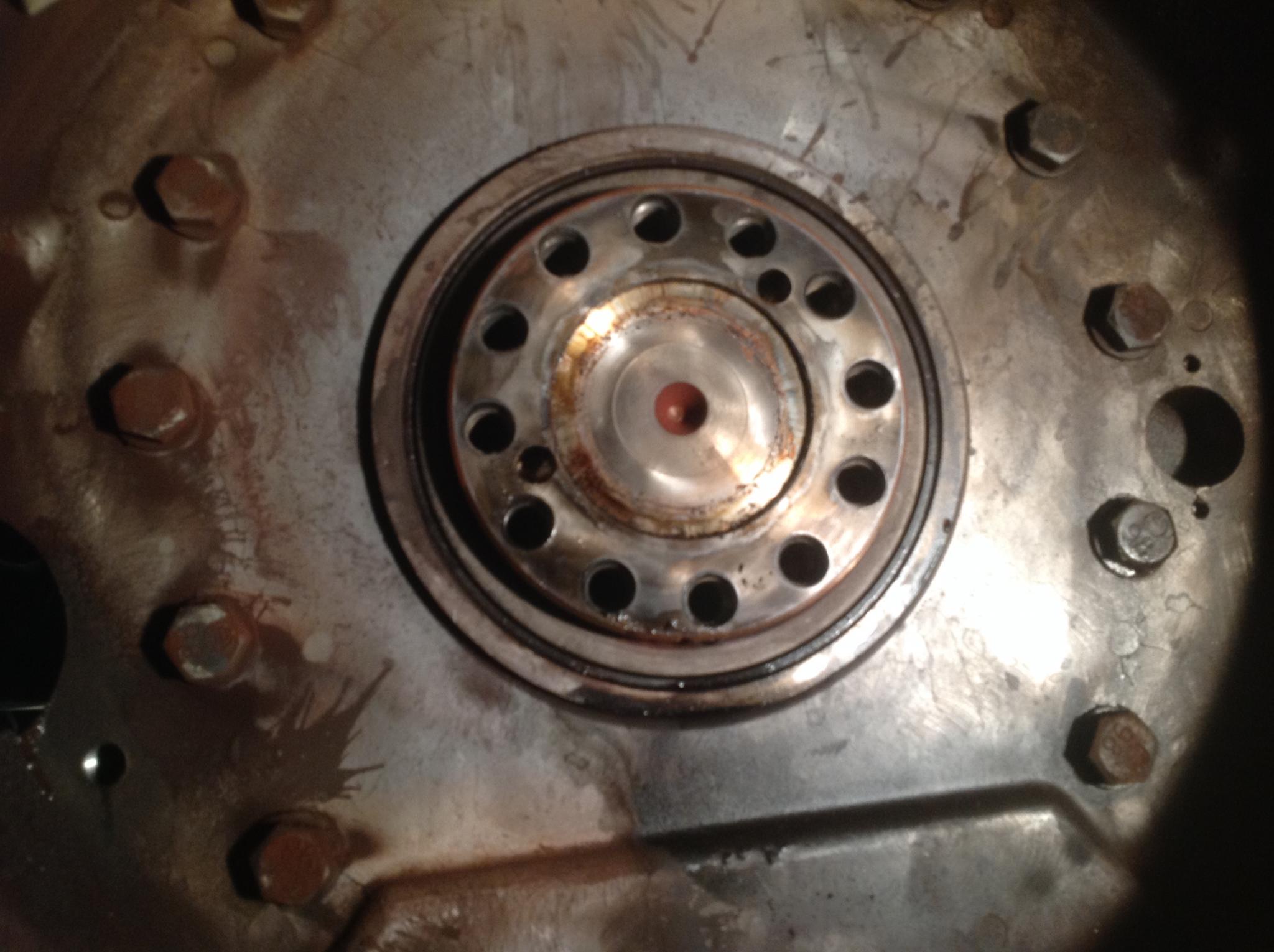

For now, as you can see the rear main seal is just starting to weep, so I'm glad I got in here now when I did.

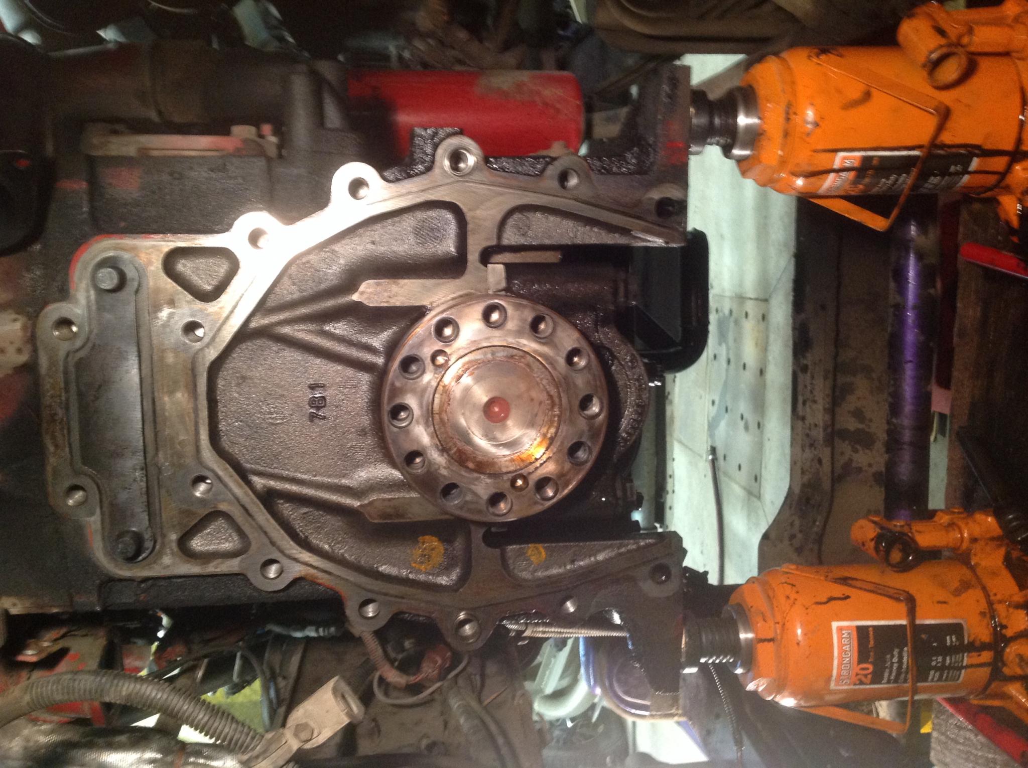

Quick question hammerhead, what did you use to jack up the rear of the motor to take the flywheel housing off? Single jack setup or some kind of double jack contraption? Also, where did you jack it up, on the oil pan flange or some place else? Thanks in advance.

(01-06-2018 )mastergregor Wrote:  Quick question hammerhead, what did you use to jack up the rear of the motor to take the flywheel housing off? Single jack setup or some kind of double jack contraption? Also, where did you jack it up, on the oil pan flange or some place else? Thanks in advance.
I'm at moms for the w/end, I'll post pics of who, what, where, and how on Monday for ya.
But 2 bottle jacks, oil pan removed, and on the flat flange along where the pan would mount with thin wood shims so it's not steel on steel.
Because I have them, the jacks are on 4' long hernia blocks* to built a solid foundation as I have the truck up on 5" of blocks at the rear and on 8" of Jack stands on the front to make more room and working underside more conducive for a fat bastard with short arms...and to also make enough clearance to get the tranny out from under the truck to service it.

Here is a pic of how I have the engine supported while I R&R the f/w housing...
The thin wood on top of the jacks is actually just a piece paint stir stick
Got back from moms today and got after it. Planned on having the new gasket and housing all cleaned and mounted up tonight...then as I was cleaning things I found something I didn't like the look of, so drug it over to the wash bay for a good cleanup.
My f/w housing is cracked to shi#t all over the place, of course I confirm this at 4:30 so it's too late to get cleaned up and into the city to p/u another one today...tick tock, this thing is just killing me time wise.
Thanks to Starlight & Unilevers for looking at my pics and confirming my fears for me...did somebody say beer?
