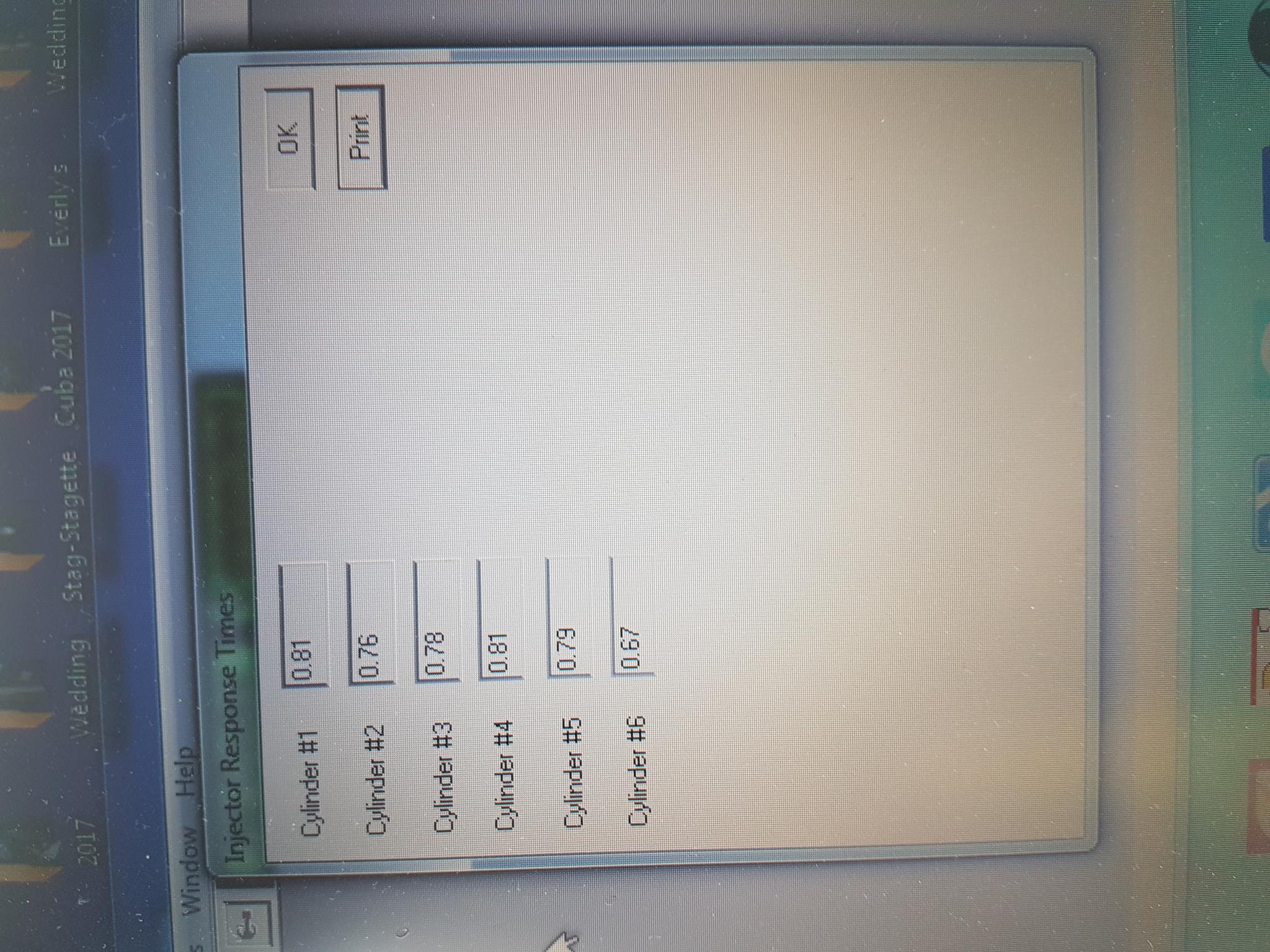

From DDDL here is the injector response time. The top 5 all fluctuate constantly about 0.02 max but number 6 stays steady at 0.67 and never budged.

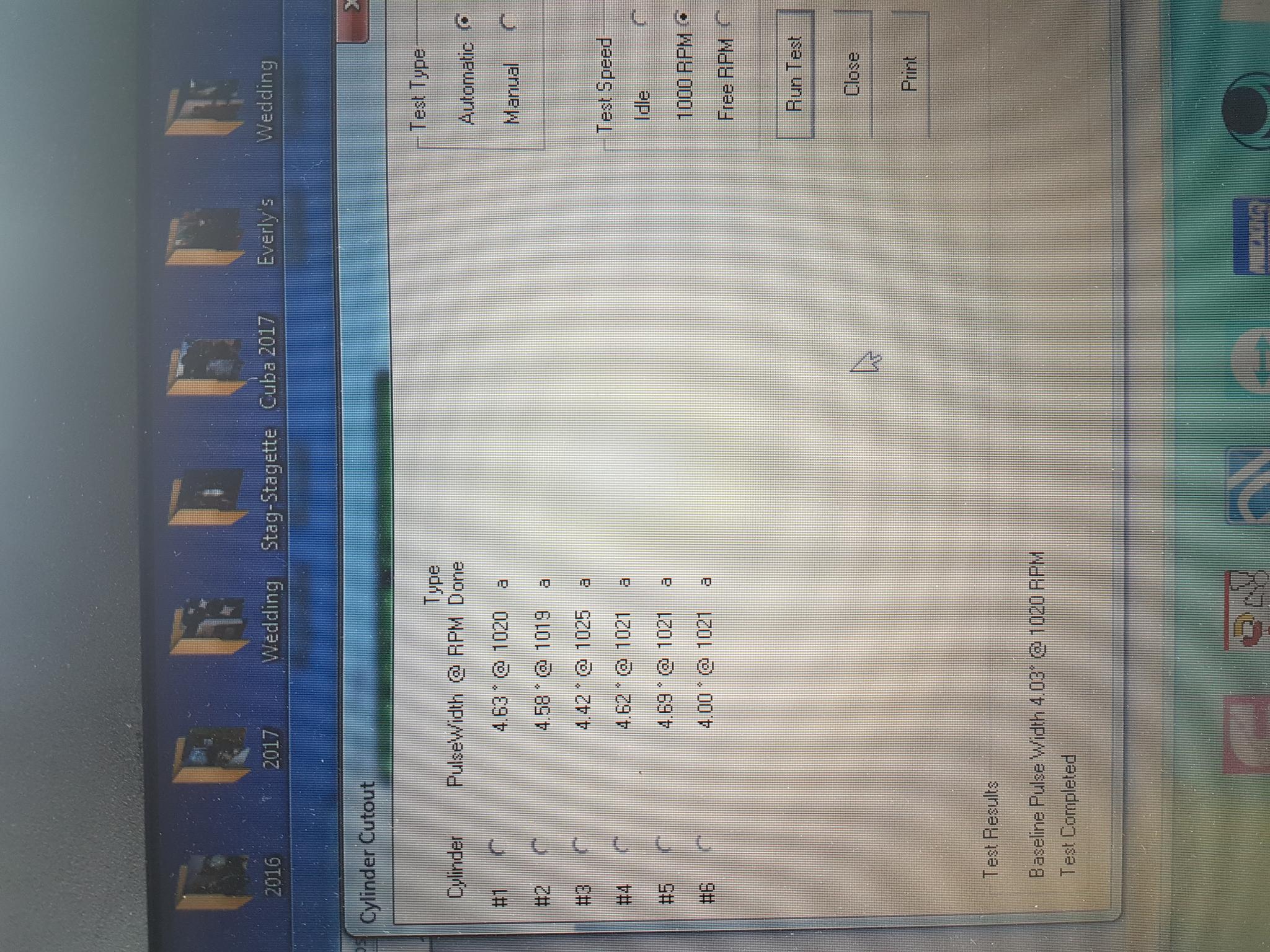

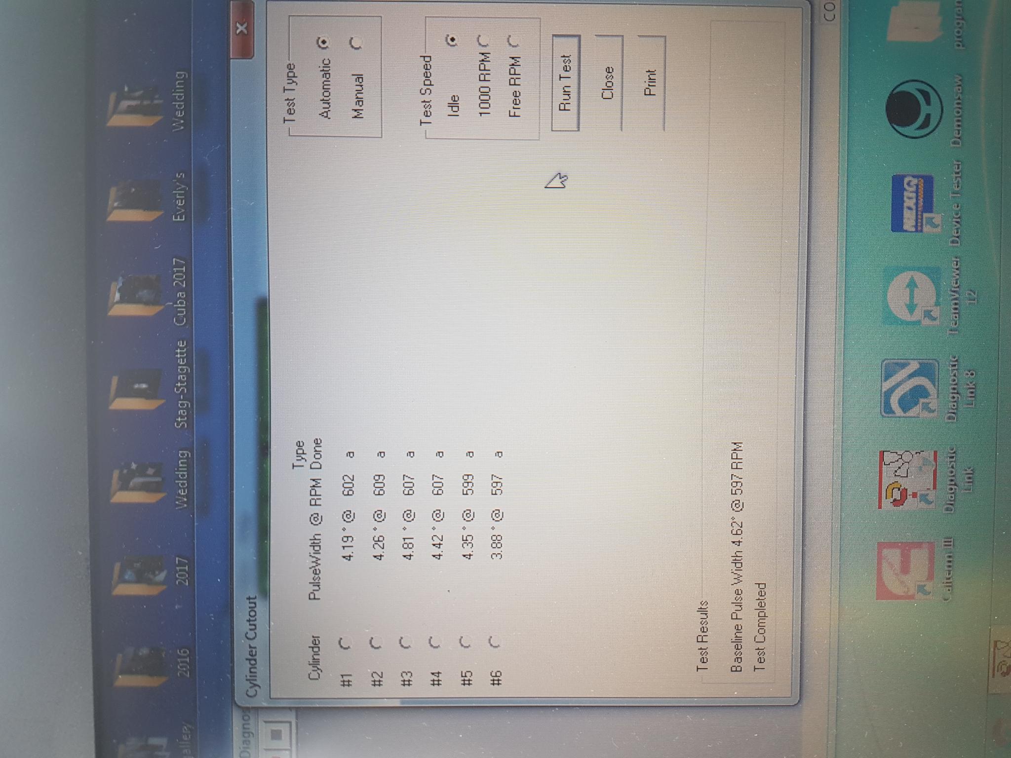

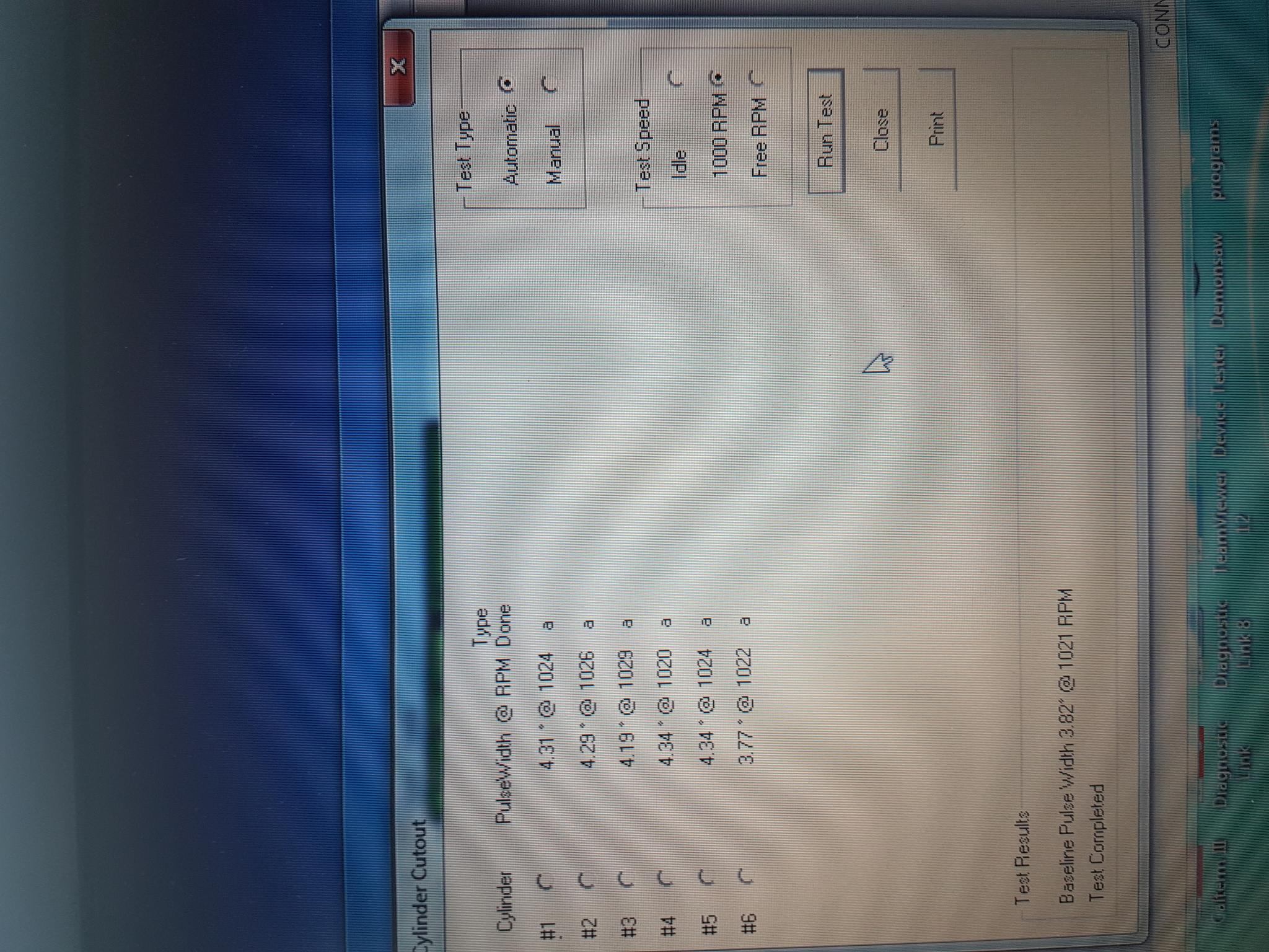

Here's the cylinder cutouts at 1000rpm and at idle. At 1000rpm number 6 is consistently lower but I don't know if that means anything. At idle it was usually the same although in this pic number 2 was low, 90% of times I ram the test, 2 was strong. 3 was iffy and 6 was low.
Problem is I don't know how much of a spread is ok or at what point is considered low. Maybe I have another issue.

That fuel churning Brock, looks to me like a failed injector. It appears to be large volumes of compression gasses released for the return line that is submerged below the fuel level.
I haven't worked with DDDL, my last S60 was a DDEC III & I have a Prolink, so I have zero knowledge of the software and didn't even look at those screenshots.
I've only ever worked on one failed S60 w/failed injector and it was totally dead. Based on what you're describing, I'm leaning towards #6, but I ain't telling you nothing I'm sure you e already figured out.

With the # being lower on the cut out test I would run it several times and if it is lower than baseline each time Id pull injector and check it out maybe looking at bad injector for sure. Or the old fashion way let it cool down all the way start it up and place hand on manifold to see if #6 is colder than the rest. Inspec the orings really good if they look bad replace all of them...

if it is less than 0.2 than your average, the injector is bad. i usually do the test multiple times to make sure but it looks like in your case number 6 is bad.
 Thanks given by: Brock , Rawze , overshot

Changed fuel filter and got the engine nice and warm, ran test 3 times and each time was similar to this.

with numbers that low i would say for sure its the injector. check the valve train and wiring while your in there but i bet its the injector

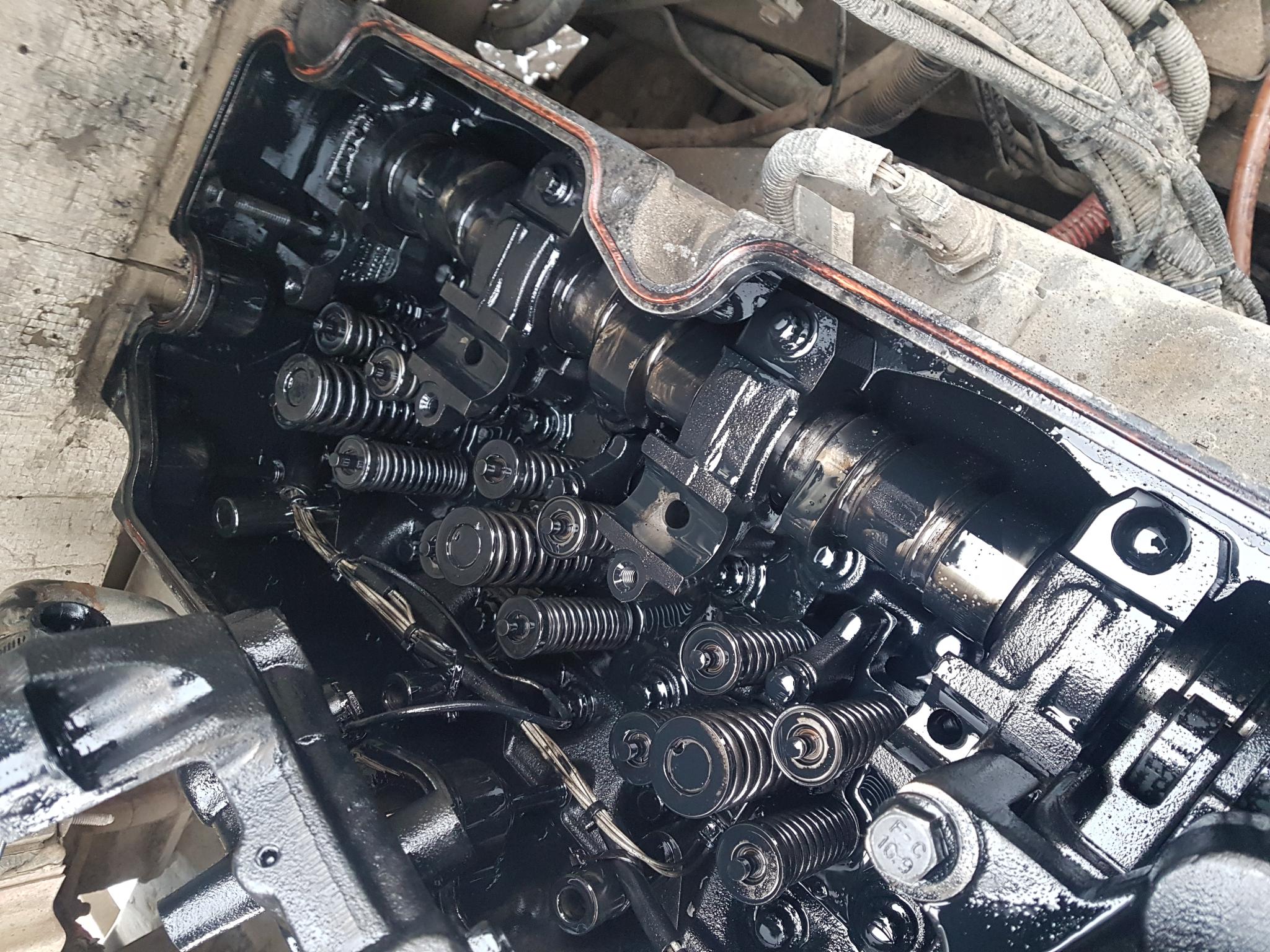

Well time to dig in. Valvetrain looks good, can't see any bad wires, gonna swap 1 and 6 and see if it follows.....

Why your in there, is it a good time to also check the bull gear bearing?
