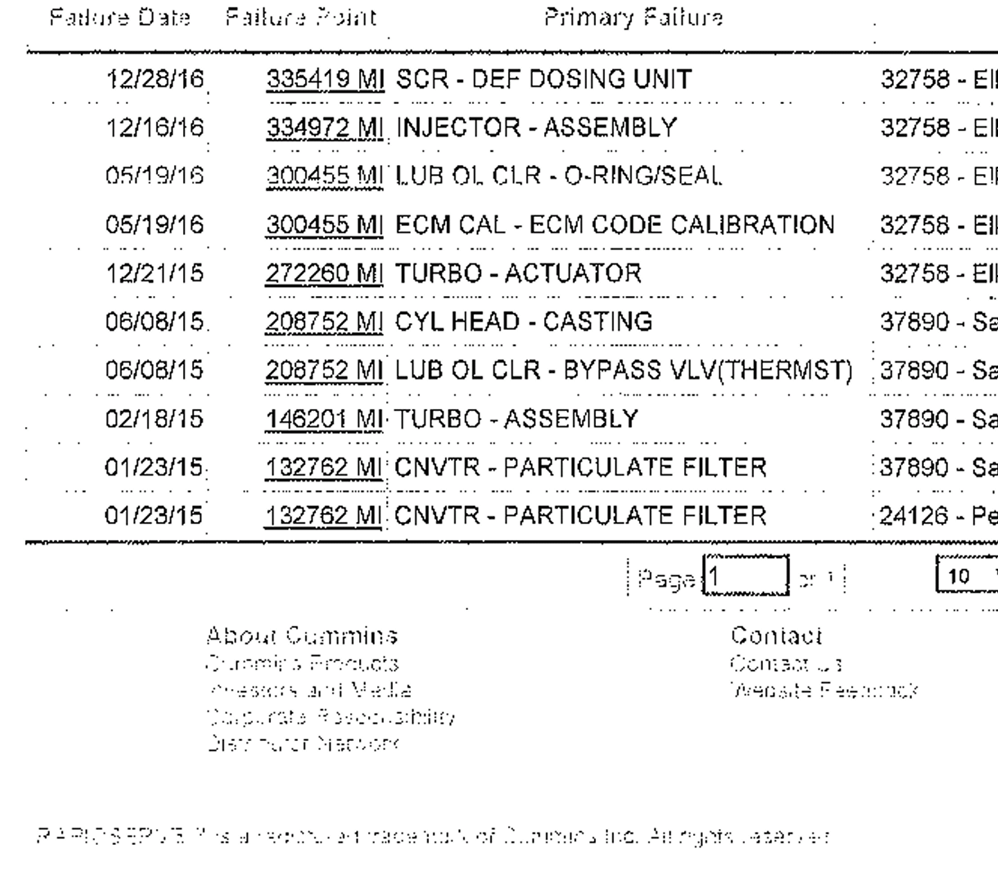

I'm in the process of trying to find a truck to buy. I live Southern California so I have to keep all the emission junk on. I'm attaching a list of warrantee work that has been done. I wanted to see if this is just what I have to expect from these new engines? I have built and restored many cars trucks and even been a service manager for local dealership. But I have never been so uncomfortable about buying a piece of equipment as I do these modern smog engines.
./uploads/201801/post_3308_1515612529_5d2f7ae97c63624ebaf845b65468f0fe.png

A turbo at 146000? and also a head at 208000?

Seems a lot of parts have been changed in so little amount of mileage. I don't see an egr cooler being swapped out. Check and see if it has original if it does plan on changing out soon. They only last 200-350k. Also check fuel pump head. 2cyl or 3cyl. Stay away from 3cyl or u will be spending like 3k for 2cyl pump conversion. Watch rawze video for buying used truck.

Looks like someone was fleeced badly at the local stealersh$its.
Where are all the parts replacements for the EGR tune-up like the sensors and Delta-P and all the stuff that causes all those problems? - Looks like you will have your work cut out for you on that one to get it road worthy again.

Lol I can't form any opinions on other kinds of trucking. I'm still new to this forum. Things like replacing the doser, EGR or sensors don't really concern me. What does worrying me is the issue with the cups in the head leaking and the overhead being starved due to sutt and damage to the cam. I think I've watched most of Rawze's videos and It makes me feel like all these engines are prone to failure. I don't feel like I can buy one of these engines without pulling the valve cover. From the outside how can I tell if a cup is leaking? Every one around here is saying don't buy anything earlier then 2014.
