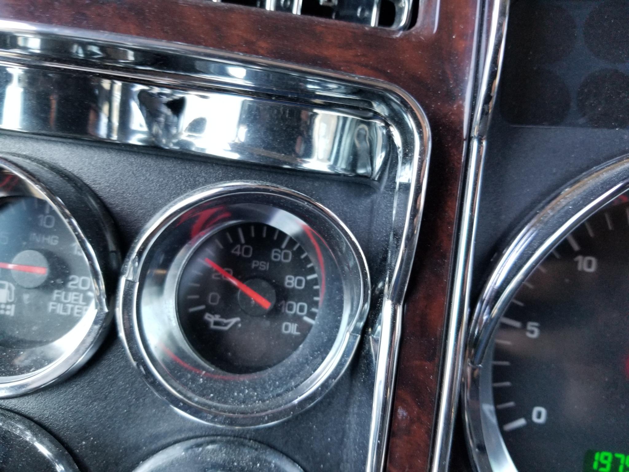

01-21-2018, (Subject: CM871 oil pressure ) Post: #4 | |||
RE: CM871 oil pressure This is what the psi shows @1400 70mph | |||
01-21-2018, (Subject: CM871 oil pressure ) Post: #5 | |||
RE: CM871 oil pressure That's not good. Y are you still driving it? | |||
01-21-2018, (Subject: CM871 oil pressure ) Post: #6 | |||
RE: CM871 oil pressure Yep running fine no problems no low oil warning lights. 6.6 mpg 79k gross. No power loss and oil level is full and oil psi is at 25 now lol idk if it blows it blows I'll just slap a new motor in here | |||
01-21-2018, (Subject: CM871 oil pressure ) Post: #7 | |||
RE: CM871 oil pressure It's not good... What's the oil temp at speed when it's that low. Rawse is right on here. I have an 871 with 840k and it doesn't drop that low at speed. It idles that low when hot. If you let that go into an oil related failure you will be paying the core charge for the ventilated block along with the motor cost. This isn't an N14 or cat.... | |||
