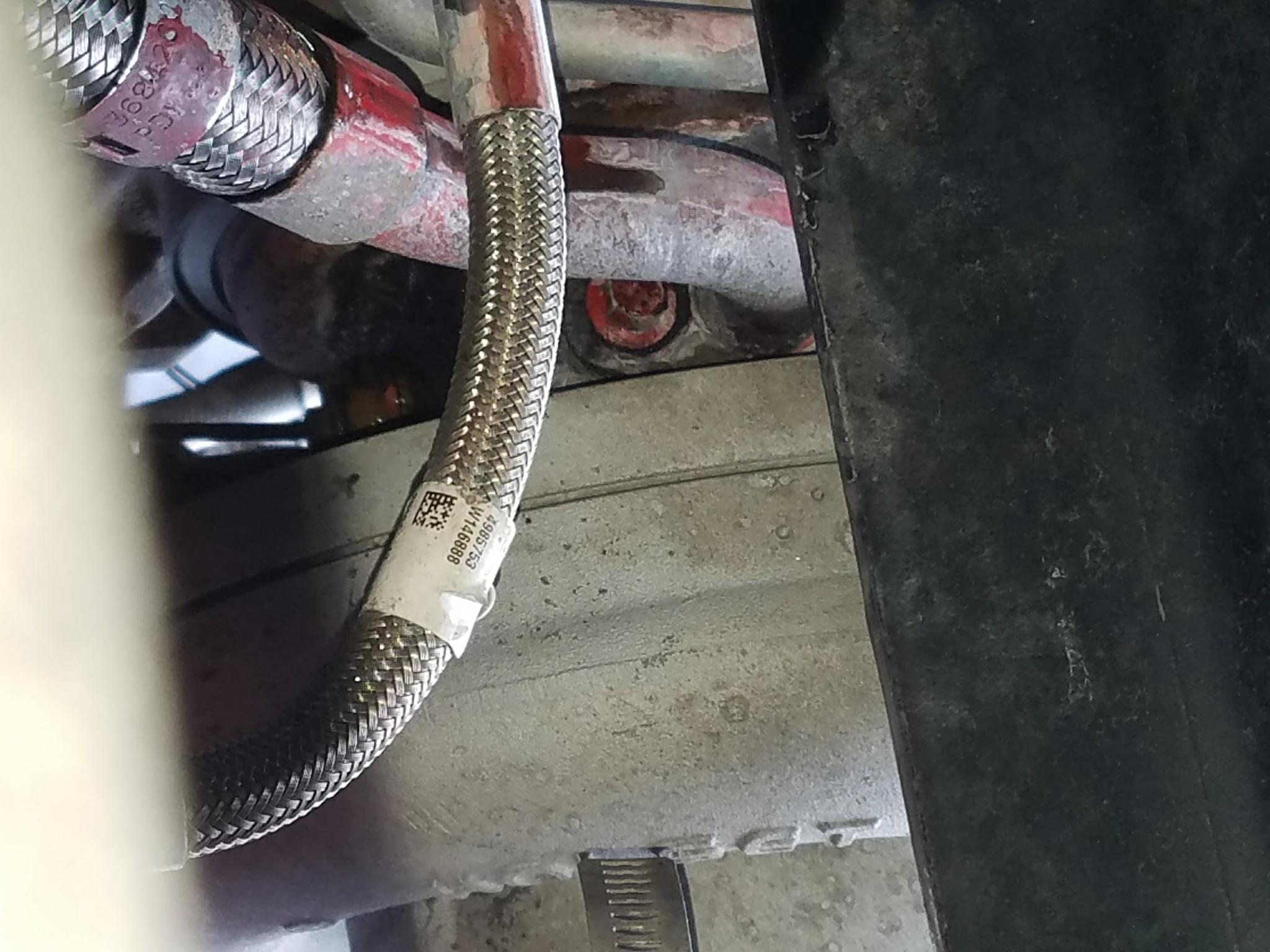

I have a serious coolant leak around the turbo area that I’ve been chasing for a while. I’ve done a pressure test on the system and can make it leak but I just can’t tell were its coming from. The coolant is flow on the bottom of the turbo oil drain line; I’ve replaced the coolant line and sealing washer that goes to the VGT thinking the line was the issue. It’s losing about a half a gallon every 1000 miles and making a big mess. I know the salt doesn’t make things easy to see. Any ideas??
Thanks

More pics of the turbo area? Hard to see the wet area in that picture.

You should not rule out the turbo actuator itself leaking. I have seen many of them do this and the coolant seeps out from around the base and down along the turbo exhaust housing. The very first picture you posted point to this being a possible cause.
There is also a freeze plug in the top of the turbo betwen the turbo and the actuator. They will sometimes start leaking there too.
Either case, you have to remove the turbo actuator and check for coolant seepage in between the 2.

It was the O-ring on the male union ( the one on the actuator side) that goes to the actuator and coolant line ; the union was also loose too but the O-ring was split. Thanks for all the help.
