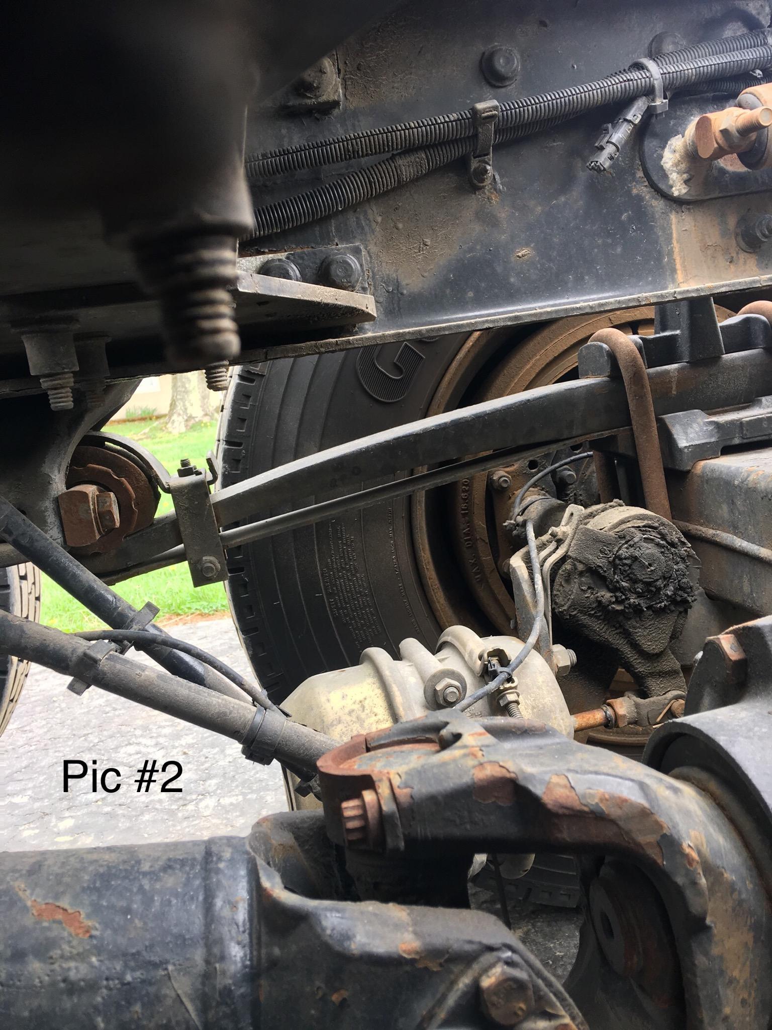

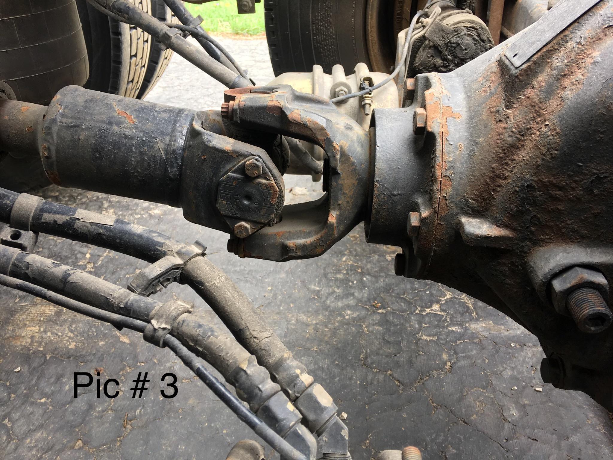

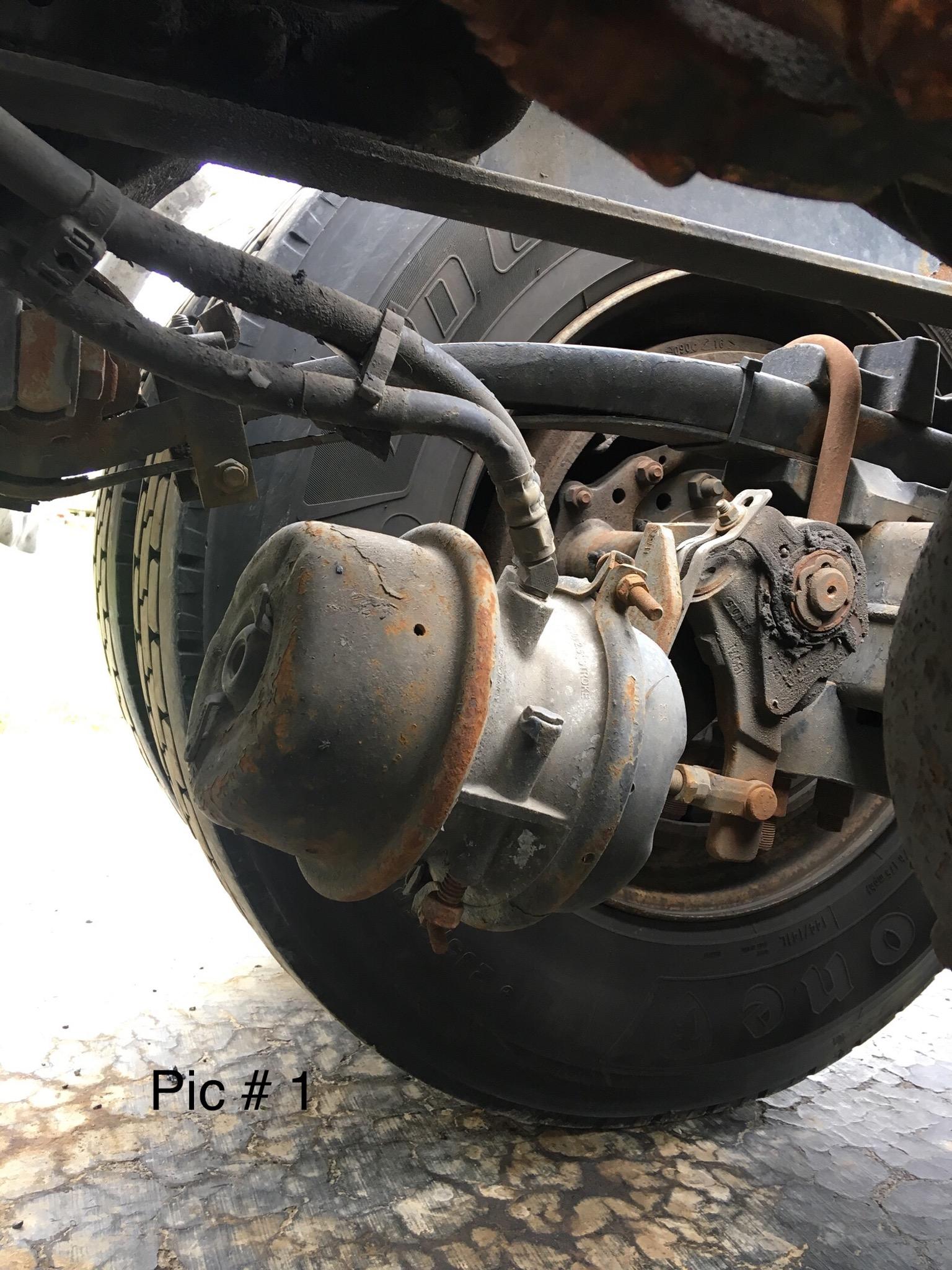

Thanks Rawze
Picture number 1 is front axle
Number 2 rear axle
And 3 rear rear yoke

I think you are right the spring that is on your front axle should be on the rear axle. You can Google leaf spring for peterbilt low air leaf and diagrams of suspension will come up from various web sites. You can also Google peterbilt low air leaf rear cut off and salvage yards have them for sale with pictures I looked at some and they all looked like spring with the bigger arch goes on rear axle if you had all 4 springs replaced looks like yours are opposite. I had a peterbilt with low air but was old style yours is new style like 2006 and newer Kenworth also uses your style I have peterbilt flex air kenworth also uses this suspension

Yes I was right
The guy at the shop had. Put rear rear spring leaves on the front and frornt for rear.
The slight bow shaped rear rear spring would make the axle to rotate upward and making the yuke inline with enteraxle drive shaft.
Since he put rear spring for the front there ewas a mis alignment to both drive shafts and since the drive shafts and yuke wee rotating at different speed so that f.. noise was traveling up to the front and heard in cab plus unusual vineration.
