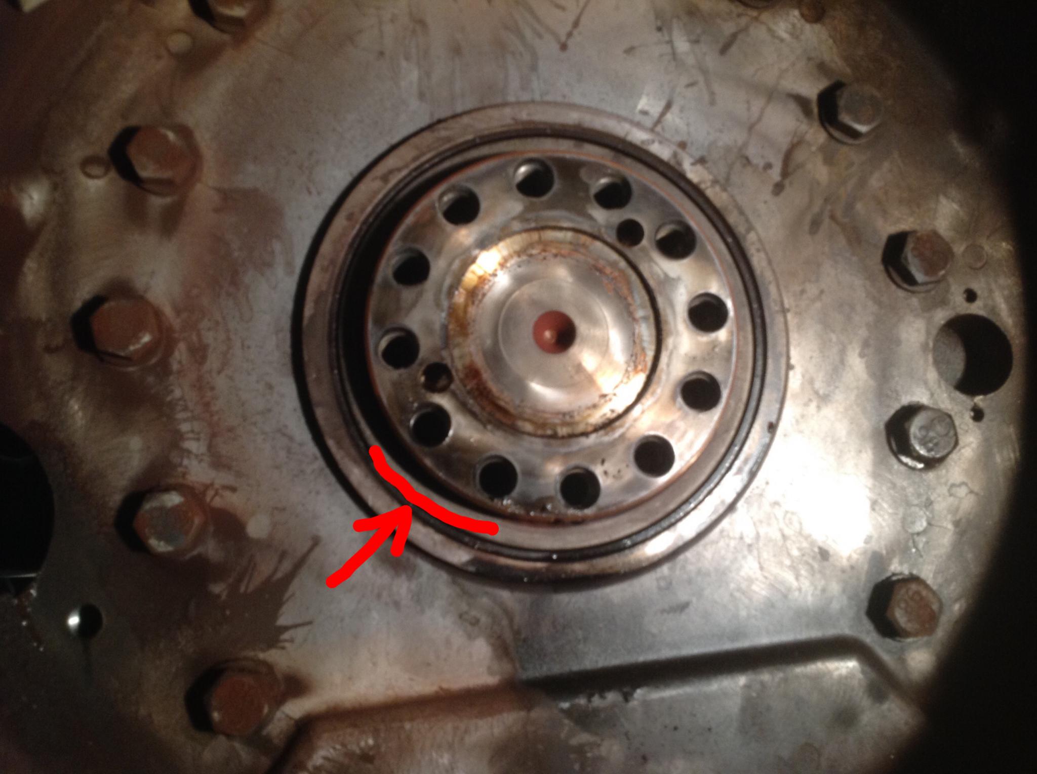

DO NOT DO A CLUTCH JOB AND NOT CHANGE THE REAR MOTOR MOUNTS!!!
They're right there, so do it. At >400k miles they are done. They may not be toast, but their best service life has been used.
I would also do the rear main seal. It is the very next step after removing the flywheel to resurface it. You wouldn't wanna have to redo this job in a year to change that seal now would ya? The seal is marked in the photo...why wouldn't you change it when you can? The seal is only about $100.
Those are the things that IMHO {in my humble opinion} should be part of a clutch job without question.
I would strongly consider replacing the flywheel housing gasket while you're in there as well. This is going a little bit further and not a must IMHO, but certainly a consideration. Disturbing the back end of an engine of that age, even with low mileage, may cause this to start leaking in the next year or so...
If you're paying someone to do the work for you, as much as this adds to the bill, it removes the possibility of a repeat bill in the not to distant future because you tried to save maybe a grand...
