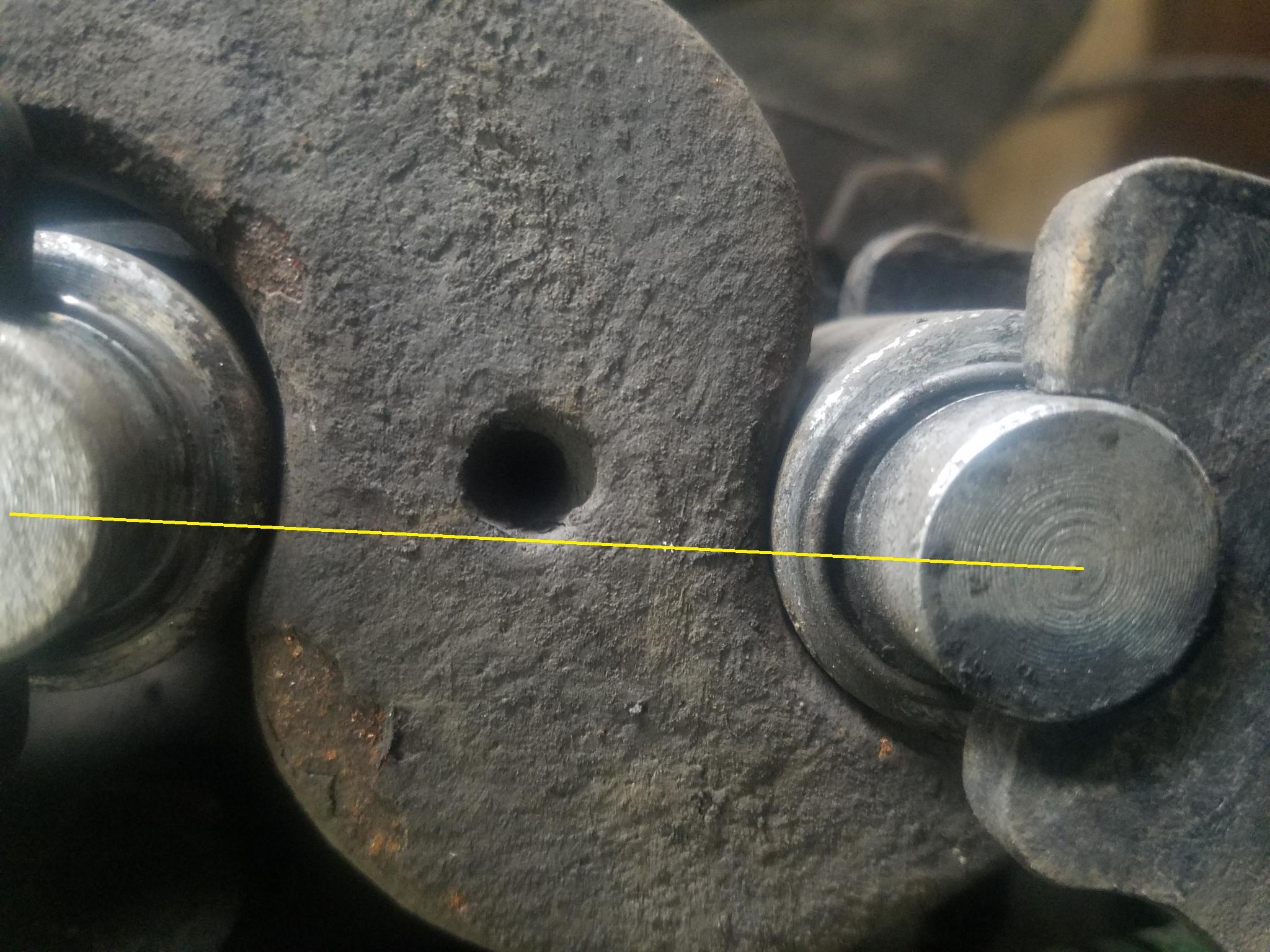

I got busy yesterday but this is what I should've posted. From the picture you posted which is not a great angle, it appears the rollers are riding off center of the s-cam. if my pic is correct, I'd take a good long look at how that s-cam is mounted.

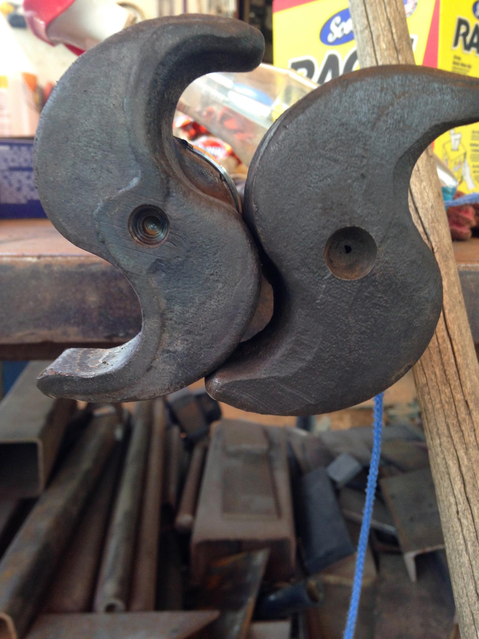

   while it seems that you have found the problem to be bad new shoes I thought I would post up a pic of 2 s cams both a standard and an extended service you can see the difference that was being discussed. I am upgrading the brakes on 1979 pup trailer all new S cams, weld on new cam tubes, long stroke chambers, center fuse drums, extended service shoes,slack adjusters,zander windows,ect nothing will left of the old stuff.
