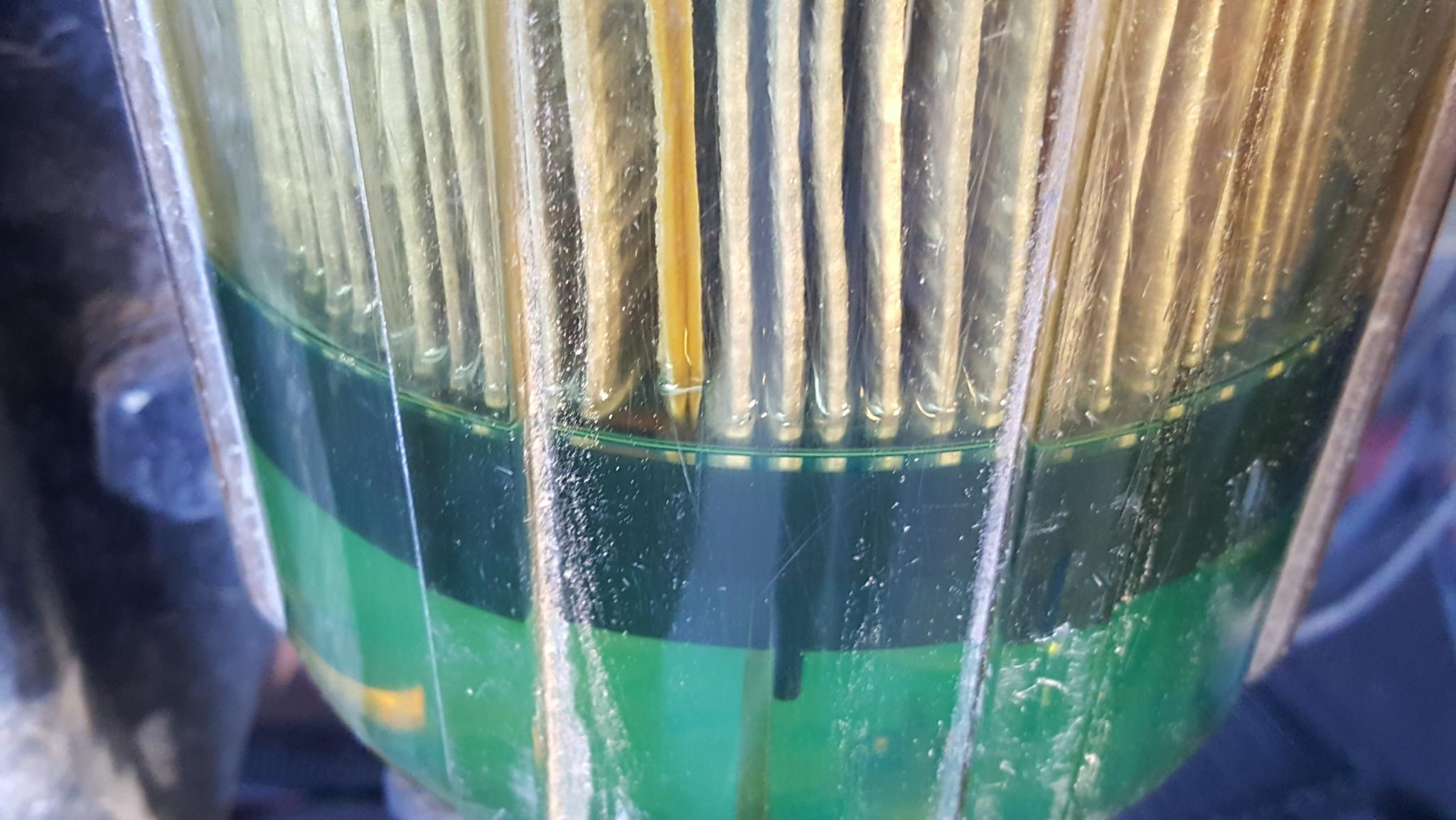

I have a 2013 Peterbilt 389 with an ISX15 cm2250. It has the PACCAR fuel water separator on the frame. The fuel level in the housing fluctuates. Awhile back I removed the fuel line on the inlet side of the filter to check for a blockage there. No fuel at all ran out of the line. I haven't had any issues with hard starting or cutting out. Sometimes the engine doesn't feel as smooth as others. Any advice what the problem might be? Thanks.
I added a couple pictures showing how low it is at times.

I have that same filter setup. The paccar filter assembly mounted vertically on the frame should be full of fuel to the top. Pull the filter and take a look where the pickup is at. It looks like it would be right at the level that your fuel is so that would explain why no hard starts it’s getting fuel but there’s something wrong. Possibly a check valve or something. I never experienced this problem but you have to address it. Does it look like that while the engine in running or only when it is off?

(02-24-2018 )Pete379 Wrote:  I have that same filter setup. The paccar filter assembly mounted vertically on the frame should be full of fuel to the top. Pull the filter and take a look where the pickup is at. It looks like it would be right at the level that your fuel is so that would explain why no hard starts it’s getting fuel but there’s something wrong. Possibly a check valve or something. I never experienced this problem but you have to address it. Does it look like that while the engine in running or only when it is off?
The engine was running when I took that picture. I've had the filter off and looked up at the housing. There's a hole in the top of the cartridge with a plastic pin that pushes open the valve in the top of the housing to let fuel through. The fuel pickup in the housing is at the top. That's why I was thinking the housing base is bad and is somehow bypassing the filter. I don't know how else the truck could run if the fuel level is like 6 inches below the pickup where it's supposed to flow out of the filter.

There should be a draw tube that goes down and almost touches the bottom of the filter on your paccar assembly. It is very flimsy I am curious if when the last filter was changed it was broken off. The tube is what you press the filter onto and then you screw the plastic see through bowl into the assembly. Can you get any pictures with the filter off?
