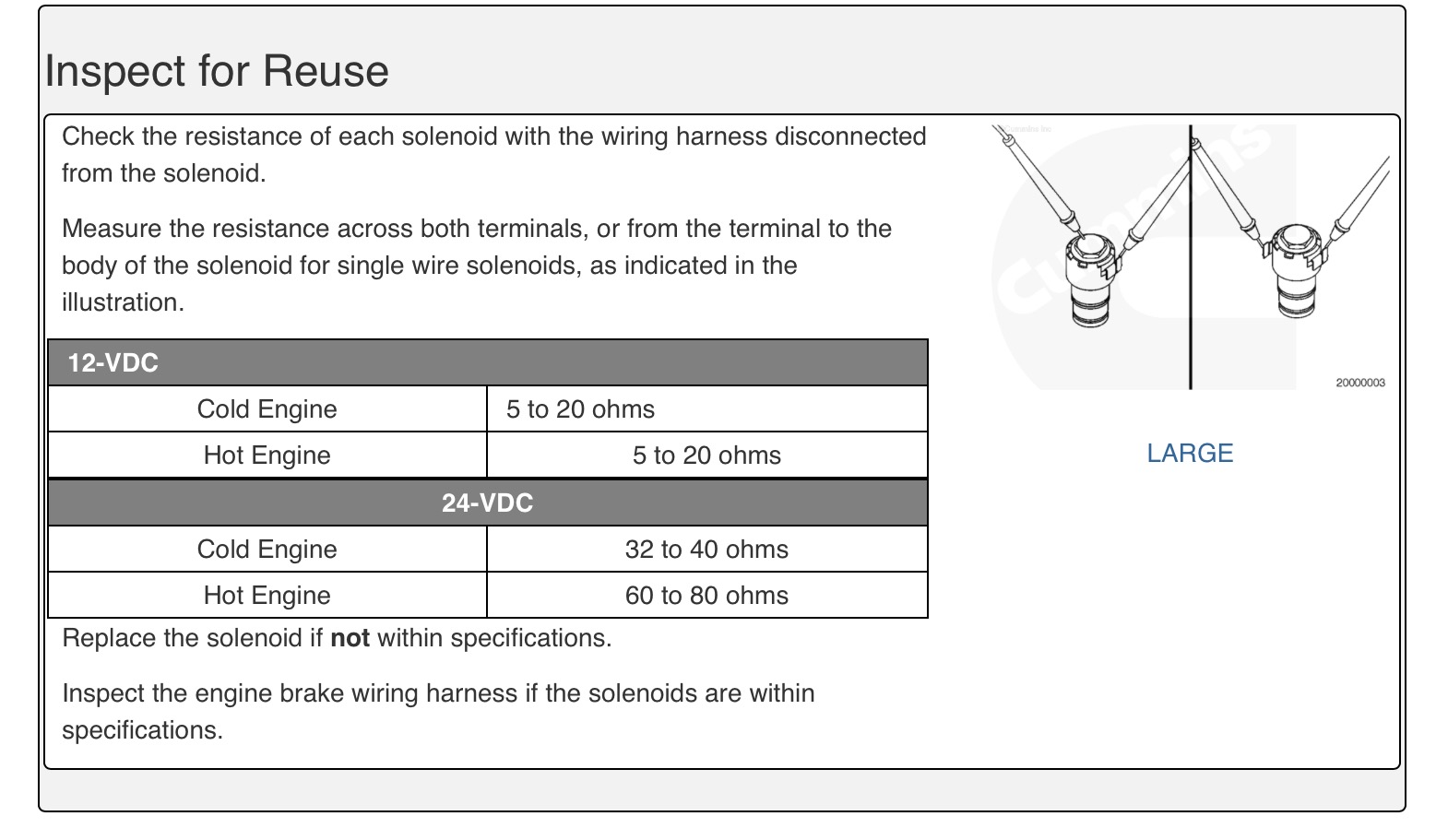

Sometimes my engine brake isn’t working right. It’s not working on all cylinders. I had read that it’s probably either one of the solenoids or the harness. How do I test the solenoids to see if it’s one of them? Is there anything else to look at that might be causing this issue? It doesn’t do it all the time. It does seem more frequent though. Thanks.

(02-23-2018 )aaronb Wrote:  ... How do I test the solenoids to see if it’s one of them?
./uploads/201802/post_2077_1519485528_caf012ad45ed4de636b4219e7b78ab7a.jpeg
The truck has 699,000 miles. The engine was rebuilt at 482,000. I'm not sure the reason for the rebuild. It still has the mandate. No bypass filter installed yet. I just bought the truck a couple months ago. I know the previous owner was running 20,000 mile oil changes. The overhead was just ran about 20,000 miles ago. I was driving the truck and bought from my boss. I'm planning on running the oil changes at 12,000 to 15,000 miles and adding a bypass filter. I'll try solenoid first and go from there. We're having freezing rain today and I don't have a shop to work in. Might be next weekend before I get a chance to check it out. Thanks.

I had just enough time to test the solenoid yesterday. One was at 11.1 and the other 11.3 ohms. I forgot to inspect the camshaft so I'll have to look at it when I have the cover back off. It looked ok when the overhead was done a couple months ago. The engine feels smooth except for the engine brake. I'd guess I'd notice a cam issue when under power as well.
