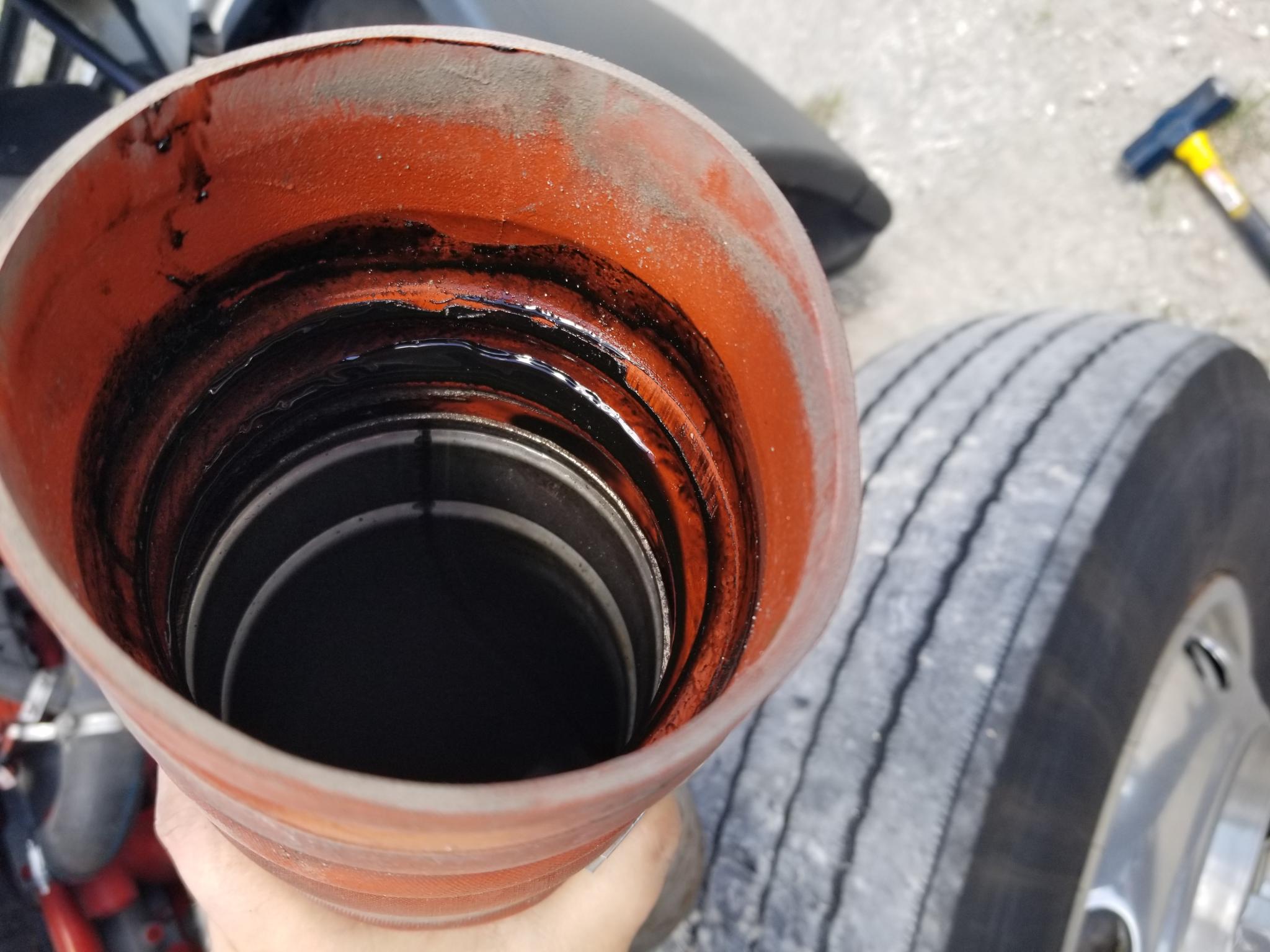

So today I took out line from turbo to air cooler and found oil in it. So my turbo seals are shot.

Before you plunge,
Wipe it really good. Plug in your Insite and check intake pressure at idle . If none , bump it few psi and drive the truck . Then check again for excess oil . If ok it will buy you some time to find something cheaper .

Should I clean-flush charge air cooler? How its ussually done? Or should I leave like that?
