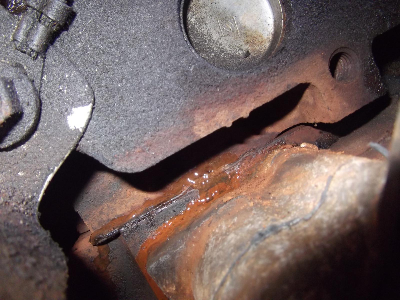

Not all coolant leaks look wet or have remnants of the coolant where it's at. Like a coolant leak external on a head gasket will oftentimes look like a rust Line running down the head on the exhaust side because the heat of the exhaust Burns off the coolant as it drips out.
Here's what they commonly look like if the heat around the leak is high enough to evaporate the coolant.

Yes I’m aware of those type of leaks. Sadly, doesn’t apply in my situation as those evaporated rust runs don’t exist. I wish it were that obvious though.
