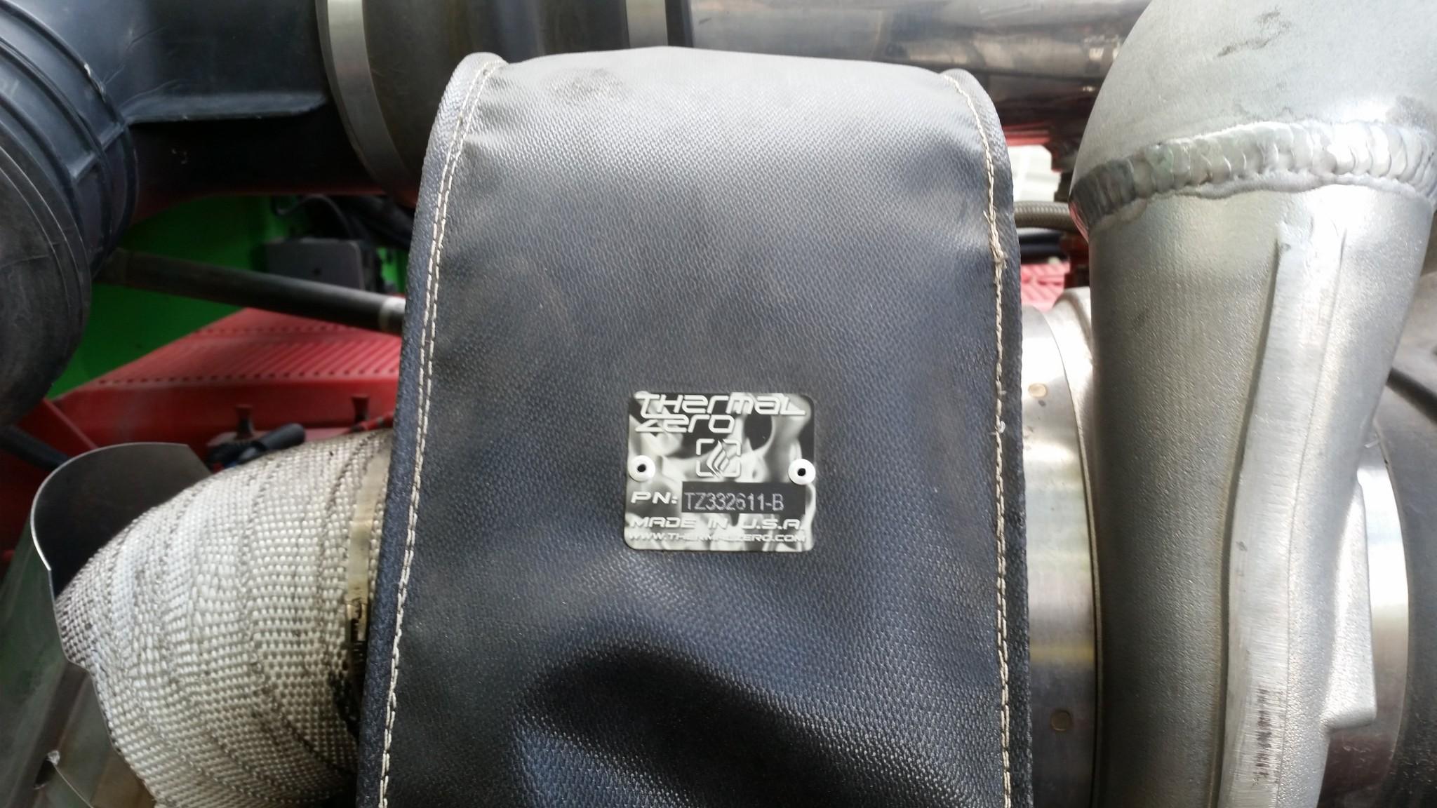

Exhaust wrap, yes, guys do see slight gains. turbo wrap,... unknown. I know of a couple guys running turbos with a decent sock but they keep an eye on their turbo temps too.
NOTE: These guys make them for the Holset but the part number shown in the pic above may not be correct.
