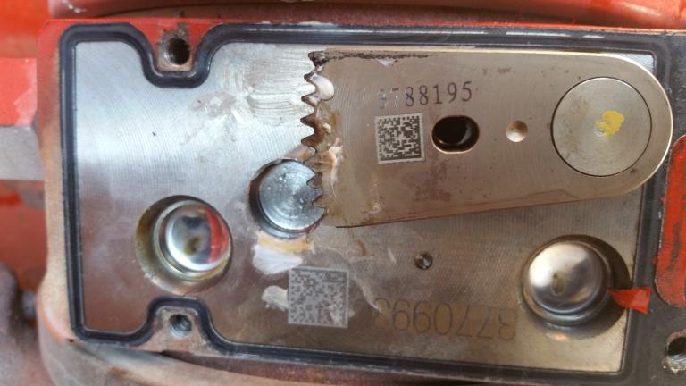

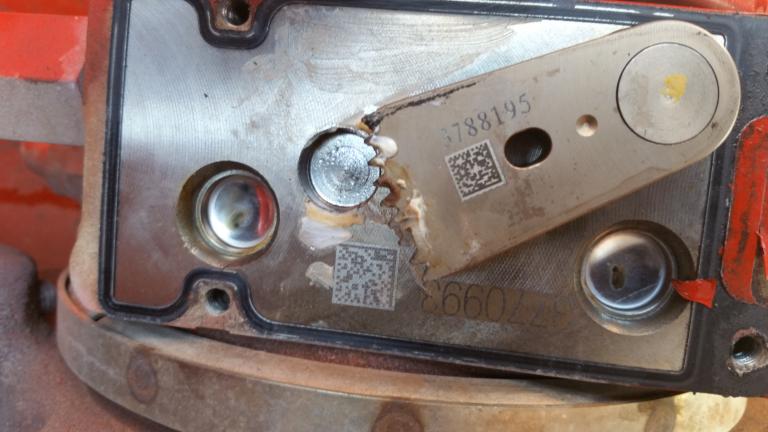

RE: Low boost, higher egt's ![]() ![]() When I move vg ring left it does not go past the half hole. You can look at the pictures. one picture all the way left another- all the way right. Does that suppose that vg ring stuck?? When I move it moves easy. User's Signature: Cascadia ISX15 CM2350 | |||
| 04-05-2016, (Subject: Low boost, higher egt's ) Post: #9 | |||
| RE: Low boost, higher egt's I was at cummins dealer today and they show me new turbo without actuator. I moved vg ring gear it moves same travel like mine turbo. So I guess that my turbo is good. But is diifferent design than in 'turbo inspection video' User's Signature: Cascadia ISX15 CM2350 | |||
