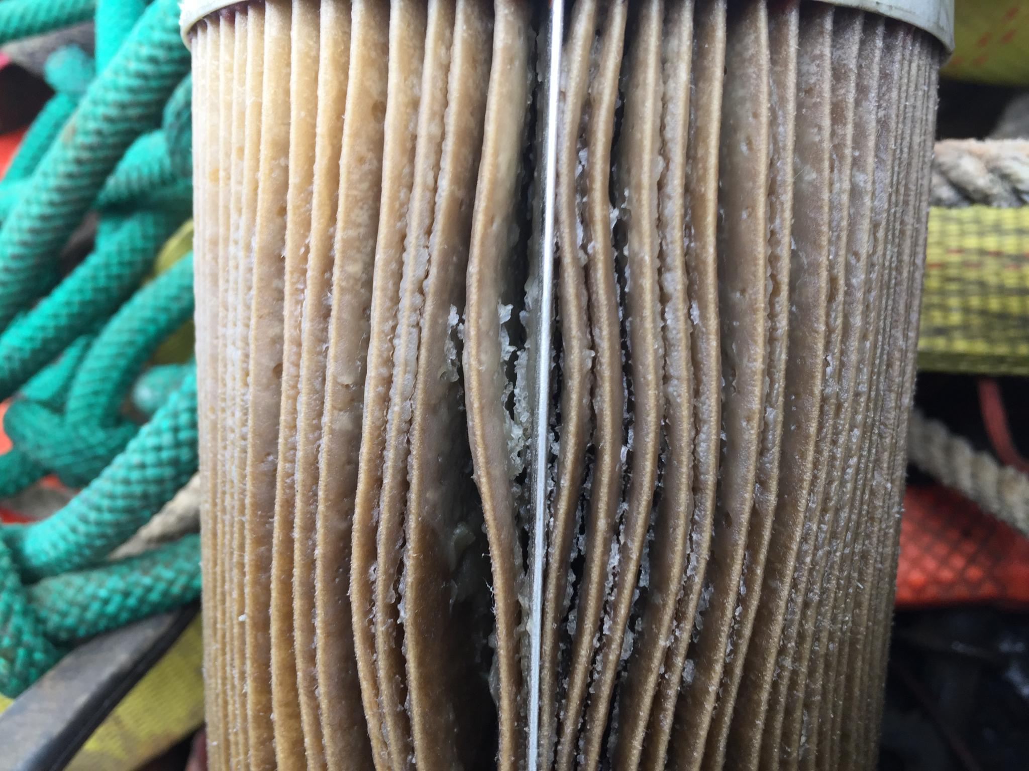

| Algea? This crap was in my primary filter, plugged it up, like looking into darkness in my fuel tank, no fuel moving but the lift pump is working. | |||

| RE: Algea? Looks an awful lot like ice to me | |||
| 03-19-2018, (Subject: Algea? ) Post: #3 | |||
| RE: Algea? Algea looks nothing like that. Algea is black, brown or dark green sludge. That filter is mighty clean looking. If it's ice than you probably have you fuel lines blocked too. You need to thaw it out and drain the lines and get the water out of the bottom of the tanks replace the filters. If its not water/ice than I'm at a loss. | |||
| 03-19-2018, (Subject: Algea? ) Post: #4 | |||
| RE: Algea? Algae is like black dirt, your filter would be black User's Signature: Cascadia ISX15 CM2350 | |||

| RE: Algea? Thanks for the replies, and to update, after getting towed in and draining the tanks etc turned out to be horribly bad fuel, plugged everything up though just the same. I'm calling the truckstop tomorrow that I filled up at 260 gallons, and see if they want to make this right. Not holding my breath. | |||

| RE: Algea? Looks like paraffin wax. If you still have this filter scrape sample on aluminum foil and try to heat it with the lighter. Is it melts ? Could be someone dumped in storage tank fry oil instead of antigel. http://energy-saving-technology.com/en/t...sel_p.html | |||
