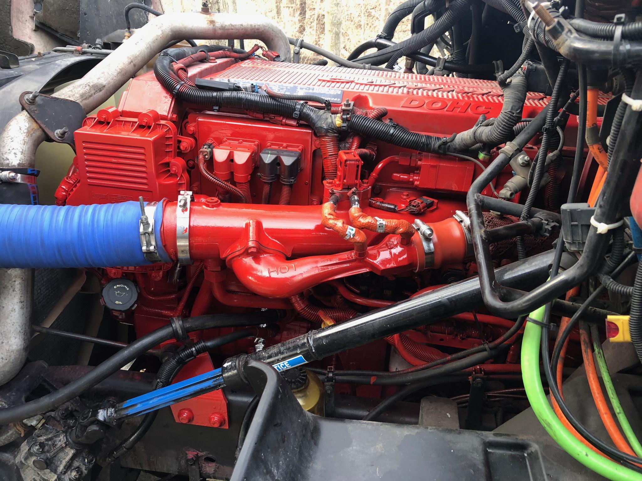

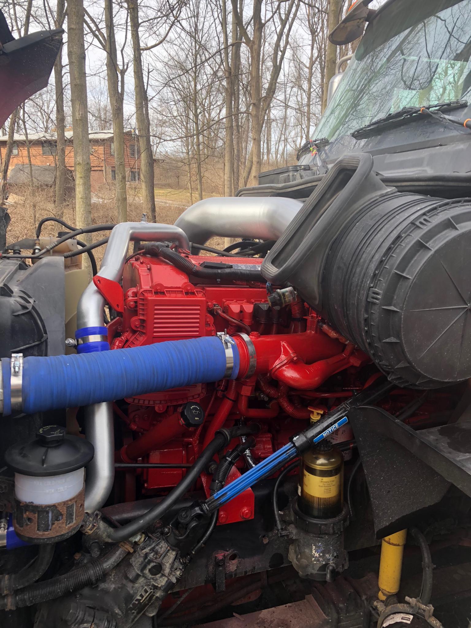

Sounds like my Parker Exotic Automation Store, exactly where I am heading in the morning. FleetPride had the correct hose, but only in 3/4". Parker will have it, just wish I would have found this on Thursday instead of 1700 on a Friday...
But, none the less, very happy so far at the work I have been able to accomplish. Yes, on three weeks down time, but I cleaned up and painted the entire driver side of the motor. The 20* temps did not help in the paint process, takes awhile for multiple coats of primer and paint to dry. I also removed all of the coolant hard lines and big intake from the air cleaner and painted all of those too. Replaced a few sensors, found things I know would have been skipped if taken to a shop and installed new heat shield wrap in a few key areas.
Now, I still have to replace the air dryer, that I am not looking forward to. But, it has stopped raining and snowing, and hopefully it will come off easily. And I can get my fat rear end under there. It is 21* out there right now... Jamie Davis Towing parka and bibs are going on for this one. ;-)

You forgot a bolt/clamp... Im sure you got it after the last picture though.
Nice looking job.
03-25-2018, (Subject: Coolant hose is not a "coolant" hose... )
RE: Coolant hose is not a "coolant" hose...
(03-25-2018 )Chamberpains Wrote:  You forgot a bolt/clamp... Im sure you got it after the last picture though.
Nice looking job.
Thank you sir! And the clamp, the one at the top hard coolant line, it was still in "paint", LOL! I just put her on, did some work on the other side too... Damn cold out there today. Just went over 30*, Spring is no longer Spring. Must be the global warming. ;-)
