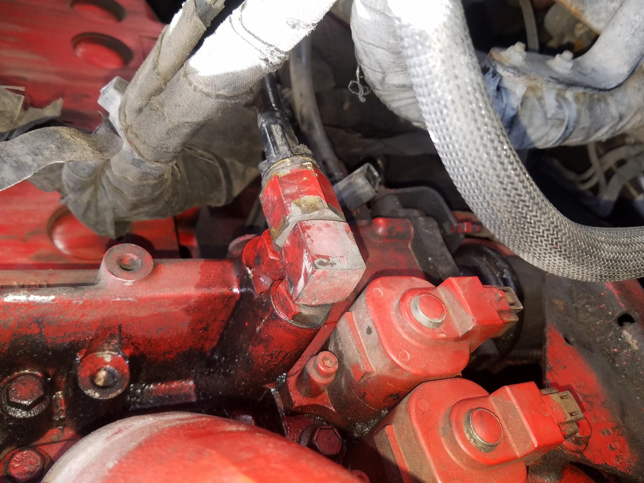

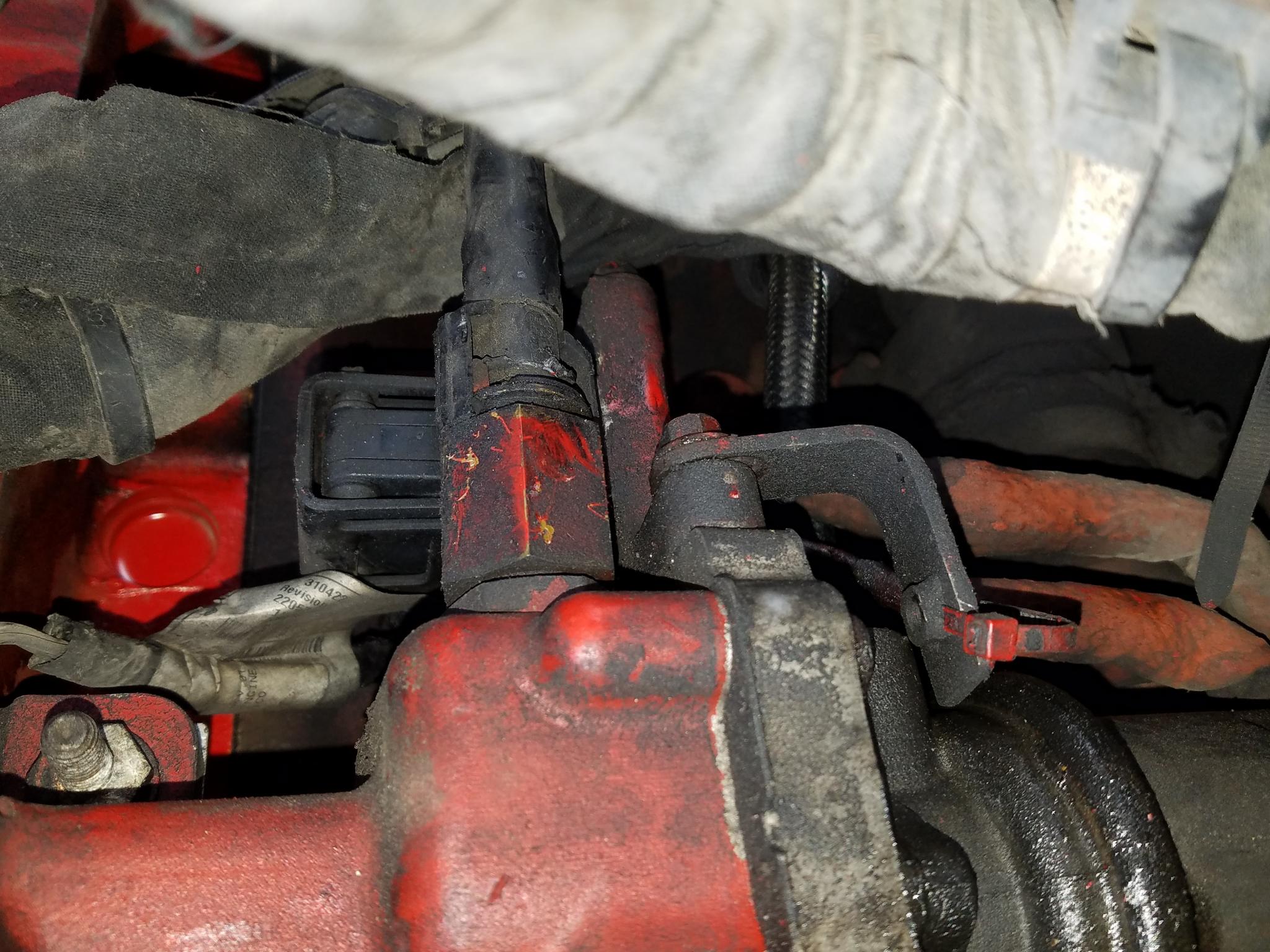

Hey guys I finally got all the gaskets n o'rings in today. I'm disconnecting all the sensors n lines right now. How do I disconnect these two lines? I fucked up on one of them.... help?...
