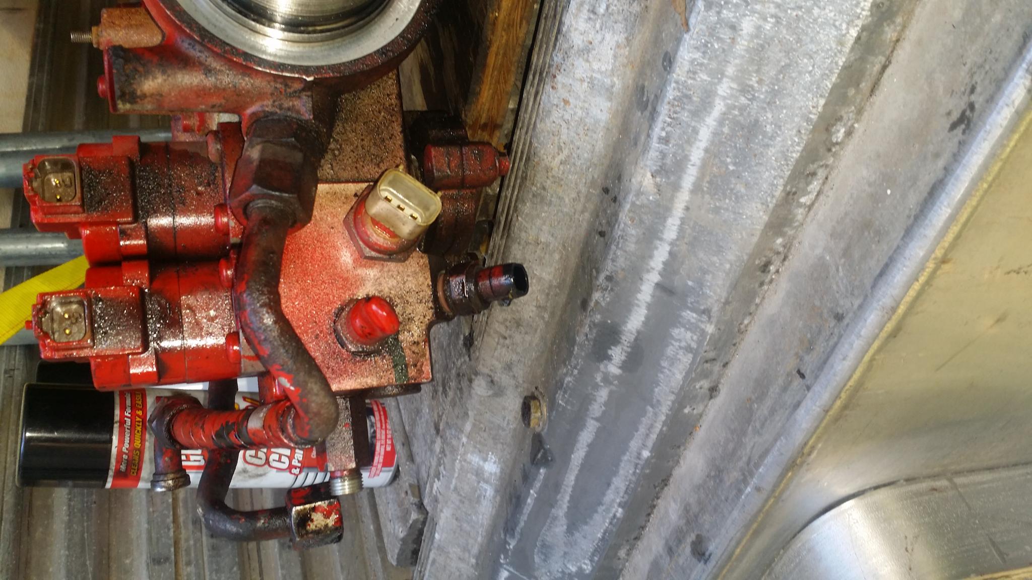

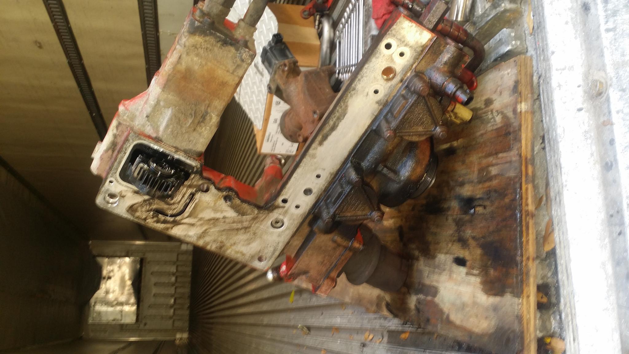

(04-04-2018 )Evotrucker Wrote:  Hey guys I finally got all the gaskets n o'rings in today. I'm disconnecting all the sensors n lines right now. How do I disconnect these two lines? I fucked up on one of them.... help?...
The lower one is supply and upper is return. That style of hose connector is unfamiliar to me. I assume you already tried a crescent wrench on the hex fittings?
Fyi if you're pulling the pump off, you'll want to replace the flange gasket between it and the head. its a large metal one you'll find when you remove it. #1 on Rawze's pic
Also 58 and 59.
58 is on the back on lower left in pic.
59 is plug inside above the compucheck fitting next to temp and pressure sensors. hand tight when reinstalling as its soft brass. second picture

Those black tabs get pushed inward. Not pryed outward, you have already learned they will snap, guaranteed. Push in on both sides and pull the line off. They are shitty Voss fittings. I just replaced all my fuel lines on my 06 international. $20 or more for each fuel line end. You can only get them at the dealership. I did a pretty good internet search and only found a couple on ebay. If you get them also pick up a cheap heat gun. You will need it to put the end in the line. Do not use a torch it will get to hot and be a pain. I learned the hard way on the road trying to fix a melted fuel line. Heat the line with the heat gun and they slide right in.
The plastic fitting is a voss fitting. Here is a reference with some info on how they go together etc. in a pdf file ...
http://rawze.com/forums/showthread.php?t...2#pid10472
