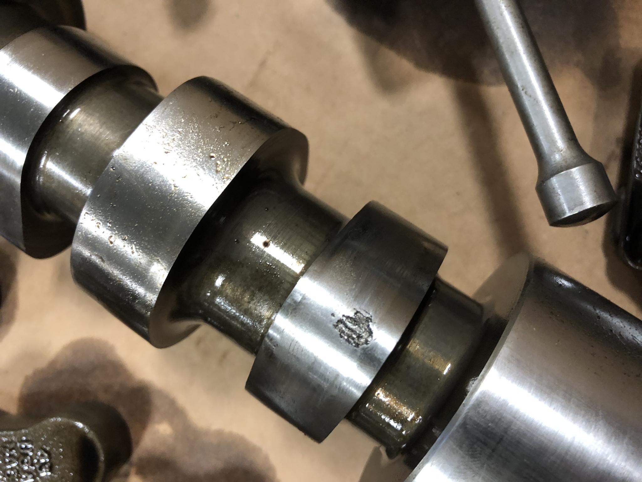

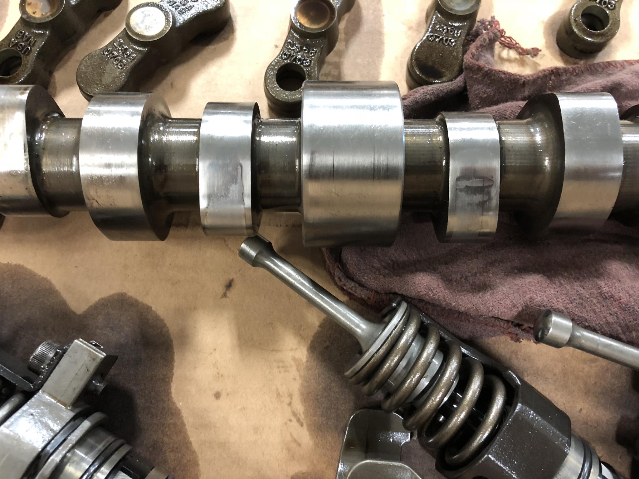

Inframe was done 60k ago after 1.3 million. I had some oil leaks and we tore it on down. Cams, bearings, showing excessive wear. Engine was still strong when we inframed it, I think I turned in better cores than what we paid for in return. From the start...engine idled rough, drank oil as well.
Upgraded to newer pistons, bought new style rods from Cummins, had counter bores cut, new holset turbo, new injectors from Cummins...PX style (which I’ve already sent off and one they claimed was putting air in the system and was pby never right). New pump...etc
Just wondering about shimming the pump. Trying to find the best cams available and putting a new head on from elite diesel, or having a reputable machine shop to redo my head. The company the kit came from tried to give us “another reman” head, but copper is showing in the used bearing that are still in it, and you can see where the old cam was drug out. Very disappointed in the rebuild, as the engine ran rough, used oil, less oil pressure, etc...old motor was just leaking oil, but ran like a sewing machine. It was all original, but well taken care of.

Thank you for the info...what are you running for break in oil? Are you going to run gear lube after that? Did you buy new cams, and if so is there a wider cam lobe option for the 570s? I’m also putting new actuators on as well. Any info is greatly appreciated.

Im running Rotella 15w40 Regular, My Cams were great after 2 million miles.Yes on Gear lube I sample every time thru Ams oil Program and gear lube shows up with high Molybendum and Love it
Great on Actuators I replaced mine 200k ago,I dont know about Cam options.
Also your going to need special tool for Piston ring Installation, with new APR ring ontop of liners.
Without tool impossible to install piston ,without Breaking a ring like we did,Oil ring.
Cummins 5299448, with new Monothern pistons on Cummins O/H kit.
New Liners come with Brass shims, I had Cummins come out to check Counterbores just for Insurance All good.
I'll be running Rotella 15w40 with Gear oil permanently.
