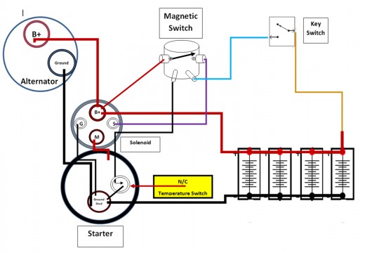

You say the symptom is a flat battery which leads me to believe you hit the key and nothing happens or you just get a click. If so I'm fairly certain its the temperature limiting switch in the starter.
Mine does not have the temp switch so I've never experienced it but I know ppl who have. And in your application I can almost guarantee you that engine is making that starter very hot.
./uploads/201804/post_1037_1522690871_99d319f52f51f5d36cdade61a0d55aa9.jpg
You should be able to bypass it.
 Thanks given by: Rawze , Hammerhead
