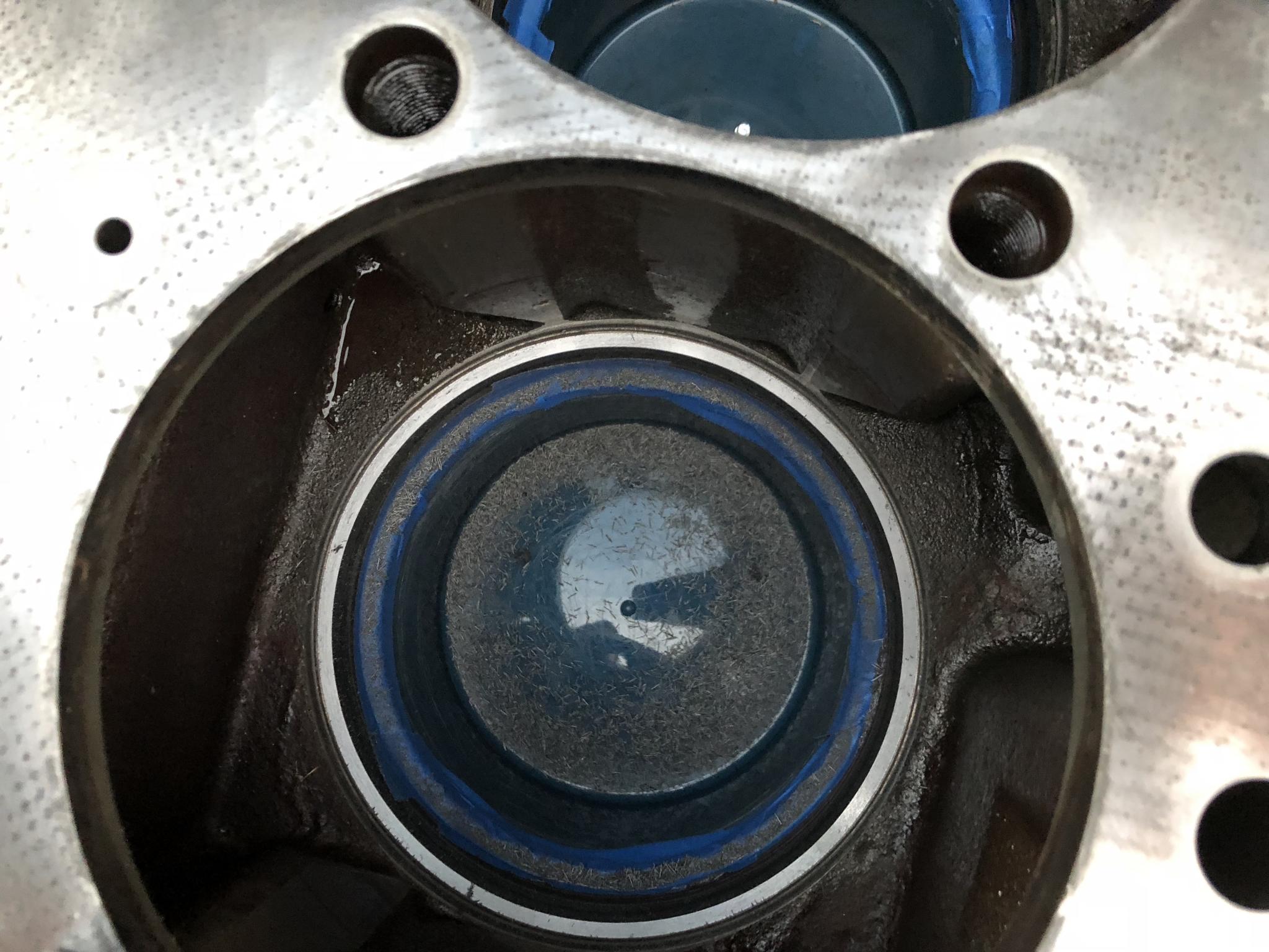

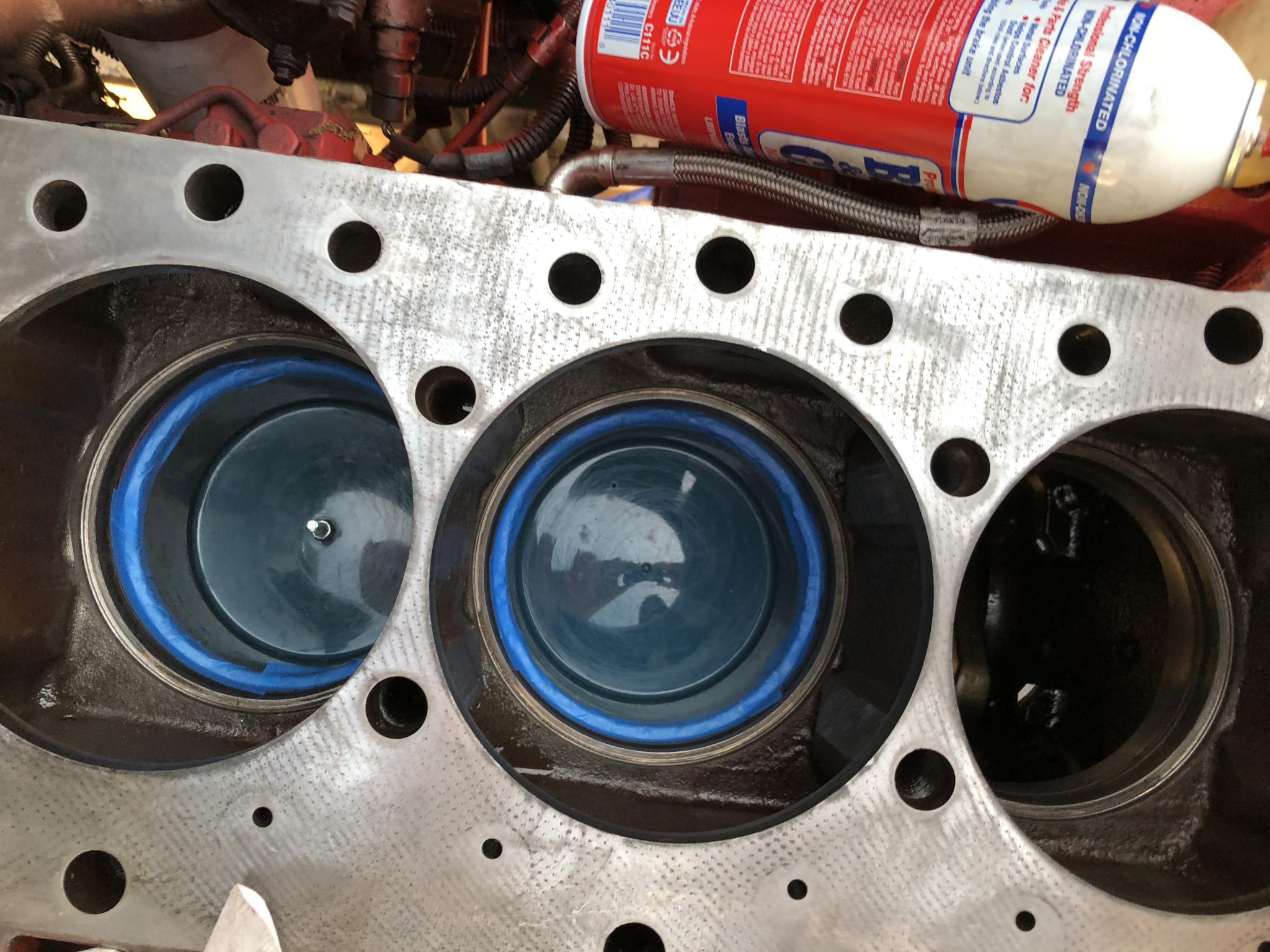

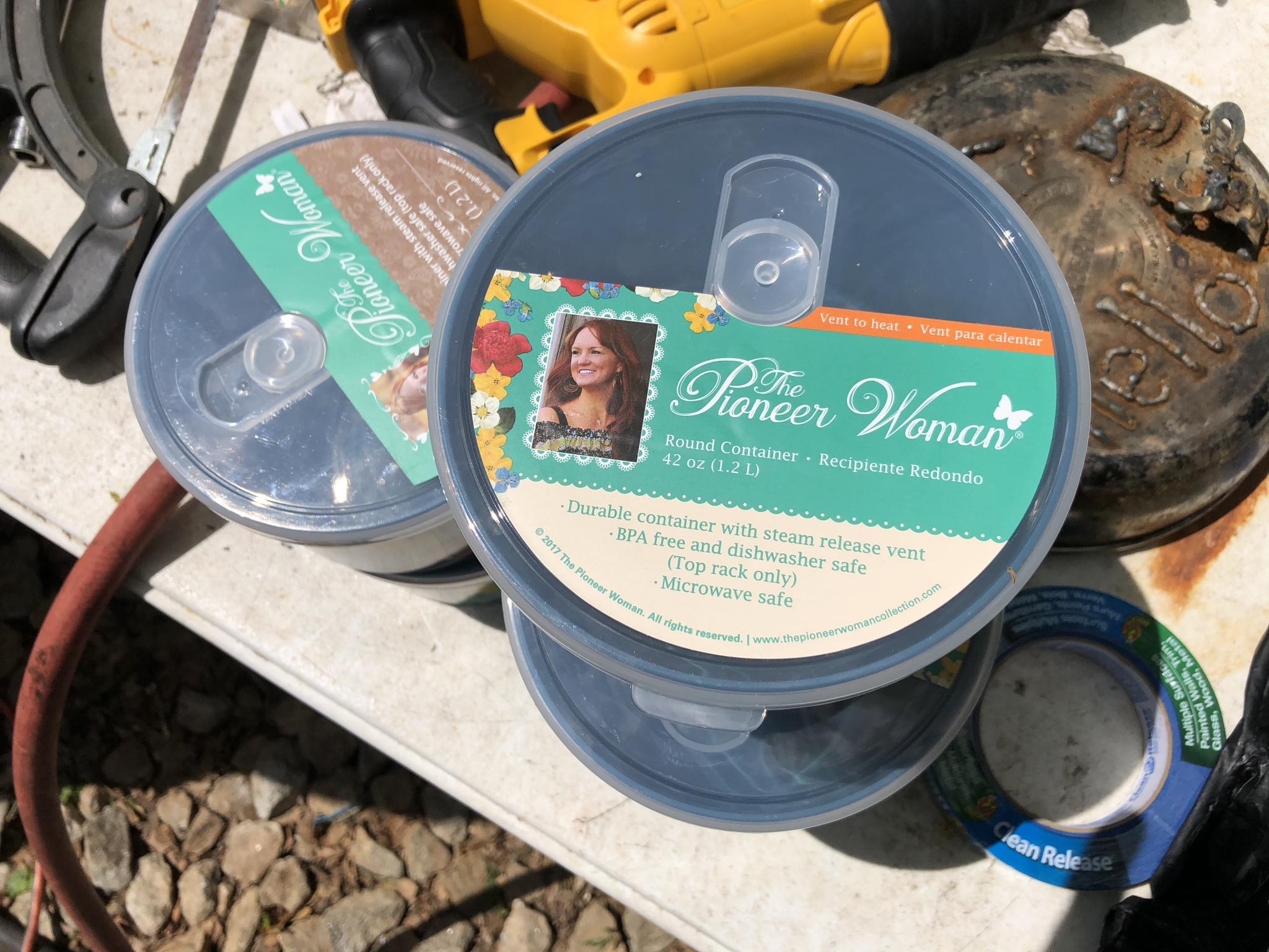

Ok, we started with the block, stone and oil to get her nice and smooth like a baby's bottom. My first back ache of the day... Got that done, then we started cutting the block for the liners. But first, Rawze went in the kitchen and brought out a plastic microwaveable bowl. We only had one, so his wife was gracious enough to run up to Walmart to get more. They were in stock, we got lucky! Enough to do all six liners! Do what you ask...?
He played around with it for a few minutes, grabbed a hacksaw and started cutting around the edge, removing around 1/2" of the top of the bowl, just a hair ABOVE the lower lip of the bowl. You need that lip. Then hit it with a heat gun and forced one of the liner rings from the top of the block into the bowl. That liner ring STRETCHED the bowl to the proper diameter, very crucial to making this all work. He then drilled a hole in the bottom of the bowl and inserted a bolt with a washer and nut, so as to make a small handle to reach in the bowl to lift it up by the bolt. The hacksaw worked, but Rawze broke out the Dremel tool and sped up the process. There was also some sanding involved, and the darn things just work. I would guess and say these bowls are around 5 inches deep, just so you know if you go to Walmart to pick up some for yourself if you have a need for these.
Here is the finished product, saving the motor from block shavings. Very cool! Cummins wants $500 ea for these cups. I think they were around $4 ea at Walmart. ;-)
The liners in my block are the 150mm variety, and these bowls fit perfectly. But, we still used blue painters tape to seal up around the edges so none of the shavings got away. We used a small Shop-Vac to suck the metal shavings out of the bowl.

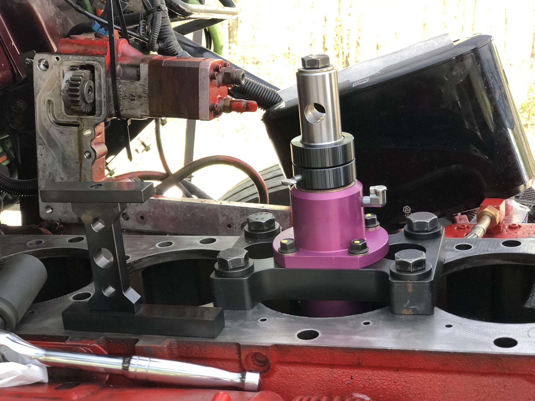

Here we are machining the block... Well, I guess we were taking a break... ;-)

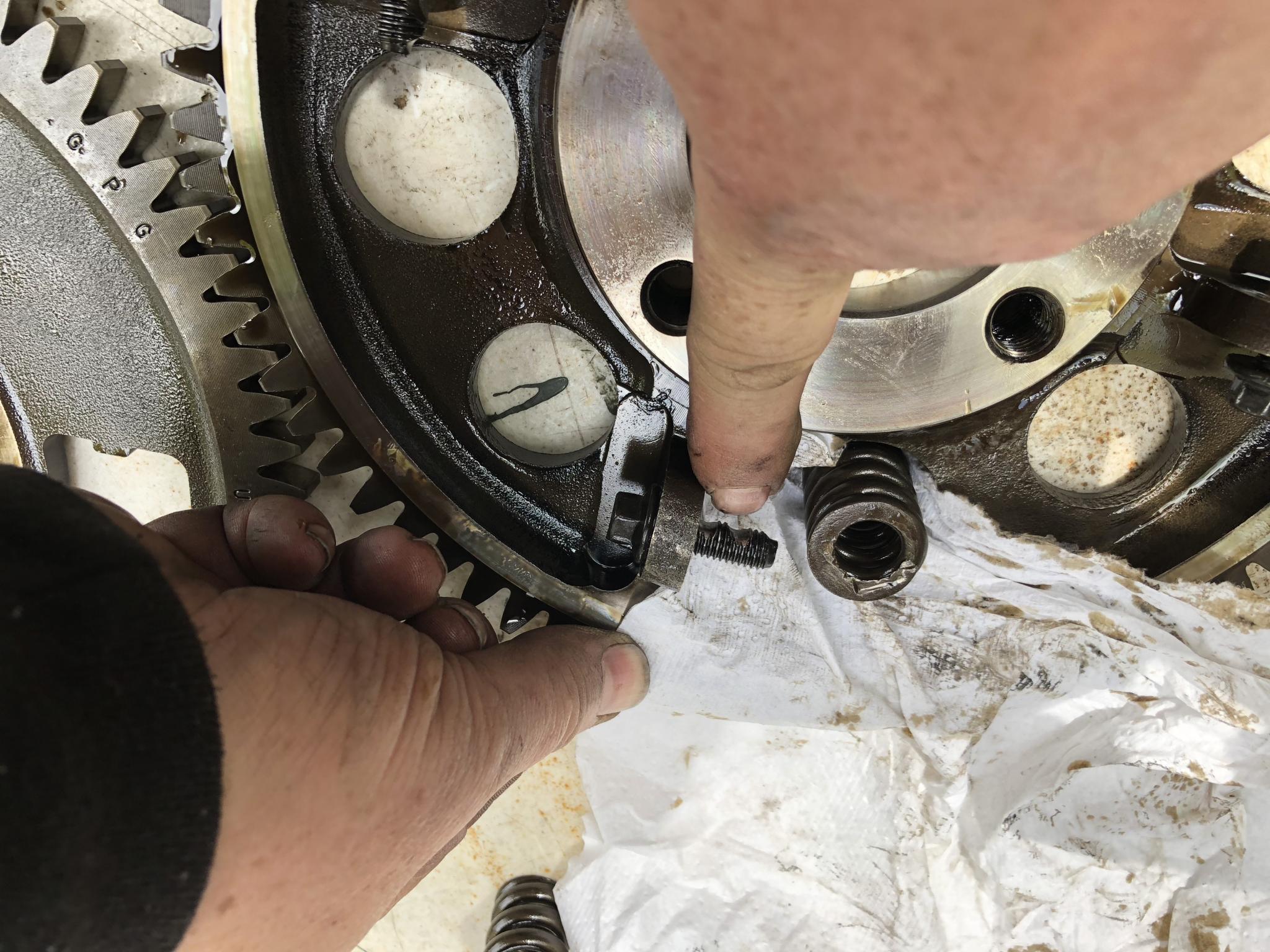

And here is something very serious we found the when tearing everything down. This is the Injector gear, under the top front cover. It is a split gear with tensioner springs and adjustable bolts. This was just thrown on, no tension was applied, the springs were just rattling around in there and this gear was ready to literally blow apart. Also, there was no Loc-Tite on the cam to hold this gear in place, it popped right off with little effort. I was driving on some serious borrowed time. This would have taken out the entire motor. Look at the spring and bolt, how chewed up they are. There are four tensioner springs with four bolts, they all looked like this. Failure was imminent. Mr Hagg was here when we shot these photos, he is ordering a new gear for me. He is looking out for me and really helping in this effort, very very good guy, no a GREAT GUY!

A side note to the above update, I am keeping the dealer in the loop as to what we have found so far. I just wrote him a email with photos of the injector cam gear and the other thing we found, which was the rod bearings are pretty tore up for so few actual miles. Mr Hagg was here today and took a look at the bearings and that gear. The bearings to his thinking were installed dirty, and he doubted that any of the lubricant or whatever that stuff is called that you apply to the back side of the bearing was used. We also found some metal shavings in the block, I am suspecting the main bearings. I will post some photos of those rod bearings tomorrow.

'' Microwaveable bowls from walmart '', lol. But i shouldnt laugh at that. I found small bowls that people buy for thier small dogs to eat out of in Princess Auto. They are plastic with a rubber edge at the bottom which when you turn upside down the fit nice and tight with a perfect seal inside the liner bore. Works like a charm. Paid 4.50 each for them. Buy hey we all get creative when the '' correct '' plugs are 575 from cummins.

Can you elaborate on the oil and stone on the block? I'm assuming that is to prep the deck for the head gasket and to make sure it's flat. What grit stone are you using for the proper RA on the deck and where in the world did you get a stone that big and flat?

That stone is just a small flat one, say 3.5-4" long, 1/4" thick, 1.5 inches wide. Looks to be regular cutting oil that Rawze uses for the first round, and then for finishing a mix of acetone and transmission fluid. As far as the stone grit, I am going to say around 800 or there about.
