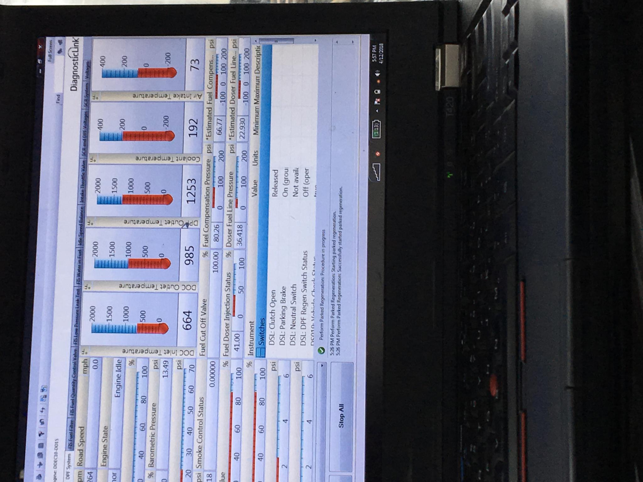

I had a 3556 fmi 18 (Means doc outlet not to temperature)and then i hooked up the computer to check Doc temperature and fuel line pressure to doser. I have attached the picture but the best temperature my Doc outlet went was 994 and yet i am still clueless why is my truck throwing a emission light and a code if regen is getting done. Any ideas? I think my metering unit and doser fuel line looks good too. I also changed the injector to see if it makes a difference.

Update for anyone who runs into same problem. After all that crap, i got like 12 dieffrent codes a week later like 3209 spn 4 ,3609, 3509 fail 4 and many more. I diagnosed the bad connection to ACM as per the code but turns out the connection was good since i checked continuity in the pins. In the end, i figured out my ACM was acting up!!! I had 5 V sometimes in the pins and after few seconds when i would test it again THERE WAS NOTHING!
I think it is just a bad ACM since I was getting codes every other day and sometimes they would dissapper themselves. Changing it tommorow and will update if it worked out!
