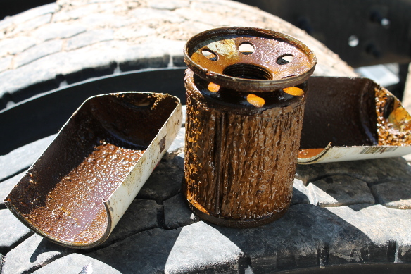

When I was draining my coolant I saw some sediment in the coolant lines. So I cut coolant filter apart and its after 45,000miles. Cummins quickserve says change the coolant filter every 50,000miles. I wont go that many miles with it anymore. It needs to be replaced atleast every 20000miles othervise coolant will bypass it when its full.
04-08-2016, (Subject: coolant filter cut apart )
RE: coolant filter cut apart
What engine is this for and do you happen to have the part number?
CM871 is WF1241-03?

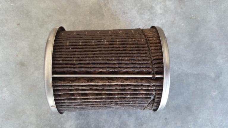

It looks better than this one ---
./uploads/201604/post_2_1460111360_9ecb17f2794840fa3b1c72cd7290f027.jpg
This is one that had likely never been changed. Found it on a truck that had 600k miles on it.
What you think the rest of the engine looked like eh? --- and to think this guy was being picky about what kind of oil he was using, asking all kinds of questions about making his engine last longer... lol
Guess he never thought about making sure his coolant system was in good shape too.
The point of all this is --- CHANGE YOUR COOLANT FILTER EVERY 50,000 MILES OR SO!
I haven't had a problem with that interval. If your getting clogging at 20,000 miles, there is something wrong. Likely your using the wrong coolant filter. ISX engines need a WF2127 --- NOT a WF2126. There is a BIG DIFFERENCE, because the 2126 is full of dried SCA additive when you put it on and if you keep using them, they will gum up your system and the coolant filter will keep getting clogged up.
I recommend people use the WF2127 filters ONLY! and if their coolant needs SCA or nitrates,.. TEST YOUR COOLANT YOURSELF WITH TEST STRIPS REGULARLY ADD IT YOURSELF!
--- And if you use RED COOLANT --- GUESS WHAT -- YOU DON'T NEED SCA ADDITIVES AT ALL! --- The WF2127 filter IS THE ONLY FILTER you should be running to avoid gumming up the system.

Every other oil change on mine, and you have to watch them that they get the correct filter on if you are running the Red Coolant like Rawze stated! I had one shop that tried to put an additive laced filter on mine, the only reason I caught it is when they told me the price! It was twice as much+ $$$ as the WF2127 @ $80! I try to use the same Speedco, but sometimes it is not possible. But one thing I do do, is hover around the truck and make sure they do what they are supposed to do. Gotta keep an eye on these guys.
