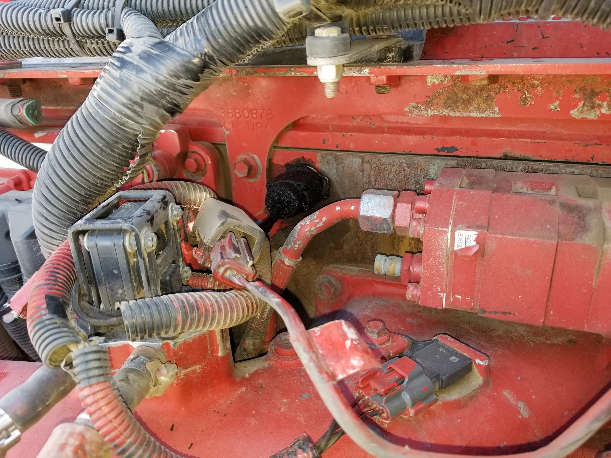

I own a 09 KW T660 with ISX 871. I have this part that is always surrounded by oil. It doesn't leak heavily. I don't know what that part's name is or what its function is. Its behind the Delta-P sensor. Any help on how can it be fixed?

That is the engine brake harness. Crank case pressure causes it.
replace your crank case filter, drill it out, or buy a maint. free one.
http://rawze.com/forums/showthread.php?t...376#pid376
 Thanks given by: mbatransport , RTRUCKING48 , Old Driver

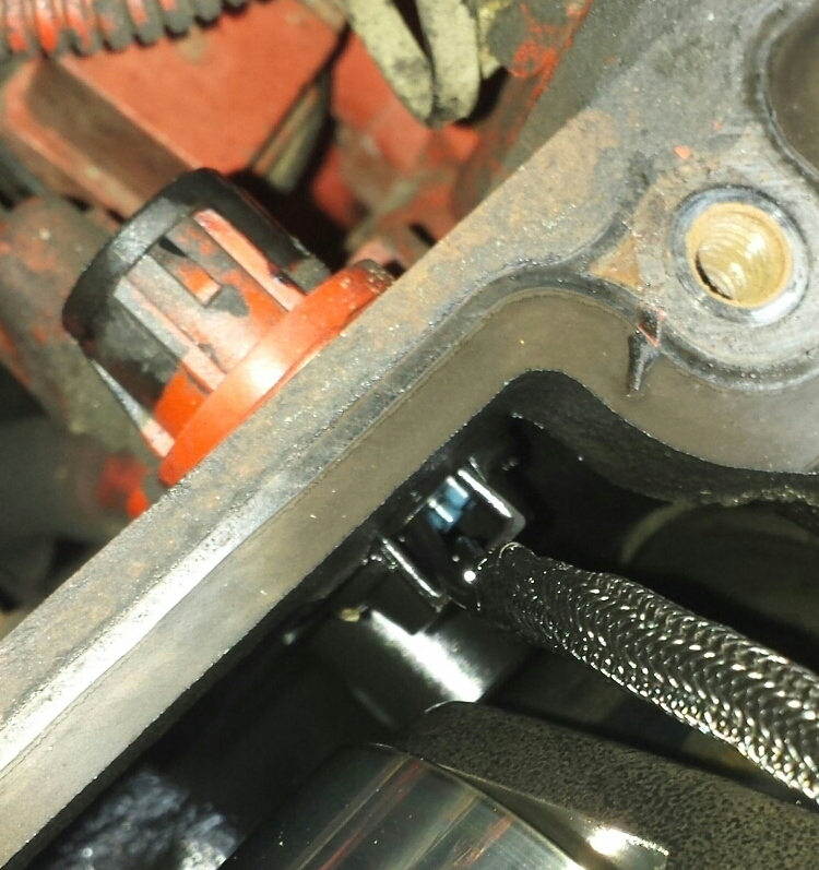

Been there done that. Next time you adjust the valves you can pull it out, clean with some electronics cleaner and pack the square funnel shape with sealant. (This is a "before" image)
