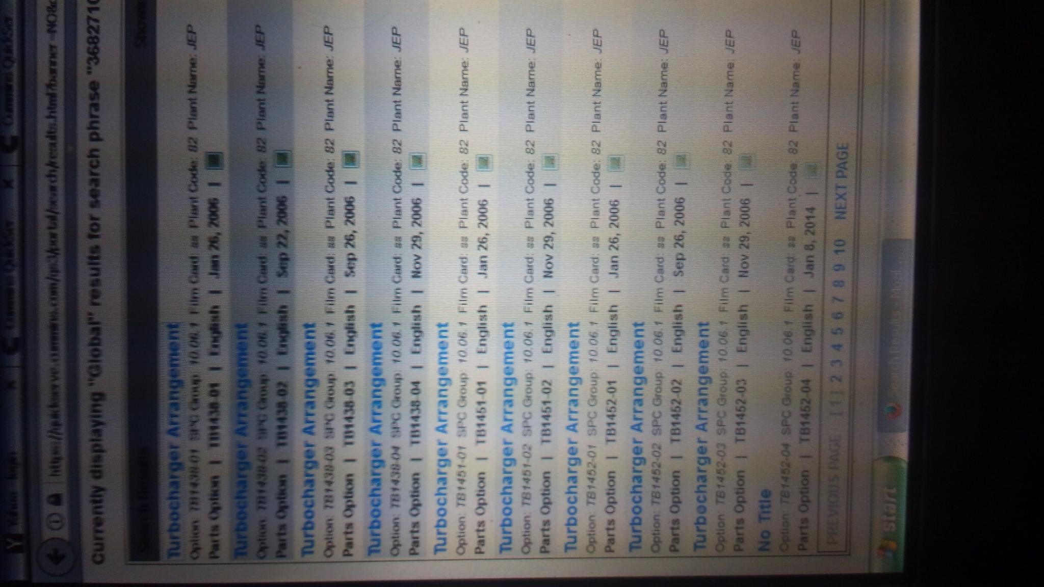

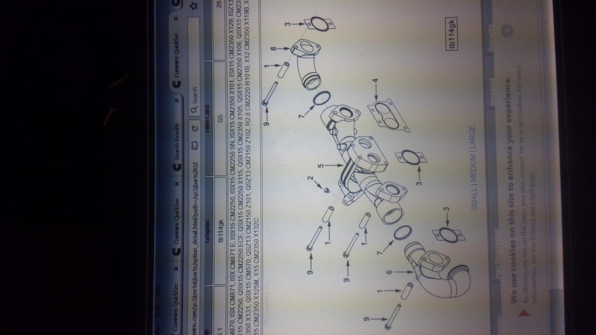

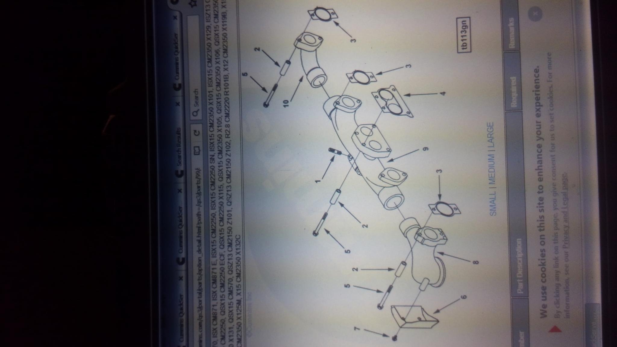

Here a question for that gasket. I searches my cm870 ESN 79115692. I came up with 10 pages of exhaust manifolds well over 100 results on quickserve. All of them are for different turbo arrangements. By the time I went down through most of them, I saw that 3683940 # for that gasket. But those manifolds look nothing like the one on my 06 International 9400i. By the time I got 40 or so clicks in I started to see my manifold and it doesn't show that gasket. 1st off how do find the specific turbo arrangement # for the engine and 2nd why doesn't mine show a gasket?
Here is the manifold shown in most pics. The gasket is #7
Notice the 10 pages of results. All with different turbo arrangements.
I finally started to see mine on page 4 but it was not pulled apart. On page 10 I found the same style pulled apart. Notice no gasket...

(08-24-2018 )Chamberpains Wrote:  (snip)...2nd why doesn't mine show a gasket?

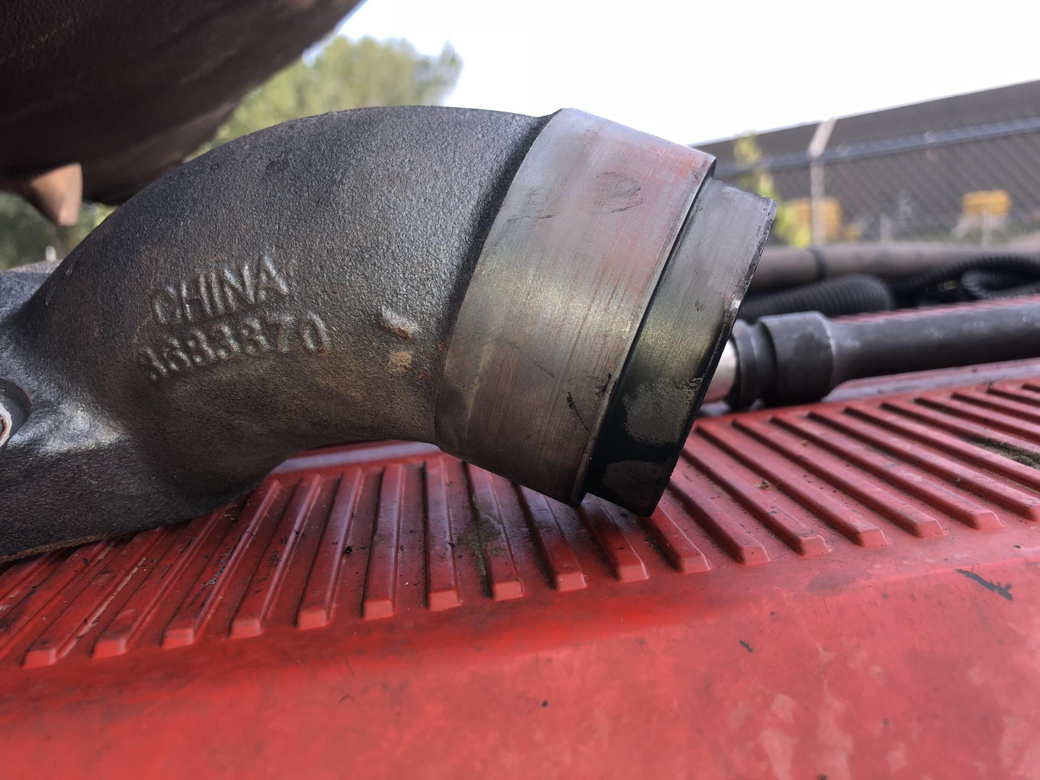

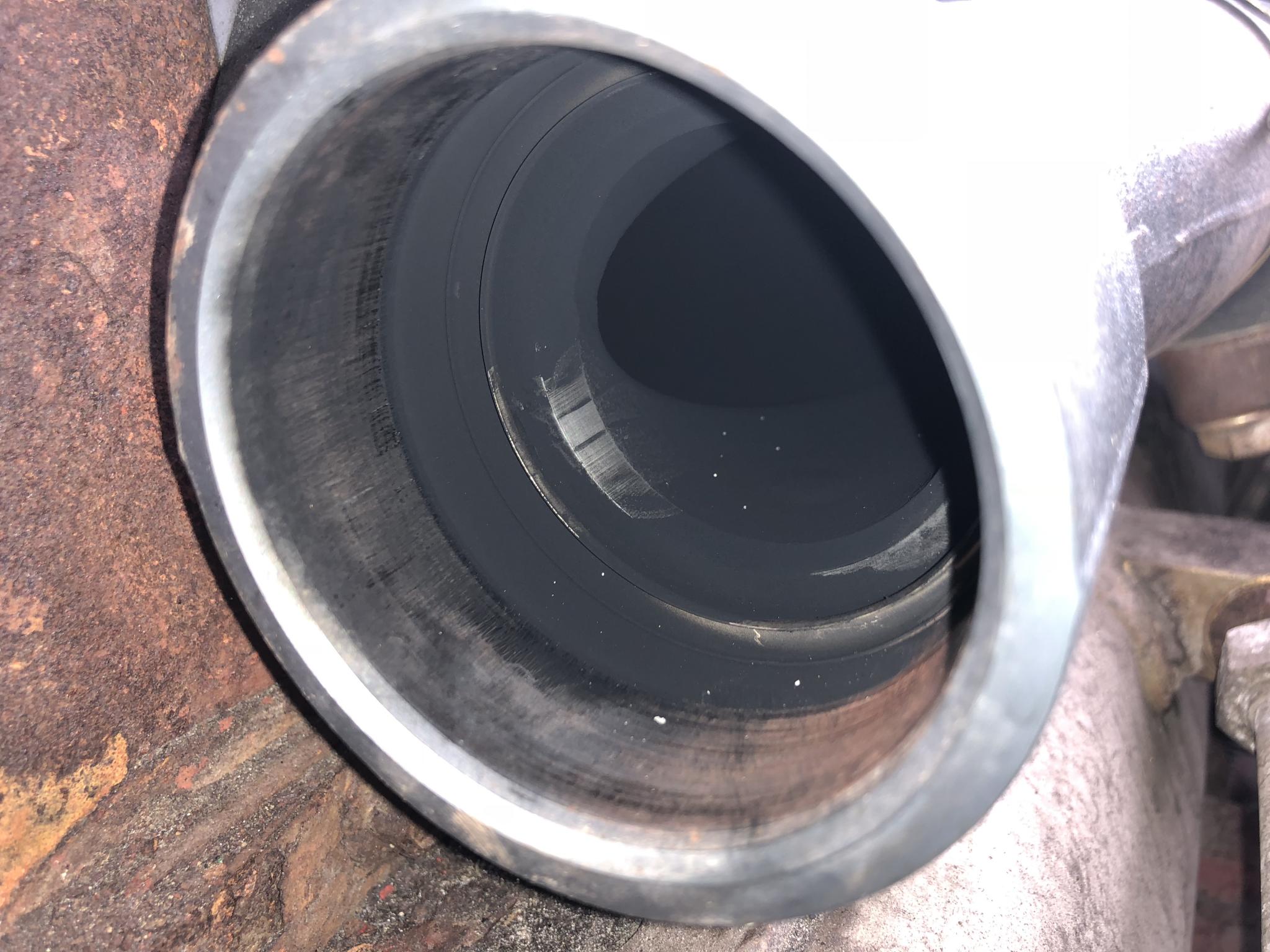

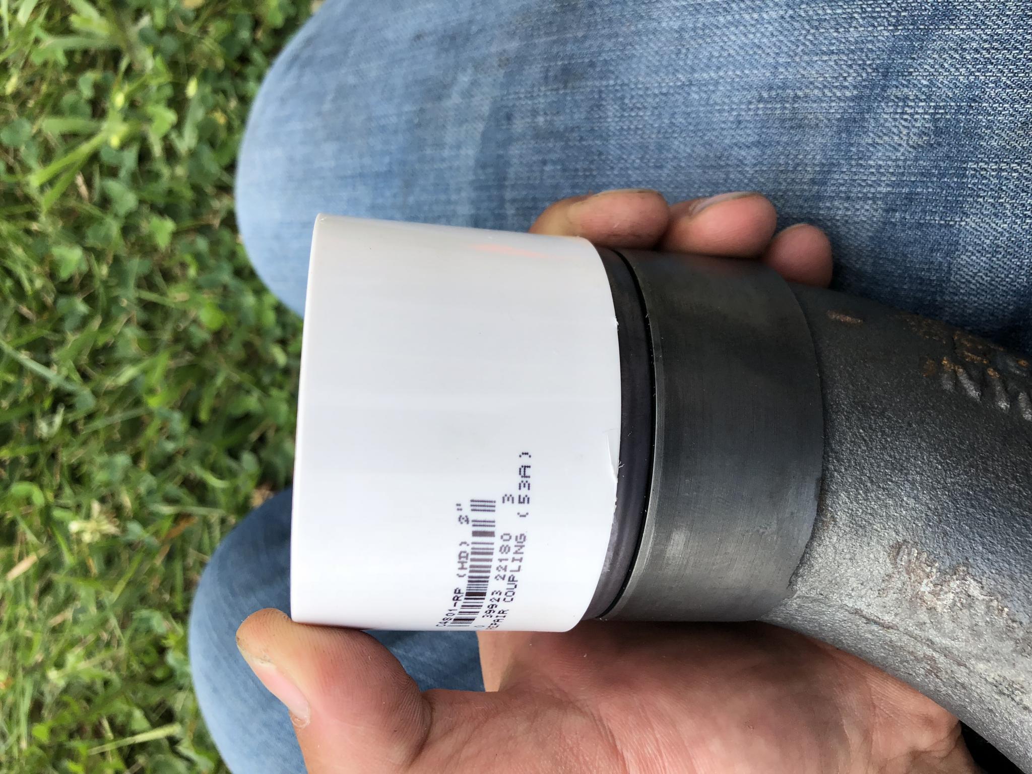

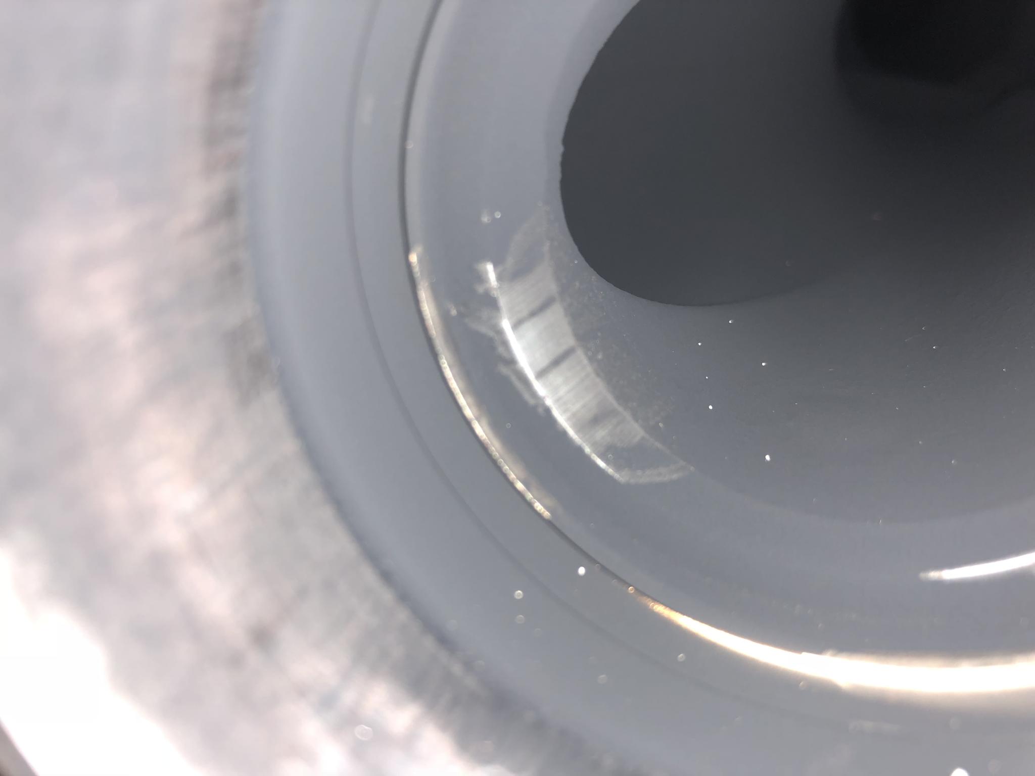

Ok, a little update here. I had a little time so i took of the rear section of the exhaust manifold assembly. Like everyone on here said, the joint seal was installed backwards. To top it off they slid the seal into the female section all the way towards the front of the assembly. This caused this gasket to completly not even make contact with the male section of the exhaust manifold.
Once i got the old one out of their I couldn’t believe that a cummins certified shop would be so ignorant on something so simple.

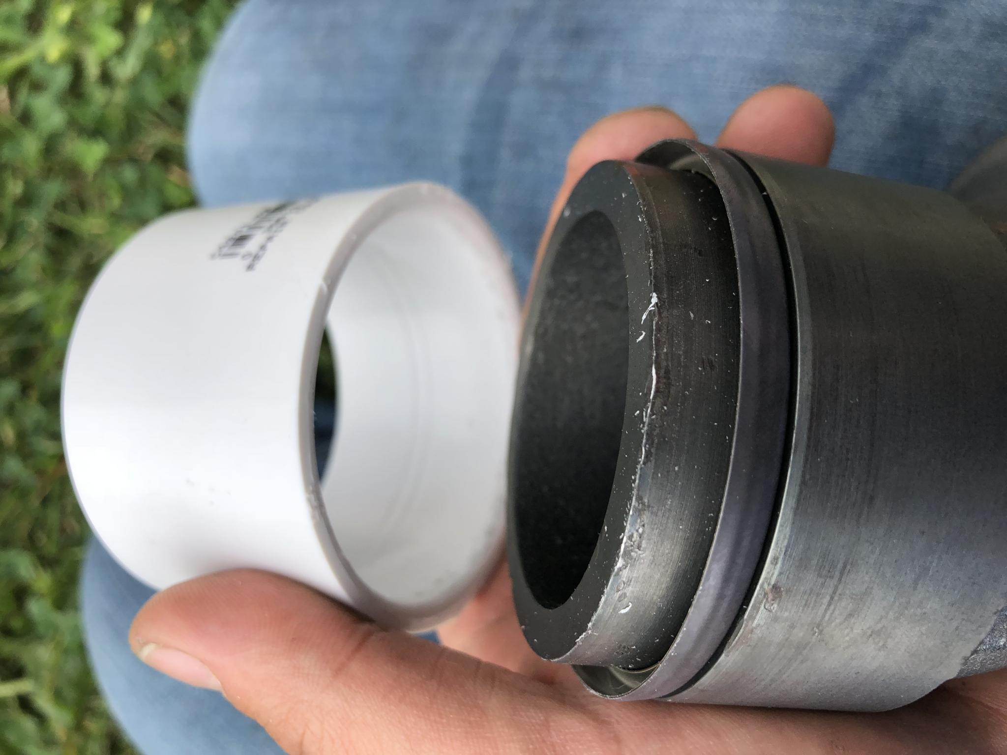

I did not buy the cummins tool to do this job. I ran over to home depot, got myself a 2 inch plastic pipe connector for 2 dollars and pressed the sesl in perfectly. Once I installed that rear section i had no leaks at all. Im going to assume the front section has the same problem. I also checked the bolts on the manifold and they where under torqued.
