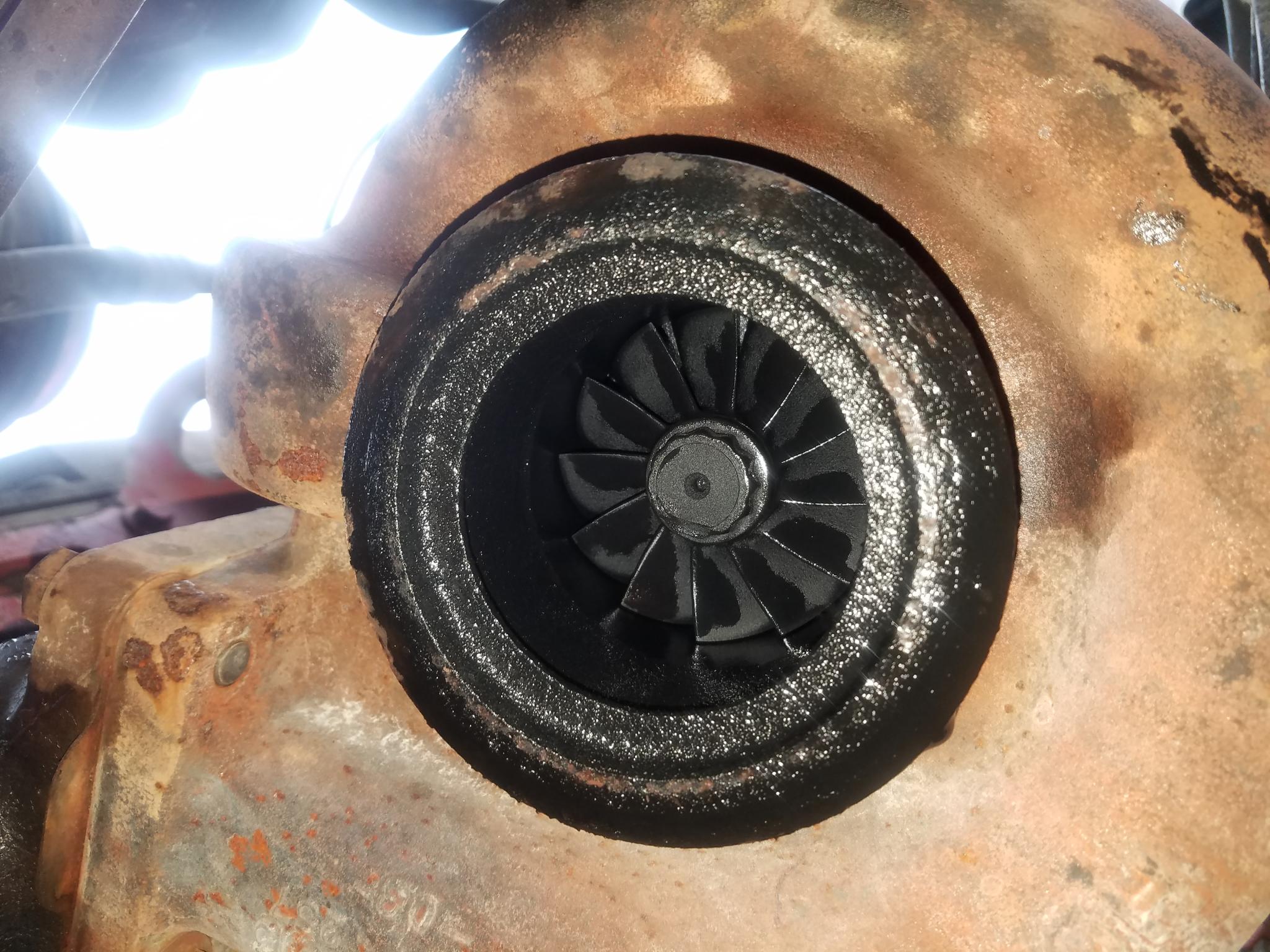

This is the back of the turbo, the front of the turbo is pretty clean. I didn't see a drop of oil around it or in the intake. Both of the front and back blades are intact. Nothing was torn apart just oil gushed out from the back end of the turbo. It's raining again... I did manage to do more work then I figured today. This is how far I got.
The exhaust pipes were just covered in oil.
Okay so..... I still have that Baldwin oil filter on the engine. I was going to replace that and do another oil change and fuel filter/water separator filter. Could that Baldwin filter be the reason for my misery?. I also noticed that oil filter housing is connected to turbo and connected to the oil pan.... is something blocking the oil maybe in the oil pan? I might have to take that sucker of to double make sure.
Any ways guys thanks n keep trucking.

Like I said.... you need a new turbo.you can't fix the turbo yourself.What Rawze was referring to doesn't apply to your situation.
