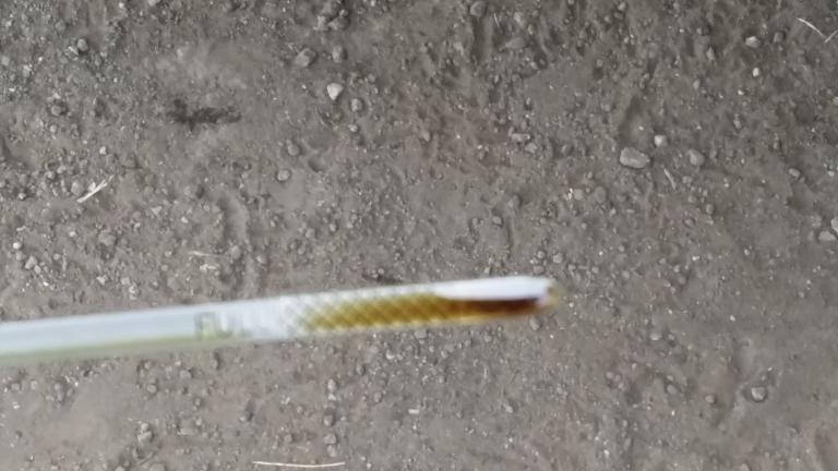

Your oil should not be black after removal of mandate. It will turn brown like Jack Daniels after about 15,000 miles.
./uploads/201604/post_132_1460178427_6238839cda7d03706697795dd511ad6e.jpg
