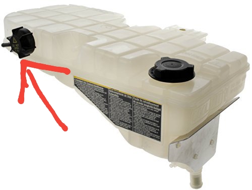

That's because you used a rad cap but did you block the pressure relief cap? Sounds to me like the pressure relief cap was doing it's job and relieving the pressure at 12psi.
Your wasting your money on a water pump, I promise you. The water pump is leaking because the excessive pressure blew out the seals..... I literally just wen through this with my Pete. 12psi is higher than your cooling system should run.
./uploads/201805/post_1367_1525680259_77f979054735eec9c6bfd3760fa73a84.jpg
Put a hose from this pressure relief into a bottle of coolant and you should see bubbles when it warms up and pressures up. I bet when your pressure gauge is up at 12psi, you'll see bubbles in your bottle like in my video here...
